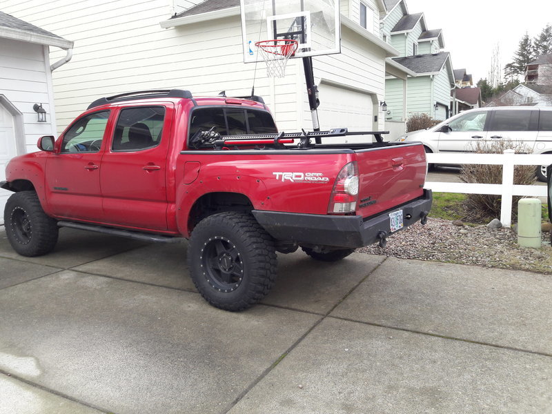

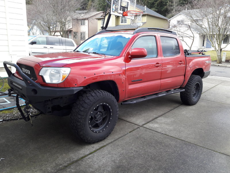

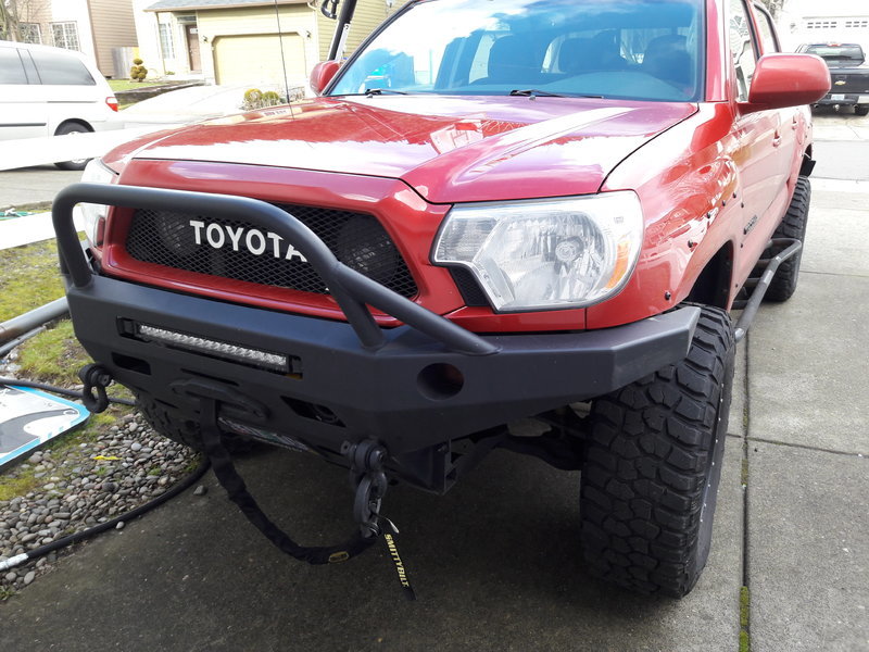

    20170226_142130.jpg 20170226_142145.jpg 20170226_142120.jpg Great job. Looks awesome just did mine 12 taco will post as soon as I figure out how to me not so computer savy
