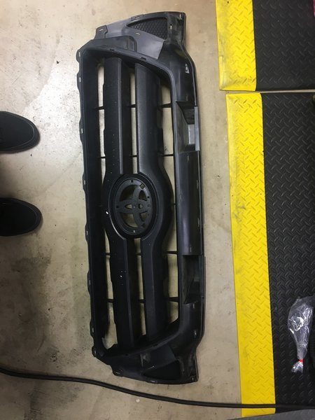

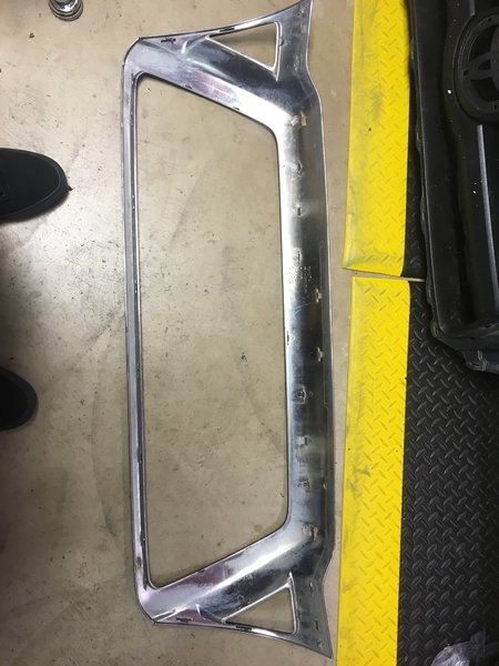

    I was able to obtain a broken grill from a wreck.Decided to take it apart before doing mine.Usually you don't have that option of destroying one.Thought it might be interesting for all to see one split apart.image.jpgimage.jpg

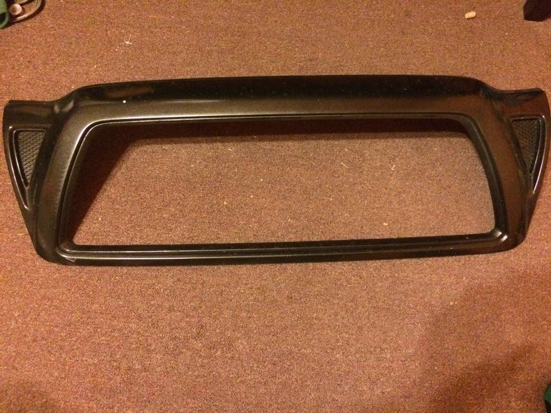

    I didnt even have to fiberglass mine. I did a thin lip satoshi. If youre looking for a deep dish fiberglass is definitely required though.

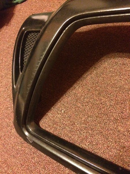

    Heres a few pics of mine. After i cut out the center pieces and the sides were exposed, i used the lowest point of where the plastic was still solid and just rounded off the edge evenly. Heres a pic, it is about 5/8ths of an inch from the outer surround.
