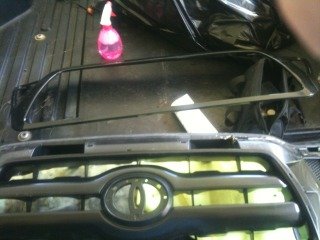

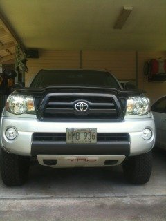

    I stuck it on my truck to see how it looked actually left it on for a week.
    I did as much research from threads here on the forum.
    D8759C33-9BE9-4BBB-A49F-0F496B0715F9-215_f069158719c7fa20979aa347ea275abb72c26898.jpg

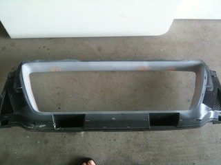

    Here's a pic of the surround off of the main assembly. A dremel and a small grinding bit worked wonders for this.
    67FB69DD-4A8A-4E2A-87B9-98383B99EB8F-215_71b43e8e179ce298d31df964aae65ab3ce3c1bbf.jpg

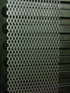

    Here's the mesh I got from a local steel supply house. It's aluminum and goes for about 20$ for a 1'x5' piece. You just gotta make sure they cut it in the right direction.
    A25D2F45-DFF4-4449-B475-C506AA5BFFE7-215_7a27280f0fbc09974db55ce249e3af537a990a9b.jpg

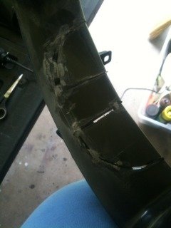

    Here's the main body without the center section. I started to fill the sides and cut parts. I used a coping saw with a fine tooth blade to cut this out. Worked like a charm.
    42F4516C-5858-443B-BBD7-C78B956DD600-215_70b4f2b38b266ded5c05b7fa7c72df0d6a2e235b.jpg

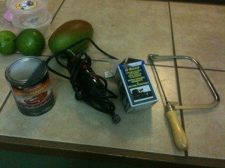

    The coping saw is to the right of the pic. Also I used "Q bond" to put the hut out pieces back in on the sides. Qbond is a two part glue/powder system that works awesome. Super strong and fast.
    7D4D98A7-57A2-48A8-9368-1F074CFB078A-215_e9c5527699c7011af5a8a95225c2371b185ed897.jpg
    Here's a pic of how that looks. I just put masking tape on the back side, filled the crack with the powder then driped in the glue.

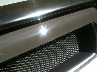

    Got the surround back from paint. My friend made a custom blended color grey ish graphite.
    I finished the inner piece with a good sand able primer then a top coat of satin black bumper paint.

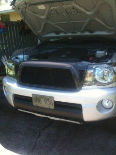

    I used the qbond to attach the outer surround to the main assembly. Here's a pic of my test fit.
    The whole process took me a month. I figure I could of did this whole thing in a day but I'm a busy dude... With little children and a full time job.

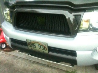

    53A7EAB7-1DD5-4148-8599-3ACFF8434110-215_d3a3d211ae316cdc873f32802730fec1ce5dd92f.jpg
    Here's a pic of the finished product. Lemme know if you have any questions if I failed to cover somthing. Thanks for looking!

    66231652-885D-46D2-B3DD-F34335A16BB5-146_0912cbc5e92f49e70dd97b5807608d395b64b133.jpg
    It's back! Thanks to Homer the zip ties worked great!
