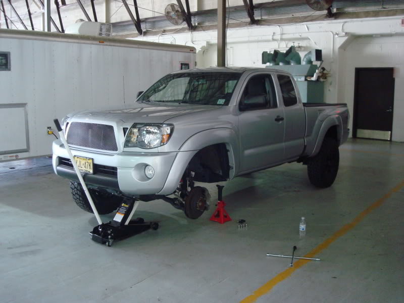

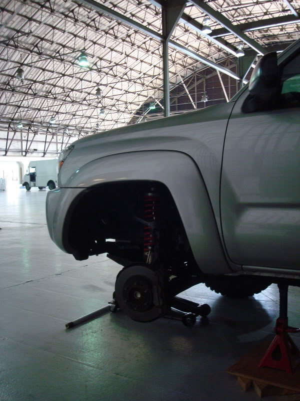

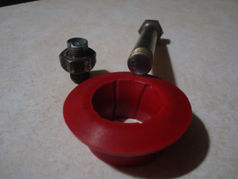

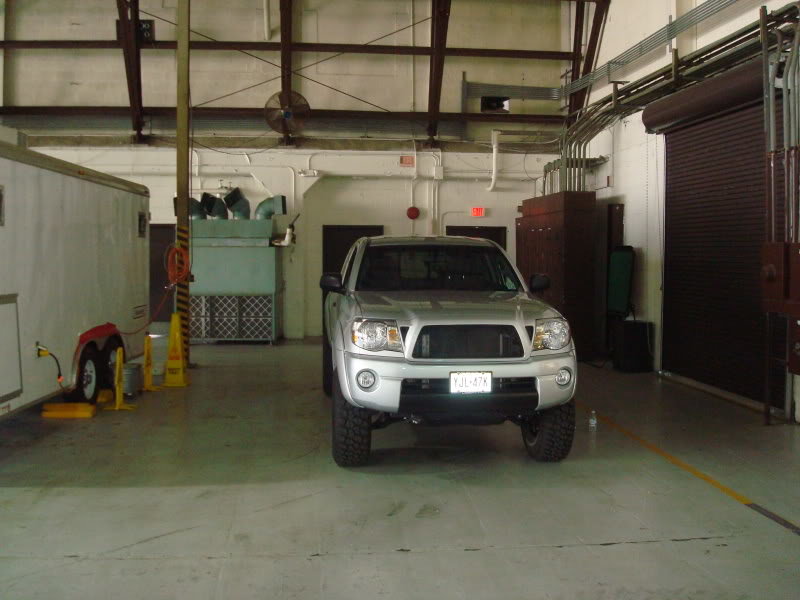

    well my truck had a bulging/deformed bushing on my TC UCA so i ordered a new one and was ready to replace it, the fact i work in a hangar and a good buddy works as vehicle maintenance in the same hangar seemed like it would make it a breeze to change... wrong.
    well i pulled the truck into the hangar and got it up on the jack and the wheel off

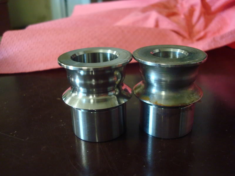

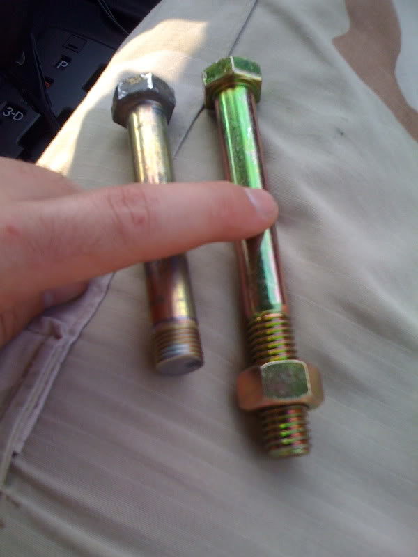

    well i got on with changing the bushing, no major problems other that getting the through bolt back in being a PITA, a bit of the plastic on the fuel line came off and gave me an oh shit i F'd something up moment, but after inspecting the line was fine, so i to put it all back together. here is where the fun begins, i had a bit of rust on the ball joints so i figured while i had everything apart I'd take them apart and clean/lube them up with a dry teflon lube... bad idea. as i start to take the bolt that runs through the ball joint and spindle i get about three or four turns and then it stops, so i get the breaker bar, half a turn and then nothing..... so being the buddy is vehicle maintenance we back in his work truck and get out the impact wrench, nothing..... so we up the force and get the breaker bar back out with about a 4ft pipe on the end, got about a 1/4 turn and SNAP, broke the bolt off at the threads!!! i figured hey at least its off, i'll just run and get a new one at NAPA, wrong! i spent the next 4 hrs calling around tring to find a grade 8 bolt that was 9/16 X 5in, the biggest anyone had was 4in. as a last ditch try i called Lowes, guess what they had one, of all places Lowes??
    The snapped bolt and the new one. only diff is the threads.
    At least the ball joint got cleaned. before on the right, good as new on the left.
    The bushing that caused the whole issue and the snapped bolt

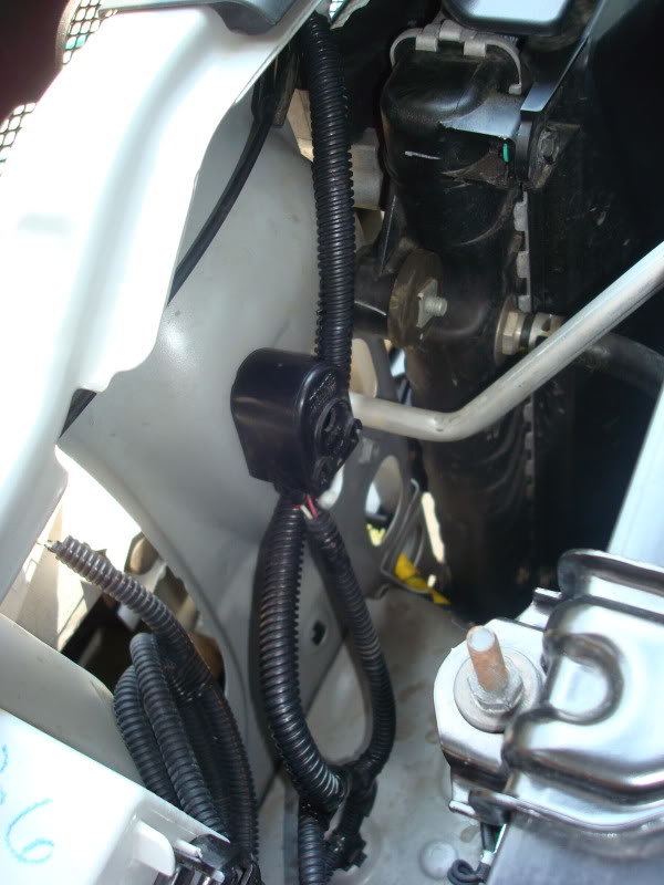

    already moved the horns and re-routed the wires for them.
    i separated the wire for the thermometer and re-wrapped in that plastic wire wrap stuff and ran it back to the original location

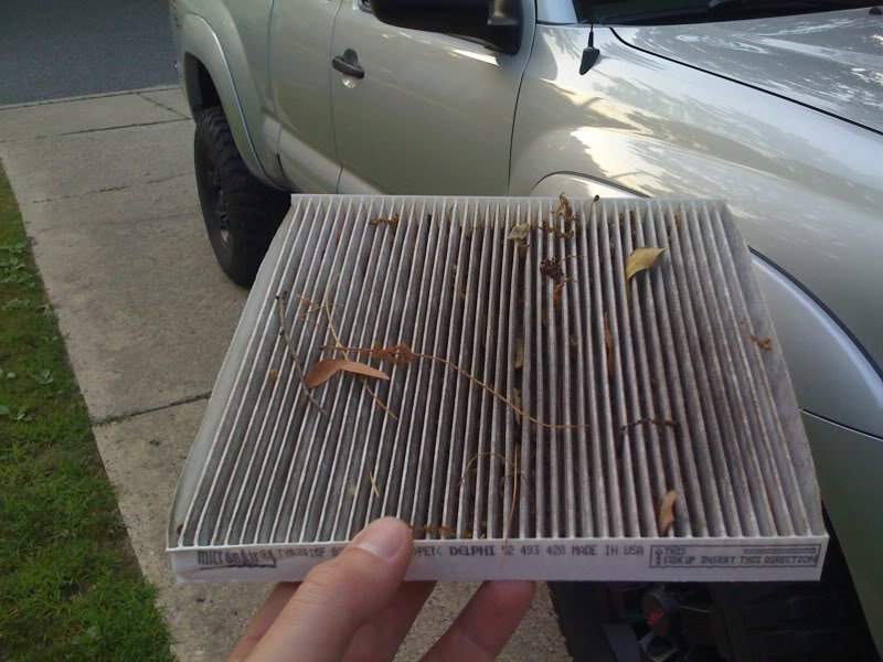

    and replaced the disgusting cabin air filter

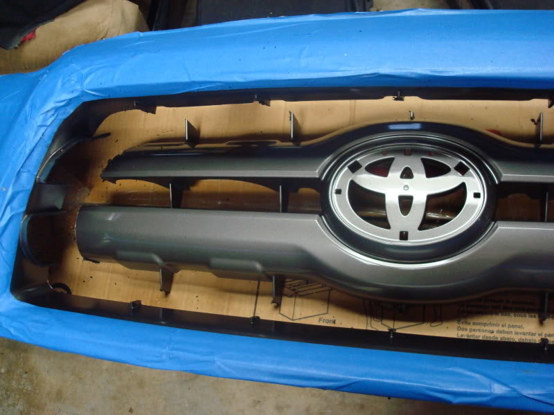

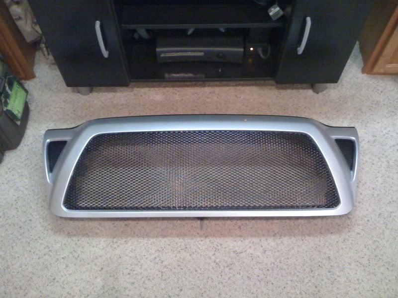

    all i have left is to paint the radiator with some grill paint, and sand/re-paint the lower center portion of the bumper to get rid of all the nicks from rocks.

    Before you do the other side take a small wire brush and clean the threads off any bolt you plan to remove.
    The bolts will come off much easier!
    Just a small bit of contamination will make it almost impossible to remove them. (It's because they are fine thread bolts.)
    You may want to install a nylon locking nut on the new bolt also. Lasting you want is that thing coming off while you're driving.

    I do have a question, the threads on the original bolt were 20, the new one is 12, will there be any issues with the difference in coarseness of the threads?

    Depends on how you will be using your truck.
    The larger threads can loosen easier than the finer threads.
    For the UCA's? I don't think they will be too bad. I don't think you'll push them to their design limits.
    The type of threads used in any application allows them to handle different types of stresses.
    It's expensive but you can call Pat over at TC and he can hook you up with new bolts.
    Good Luck!

    The UCA only keeps the spindle in the correct orientation. It doesnt bear a load, unless breaking, cornering, etc. Like Toku saud, you can use a nylock nut, but being as they are torqued to 100 ft-lbs, you should be fine with a regular nut. Mine have been tight every time I take them off, and Im running the corse thread bolts. My bolts supplied by TC broke as your did.

    Thanks Chris, I'm going to put a bit of paint on the bolt just to be able to do a quick visual check on it periodically, we use the same method on the jets at work for their tires.

    just as a heads up i called Total Chaos and they confirmed what chris had said, bolts will be fine as long as they are torqued correctly

    Well finally got the other side done this weekend, cleaned/lubed the bolt first this time, huge help. only thing to note is that the rust on the ball joint on the passangers side was a bit worse and caused some minor pitting, def something i will have to stay on top of maintenance wise.
