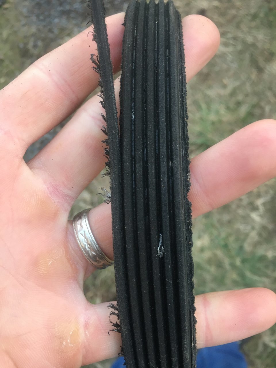

  18. Dec 23, 2019 at 1:36 PM
    #38
    TheDevilYouLove
    TheDevilYouLove [OP] You can’t polish a turd, but you can polish a TRD
    May 26, 2016
    #187953
    2,821
    Steve
    Marylandistan
    2010 Tacoma TRD Sport Access cab 4x4 silver streak
    Here are the ribs for your pleasure
  19. Dec 23, 2019 at 1:59 PM
    #39
    Accipiter13
    Accipiter13 Well-Known Member
    Apr 5, 2012
    #76325
    960
    California
    '11 DCLB 4x4 Sport
    Honestly that looks like wear from a bad pulley.
  20. Dec 23, 2019 at 2:07 PM
    #40
    TheDevilYouLove
    May 26, 2016
    #187953
    2,821
    Steve
    Marylandistan
    I got new OEM pulleys on the way
