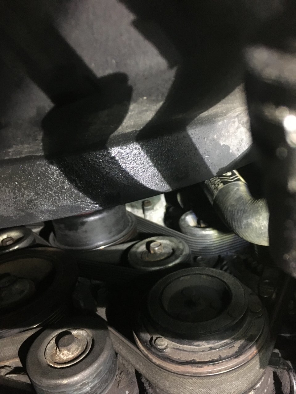

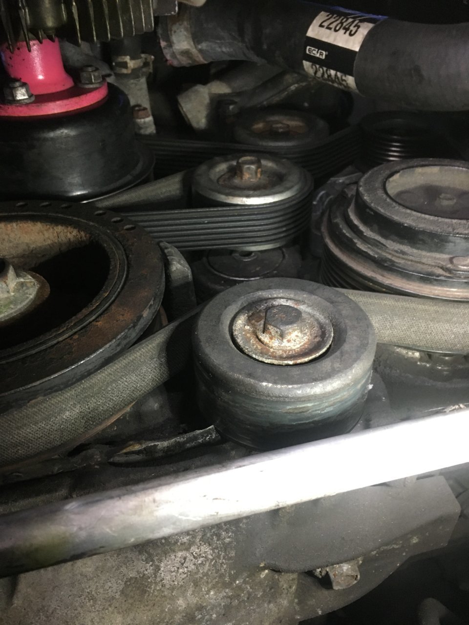

    After berating USA made Bando, I think the problem is me. Looks like I didn’t install a pulley correctly. The top idler is sticking out way too far.
    This is from underneath the truck looking upward.

    Seems likely! These things happen. Good on ya though, says something about a person when they own up to a small error that could have been swept under the rug rather than hide behind blaming something outside themselves.

    Is that the tension pulley? I think the Gates replacement pulley is accidentally installed that way by many DIY’rs

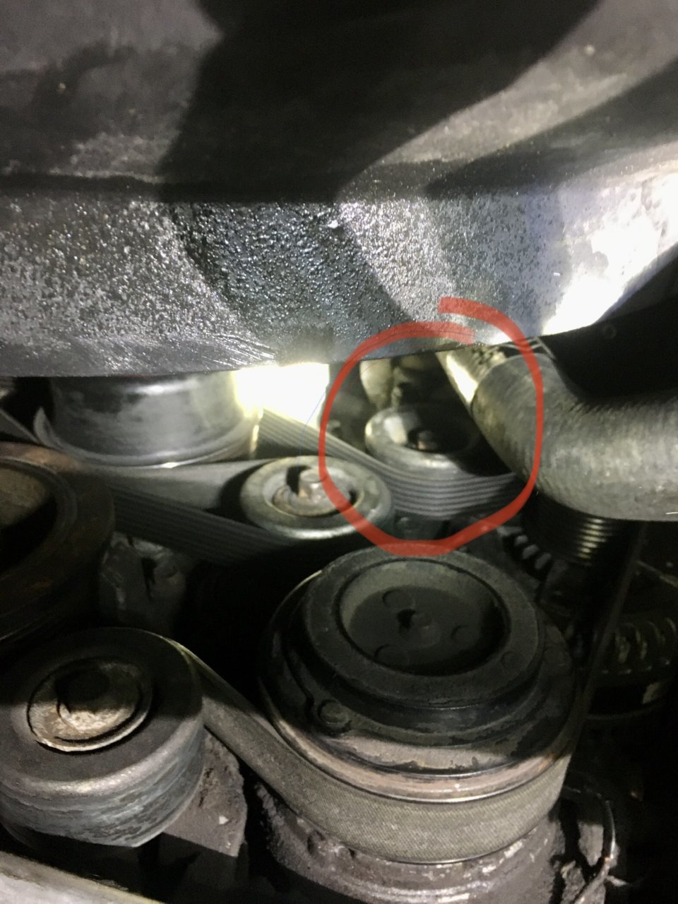

    The red circled pulley is an idler, the tension pulley is beneath it. The tension pulley is the Febest with Nachi bearing.

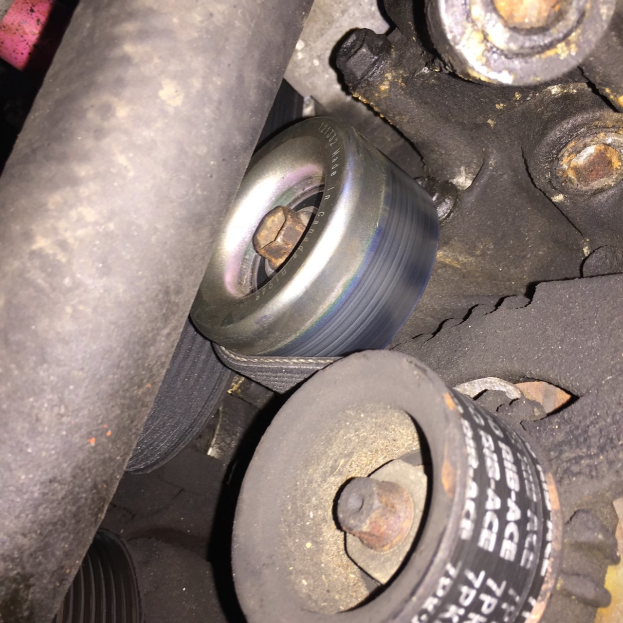

    I put the original OEM pulley back on and it lines up a heck of a lot better. I think I def did not install the Gates idler correctly, it was too far forward toward the radiator and the belt wasn’t riding completely on it.
    it’s the top pulley in the pic below.

    Found this pic from when I installed the new Gates pulleys. It seems so obvious now what this pulley was not aligned right with the belt, but I didn’t notice it at the time.

    What was the problem with getting the idler in the correct position?

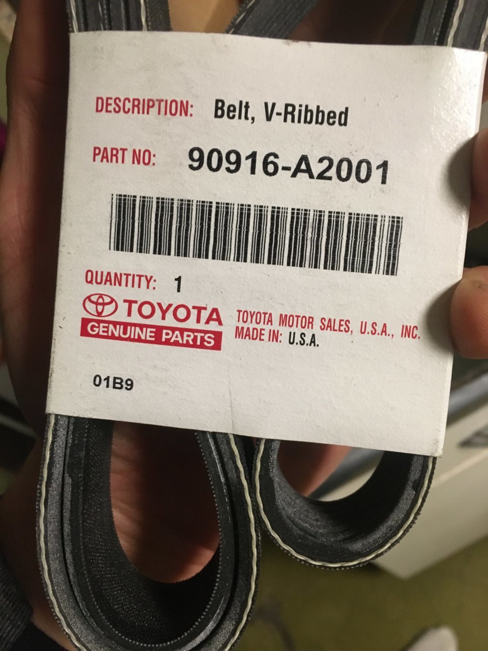

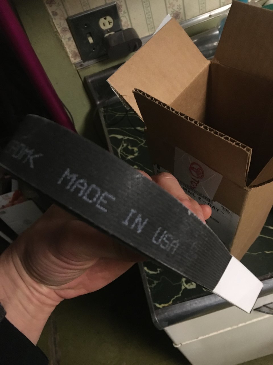

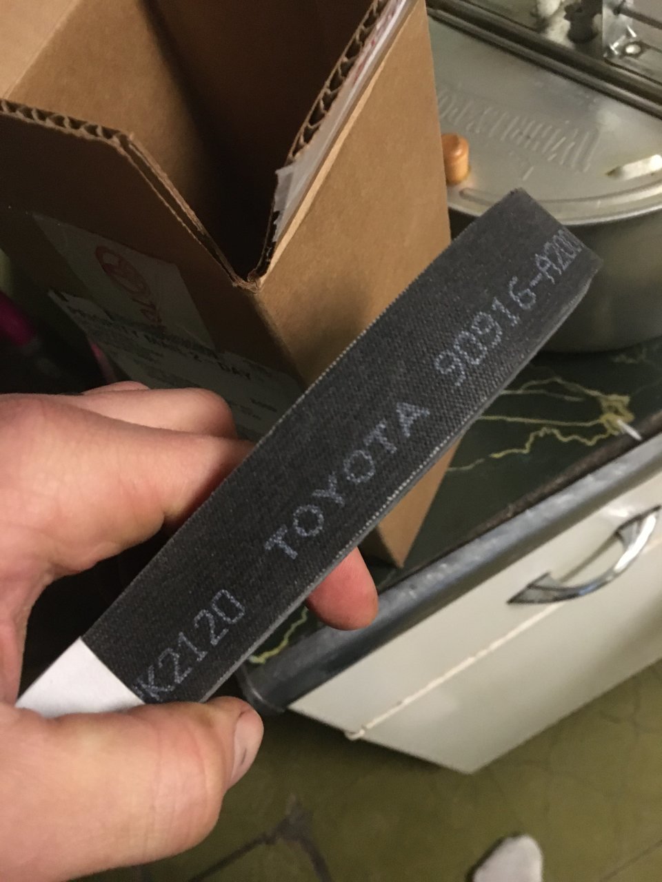

    I am suspect that Bando is the OEM belt maker. The Toyota belt looks different than the Bando. The Toyota belt is also made in the USA though

    Got me dude. There was a thin washer behind it, I guess that had to be it?

    Did you install just like the DIY thread?

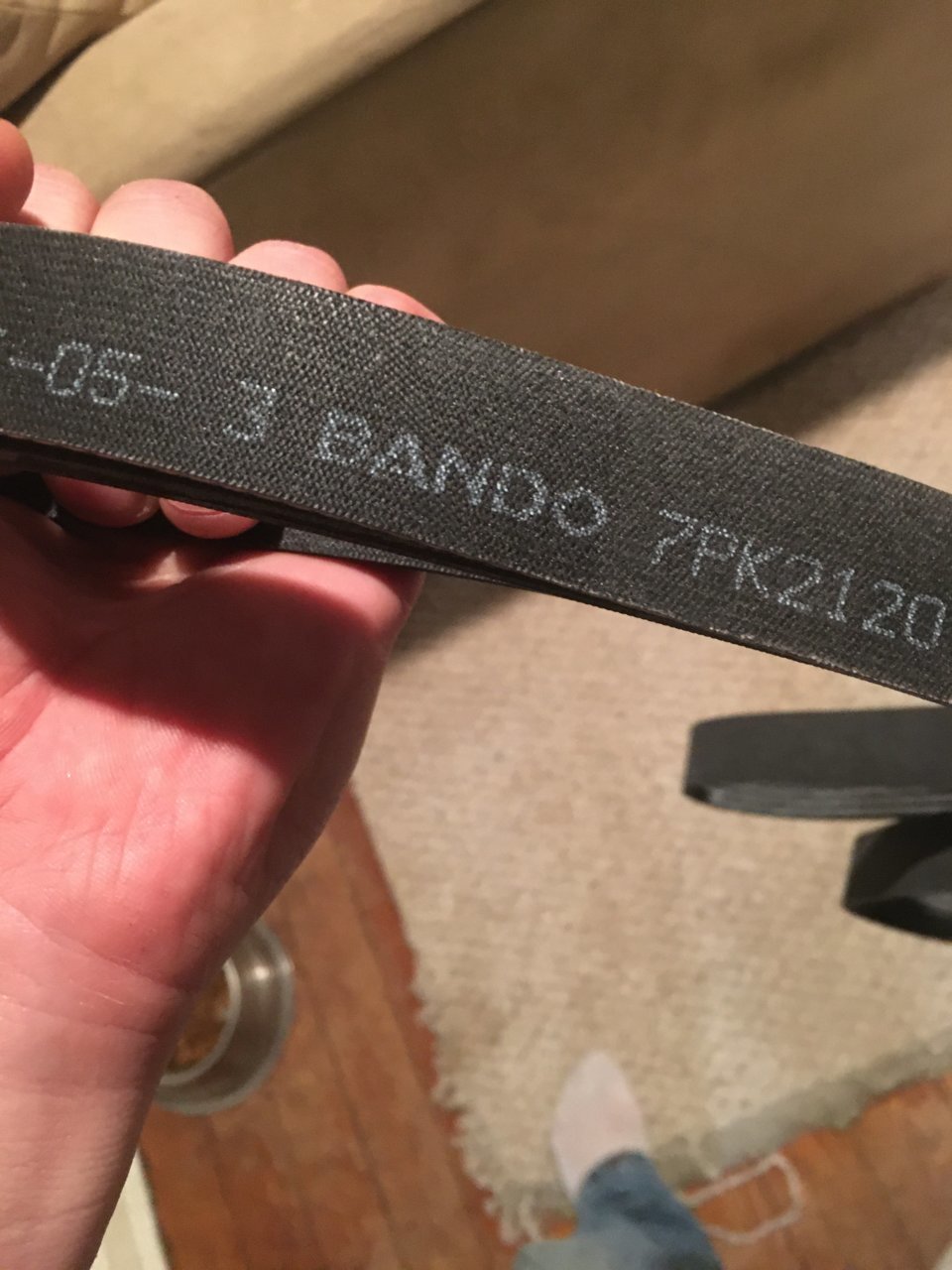

    Well never mind, the Toyota belt says “Bando” right on it. But it’s definitely different than the normal Bando belt. On the regular Bando belt, the non-rib side is shiny. On the Toyota it’s dull. Definitely very different belts.
