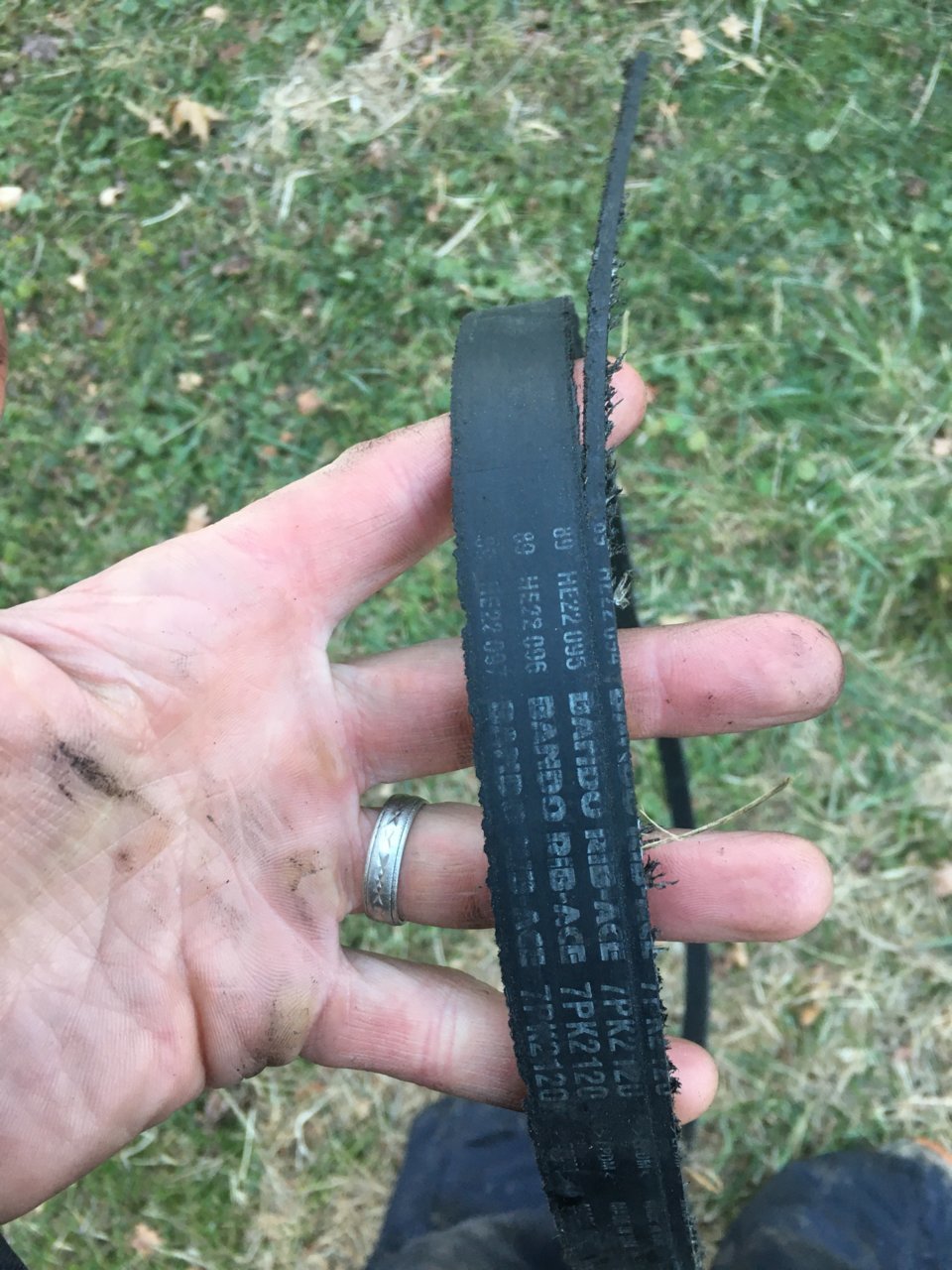

    What did the dealer charge you for that belt. Trying to decide between oem and a bando off Amazon.
    On a side note, do belts go bad with miles or is time a factor as well. I own a 2013 Tacoma with 31k and I belive my belt is squeaking. Would time cause the belt to squeak?
  2. Dec 26, 2019 at 4:10 PM
    #62
    TheDevilYouLove
    TheDevilYouLove [OP] You can’t polish a turd, but you can polish a TRD
    May 26, 2016
    #187953
    2,821
    Steve
    Marylandistan
    2010 Tacoma TRD Sport Access cab 4x4 silver streak
    I got the OEM from Olathe through Amazon. I like to pick a Toyota dealer as the seller because of all the fakes. It was $36.64 shipped. About 2x what the plain Bando cost.

    dayum, I got 135k out of my stock belt and I probably could have gone longer but didn't want to risk it.
  4. Dec 26, 2019 at 4:16 PM
    #64
    TheDevilYouLove
    May 26, 2016
    #187953
    2,821
    Steve
    Marylandistan

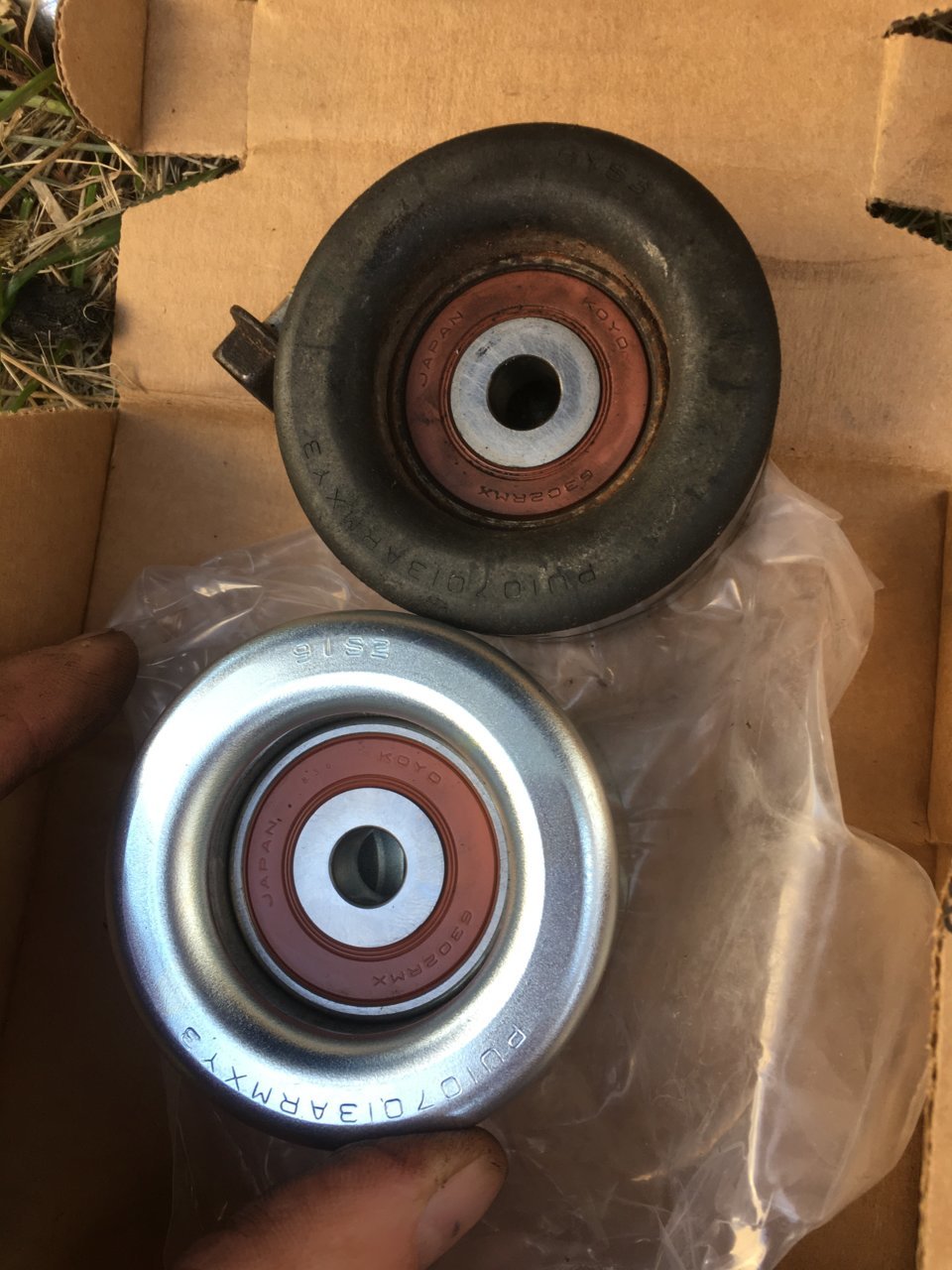

    I’m not far behind, I got 120k out my OEM belt and it looked so good I kept it as a spare. Using it until my new idler pulleys come in so I can replace everything at once.

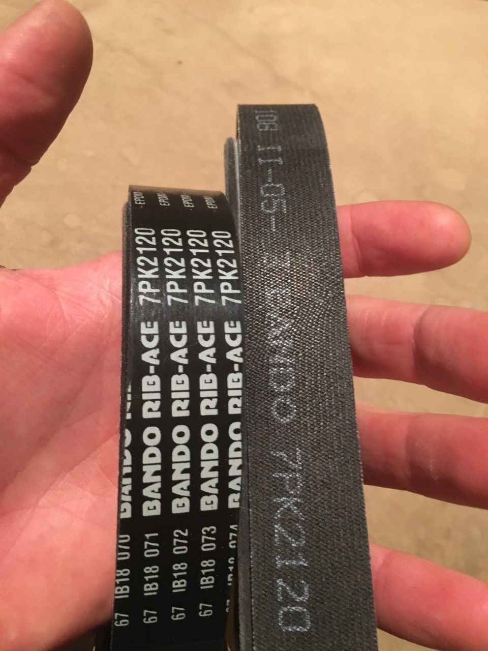

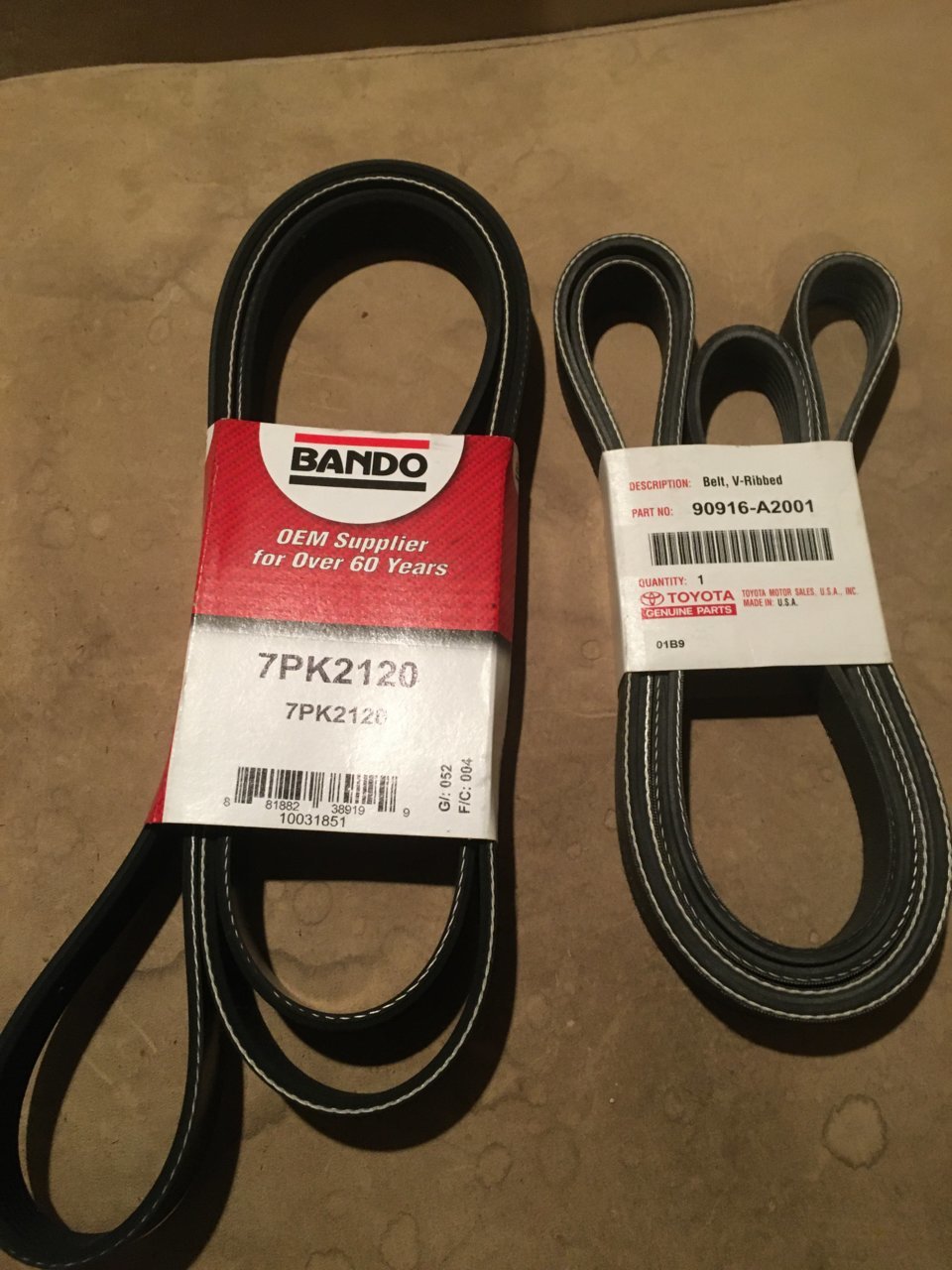

    can you do a side by side comparison for the length, ive heard the OEM Bando is a shorter length/tighter fit
  6. Dec 26, 2019 at 5:10 PM
    #66
    TheDevilYouLove
    May 26, 2016
    #187953
    2,821
    Steve
    Marylandistan
    They look about the same
    BillsSR5[QUOTED] likes this.

    Remember that the whole tensioner assembly includes the new pulley and the spring tensioner that keeps the belt tight on all the pulleys and 3 idlers so if you have a lot of miles that will need to be done. You may get a squealing noise if it slips at times and I noticed a burning belt smell on hard downshifts (full throttle) as the belt tension was not tight enough. With all new OEM idlers and tensioner assembly I'm smooth and quiet again. The slight grating noise creeps up on you and you really don't notice it but when you have all new stuff in there I now notice how quiet it is.

    my 2.7L OEM Belt 90916-02708 is a Made in Japan part, im not sure if its a BANDO tho
  9. Dec 27, 2019 at 11:51 AM
    #69
    TuRDLYFE
    TuRDLYFE Well-Known Member
    Nov 9, 2019
    #310230
    1,501
    An over-taxed town, county, and state
    2020 AG TRD Pro 6MT
    Aftermarket sales aren't subject to the same controls as OEM. Toyota has more stringent requirements placed (contractually) on their suppliers than they impose upon themselves. If it's branded Toyota, it met their standards above and beyond the manufacturer's aftermarket standard.

    New OEM belt and 3 OEM idler pulleys. Should be good to go, now!

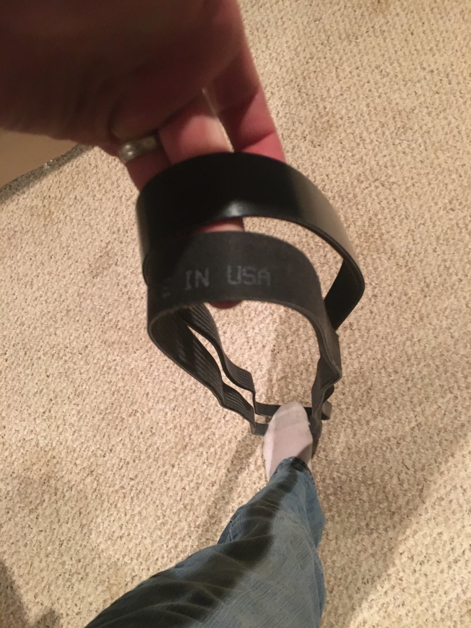

    It was made in USA but I messed up a Gates pulley install which killed it
    Mully[QUOTED], BillsSR5 and TuRDLYFE like this.

    Not done yet you missed the tensioner pulley and assembly - that one was the worst on my 2009 and grooved with spring tension getting weaker.
    Only another $100 OEM and a few hours as AC compressor and alternator need to be unbolted to get that tensioner assembly off/on.
    As your skid plate is off change the front diff lube and look at the PS return hose as its metal and mine was corroded almost thru at the 90 bent on passenger side.
    Enjoy.

    I replaced the tension pulley with a Febest pulley with Nachi bearing that I pressed in last year. If the whole tensioner goes tits up, I’ll replace with OEM. Front diff lube was done this summer.

    If the belts are the same length, with the same number of ribs, and a smooth (or smooth-ish) backside... they are considered the same belt. That's why they have the same part number.
  20. Dec 30, 2019 at 11:16 AM
    #80
    Taco'09
    Taco'09 Well-Known Member
    Dec 31, 2008
    #12073
    1,876
    I just purchased an OEM belt from the dealer and it carries both the Toyota part number and a Bando number, the bando number being the same as the choice listed on Rock Auto. Toyota uses a number of suppliers for virtually all its parts so it did not concern me that it was not labeled a Gates or something else.
