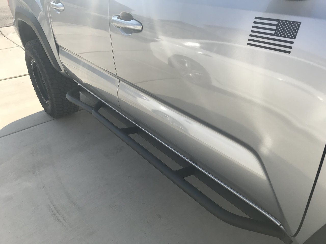

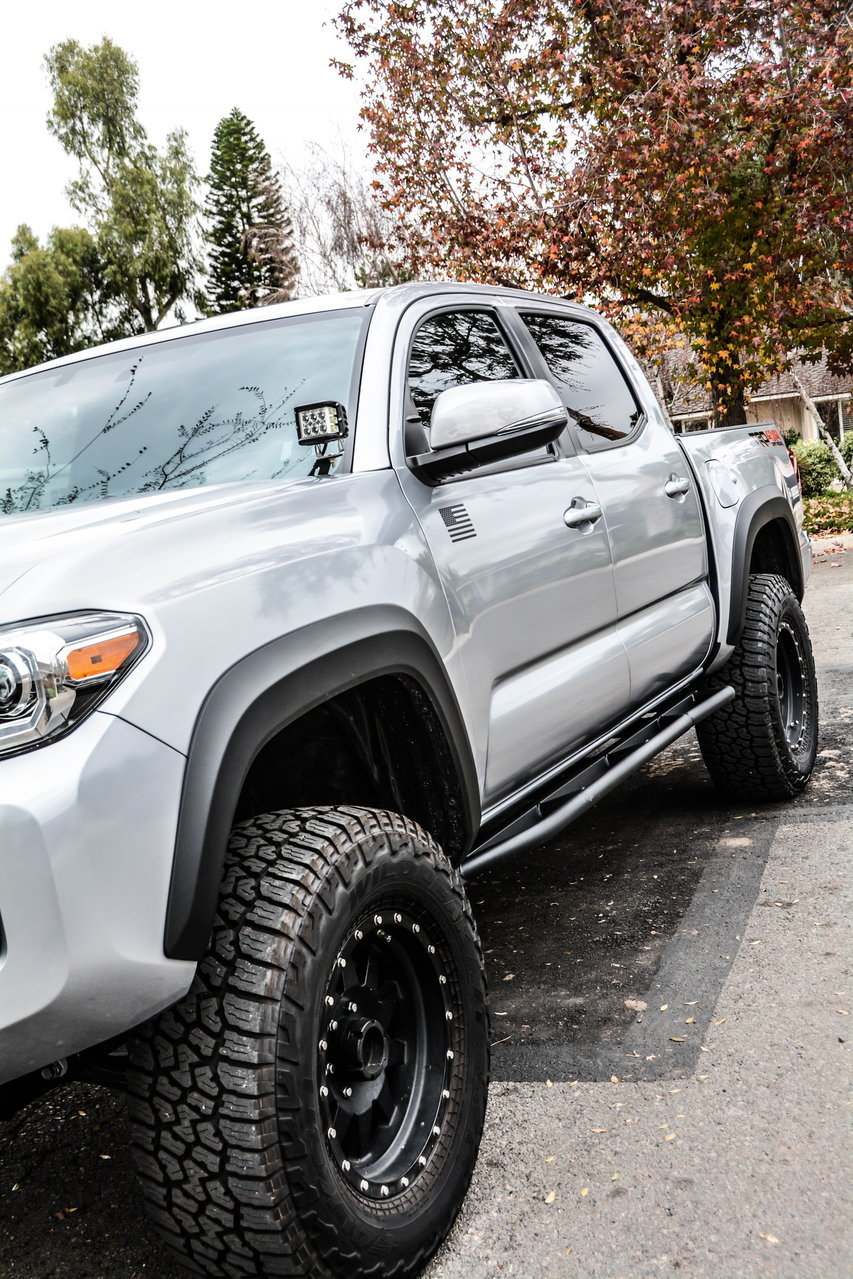

    C7B34473-4076-43C3-B3D1-19C8CE39889A.jpg DF234797-BCAC-4DBB-8955-A624CC5C5DFA.jpg
    Installed SOS Concepts sliders and IFS skid. Debadged chrome lettering on truck.

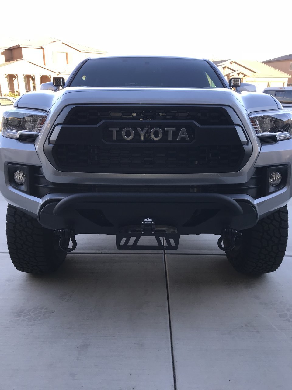

    Installed SOS Concepts Streamline Winch bumper today. Had to remove my bumper light to make room for winch so relocating that behind grille. Also installed a flipster v2 license plate mount that swivels up to pull out winch line. Love them both.

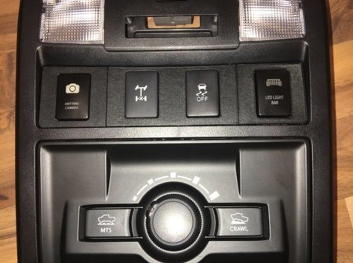

    Just ordered a new switch plate that will replace the one on my ceiling next to locker switch. This will allow two more switch blanks. I will now have 6 added oem switches inside the cab which should be enough for what i need. Plan to prewire them all into engine bay at one time so wires are all cleaned up at once and easy to just add switch in future.

    Truck is rad ! I'm about to order up that bumper as well. So do you cut the black nose off the bumper or is it a separate piece that comes off?
    How was it to instal? And did it take 8 weeks to get it.? Sorry for all the questions, but your timing is perfect.
    I'm thinking I might use some tube bar mounts to mount LEDs to the bumpers cross bar.
  18. Jan 21, 2018 at 5:12 PM
    #78
    Friedtacolover
    Friedtacolover [OP] Well-Known Member
    Sep 2, 2014
    #137481
    1,560
    Travis
    Ontario, Ca
    2017 DCSB Off Road 4x4
    my build tread: https://www.tacomaworld.com/threads/socal-no-shame-poser-build.513084/
    First off the company is awesome so definitly use them. The install is so dam easy man its ridiculous. Hardest part was removing the bumper. Yes took 8 weeks but i did a group buy with sliders and skid so maybe you will be faster?
    If you want an led id just get the cutout in the bumper and do it. Im a little disapointed i did not. the hidden bumper light i had wont fit with a winch and it will be hard to get a light under hoop to mount exterior due to bumpers angles. Im putting my light behind the grille then a 40” on prinsu then my ditch lights. I just dont like look of exterior mounted bumper lights.
    To install:
    1)Remove grille.
    2)Remove entire bumper
    3) Remove crash bar (no longer used)
    4) Remove factory tow hook (no longer fits)
    5) Turn bumper over and look at it from the inside. The black part simply unclips exactly like a grille replacement.
    6) you will see the molding where the black bumper fit against. Cut that area out using a dremmel or razor blade. Took 2 minutes. Very simple.
    7) place rubber door trim onto bumper to cover cuts imperfections and to fill gap between steal bumper and oem bumper when mounted.
    8) install a coolent bracket supplied
    9) install oem bumper
    10) install new steal bumper onto crash bar
    11) install grille
    12) stand by for daily compliments
    Took 2 hours no issues at all. Take time taking bumper off i did break a flare clip. If you have any questions pm me when ready to install and ill shoot you my # to answer any questions.
