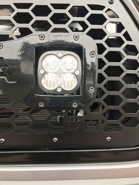

    Nothing fancy, adjusted the squadron pros so that they weren't blinding the birds, then switched out the internal for cool white LEDs.
    Then I'm thinking about adding some brake light guards off of eBay. Painted matte black first.

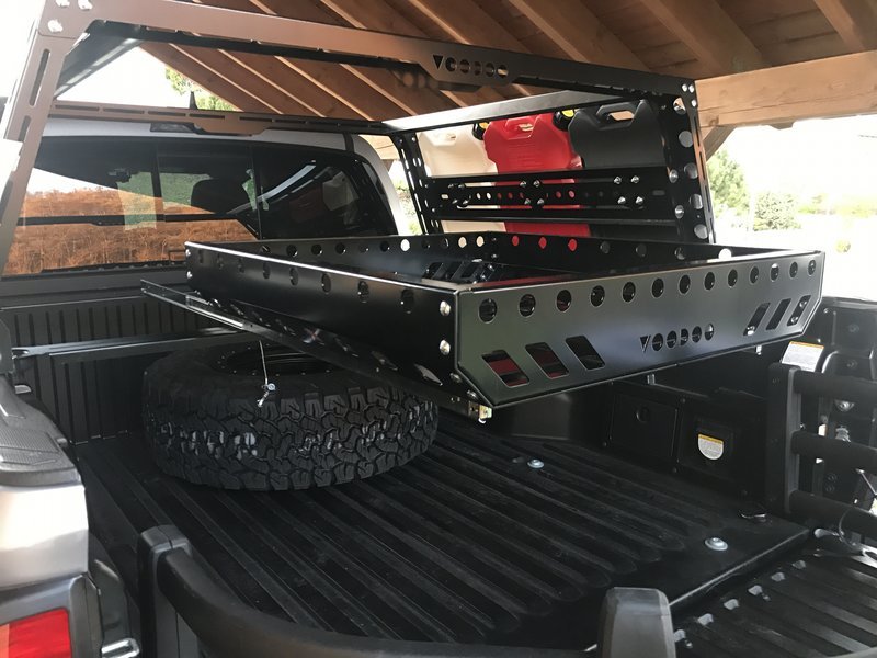

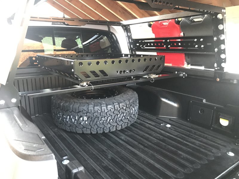

    Threw in the voodoo cross bars and storage bin this afternoon:

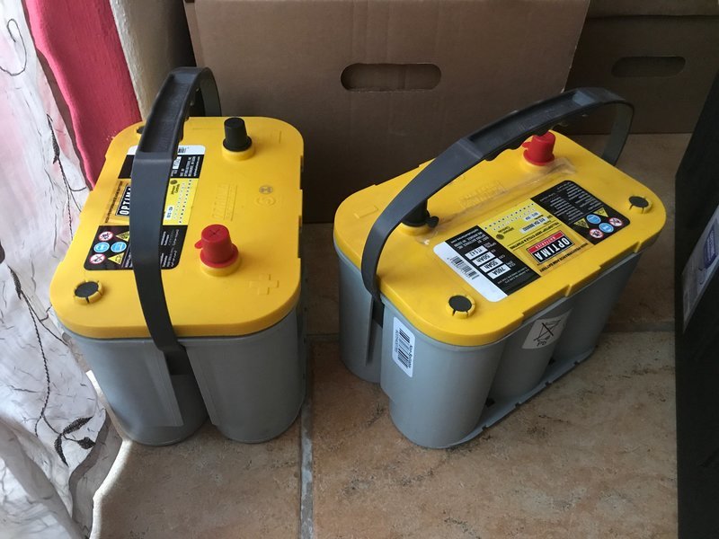

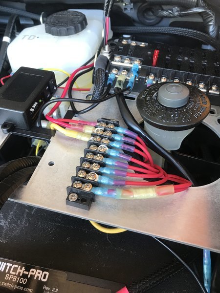

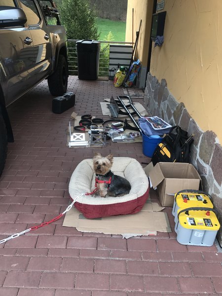

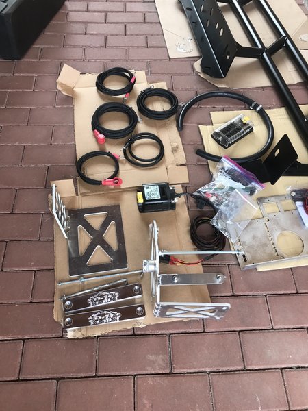

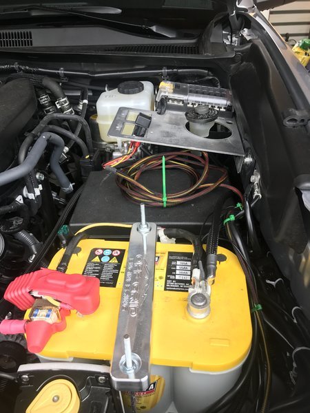

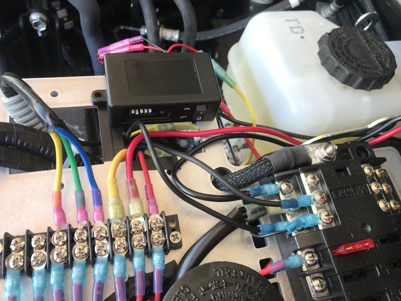

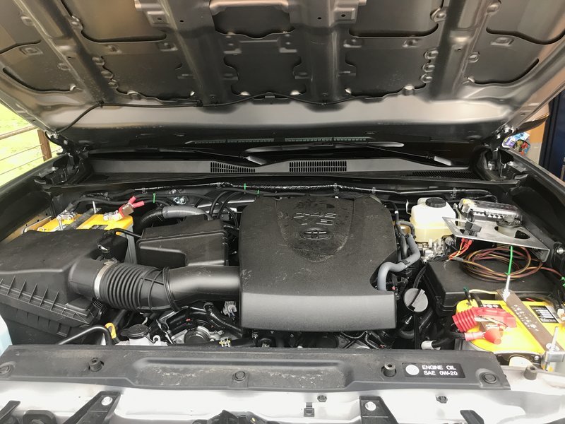

    Dual battery setup went in today, and the rock sliders came back from the powder coaters and went back on as well!
    Just waiting on the switch pro to get here, then I will clean up all the craziness with the wires.

    Great looking truck! How do you like the dual battery setup so far? Easy to install? I've been debating doing it for quite some time, just haven't pulled the trigger yet. Also I see your in Kaiserslautern, we used to live in Weilerbach when my Dad was stationed at Ramstein.
  12. Apr 22, 2017 at 12:47 PM
    #52
    TSki
    TSki [OP] Well-Known Member
    Sep 28, 2016
    #198449
    1,236
    Tyler
    Salmon, Idaho
    2017 Silver Sky TRD Off-Road, 4x4, DCSB MT
    https://www.tacomaworld.com/threads/my-silver-gsu-build.460083/
    Ive been through weilerbach a couple of times.. not a bad area. Dual battery setup went in today, so not a lot of experience with it yet, but it went in nice and easy. I had to "massage the AC line" a bit as I sized up with the Group 34 batteries.

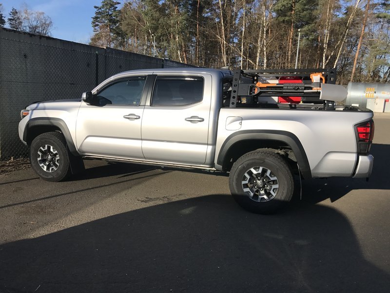

    Mounted the prinsu rack today.. both front and back!

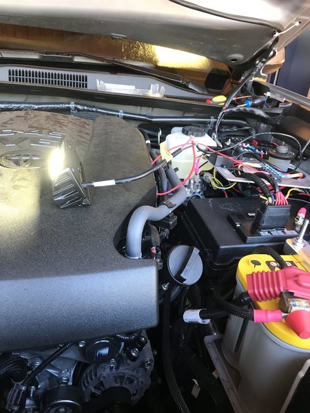

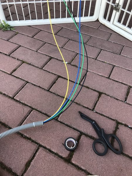

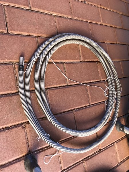

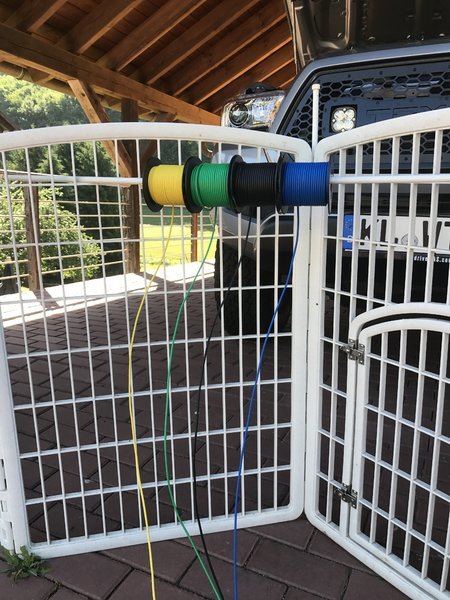

    I added my scene lighting over this last weekend! Rigid Industries Scene lights. Did two each side and two in the back, with each side under independent control through the switchpro.
    This is my version of a bench test.. I need to figure out an easier way to do this..
    I decided to run all the wires through reinforced tubing. This allows me to run it under the truck without concern that its gonna get destroyed.
    The jig made this way easier. I ran regular string through first with a lead weight on the end to get it to gravity fall through. Then used the string to yank the wires through. I didn't go with my traditional red for power as I wanted to be able to easily distinguish on both ends.
    Got the wiring all cleaned up!
    The two on the back!
    Passenger Door
    Passenger rear
    430 in the morning so I could catch some darkness..
    And finally here is the driverside lit up.
    All in call this was a very easy install, these seem perfectly designed to fit into the Prinsu/KB Voodoo racks. I am looking forward to getting this truck out into a dark field so I can see how big of a ring of light I can throw.
