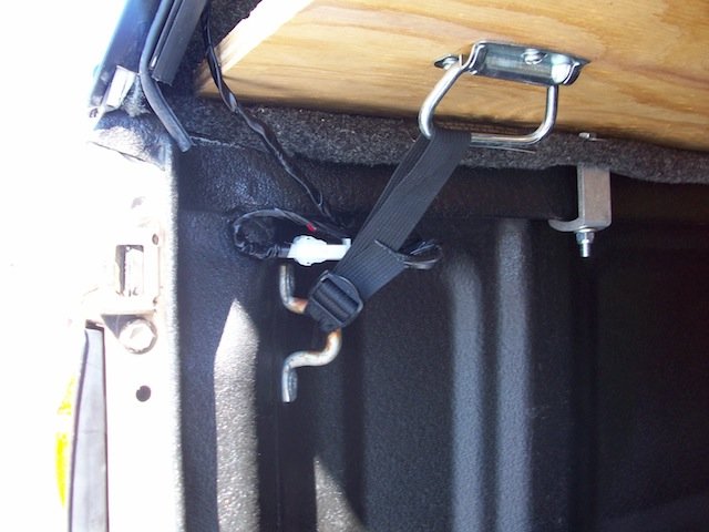

    To keep it from sliding around, you strap it to the hooks in your bed.

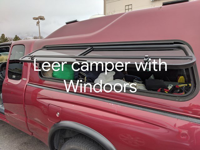

    Get the Leer 122 with Windoors, makes life so much easier.

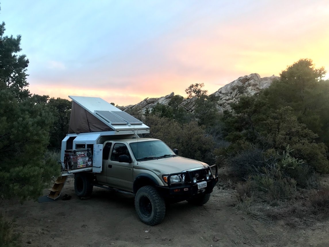

    That's a nice light simple set up. Reminds me of the 1st sleeping platform I built.
    My 2nd one was 3/4" plywood with drawers. It was crazy heavy. I turned it into a campfire.
    The 3rd one was aluminum and about 40 pounds and crazy strong. That one is a shelf in the shed now.
    The 4th one weighs about 18 pounds but it took 50 hours to make it. It's fiberglass and epoxy over foam. But the frame to hold up the platform weighs around 1,000 pounds and has taken 600 hours to build it to 70% done.
