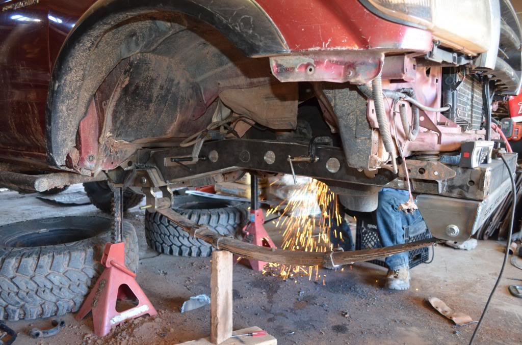

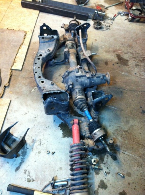

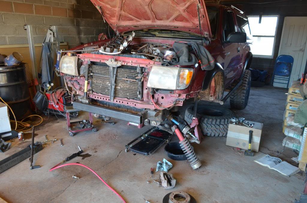

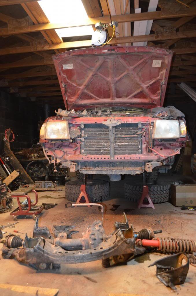

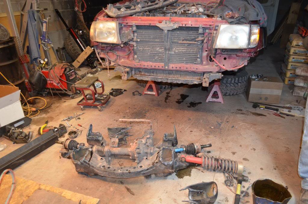

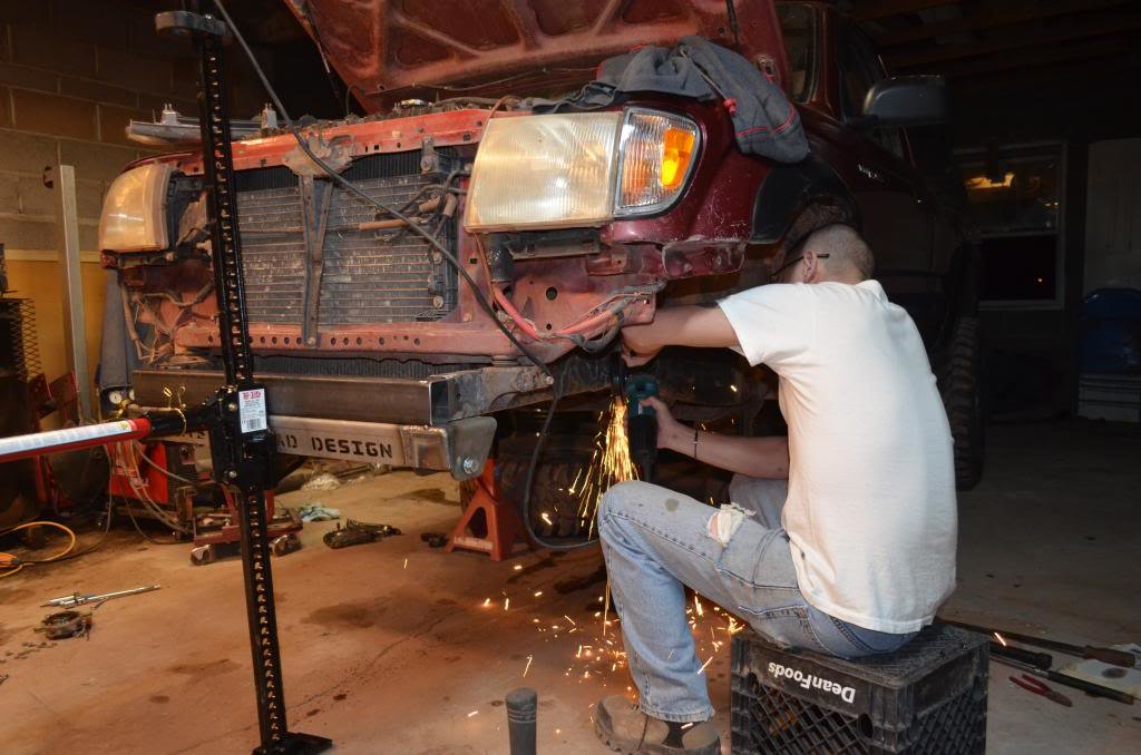

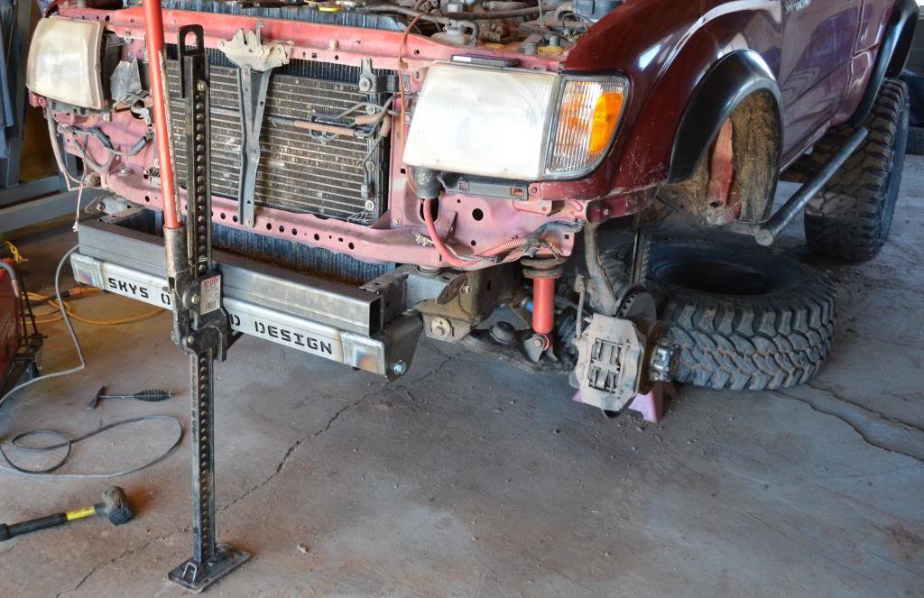

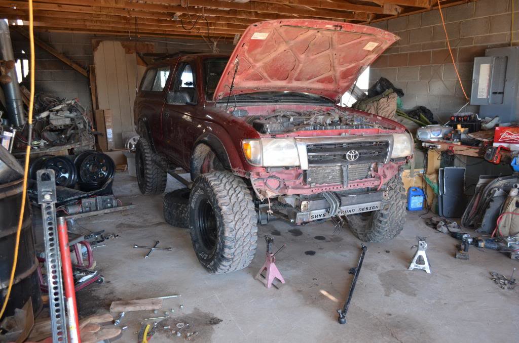

    Well finally I will start posting photos of the swap. The ones taken with my phone then will add the photos from my big camera.
    Started with unbolting everything I could the first half of the day. Then started cutting.
    AA90A09E-5548-4903-8637-A54BC6F42F82-244_c2e141e3c0f30bb7a5e92982ee2397e1e6372b18.jpg
    My buddy helping with the swap.
    6AA19070-E1AB-46B6-931D-4CF88D108234-273_7e9b970d65b7ae1e06b4a44f31f52574458cbaa4.jpg

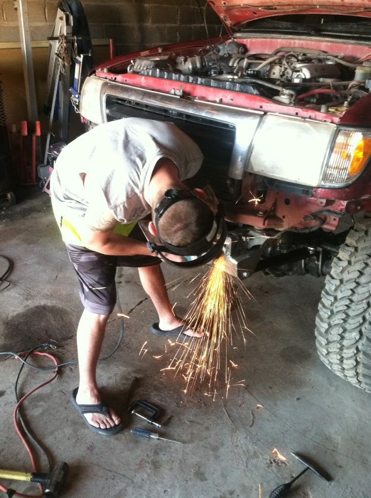

    A what not to do...
    C0004E72-7BD4-49D6-82D9-39019D75537B-273_f488caa03ec76ab82c3c03ca2091548f1edb51bf.jpg
    So my buddy decided to help out. I told him he wasn't dress appropriately, his response was, "At least my eyes are protected."

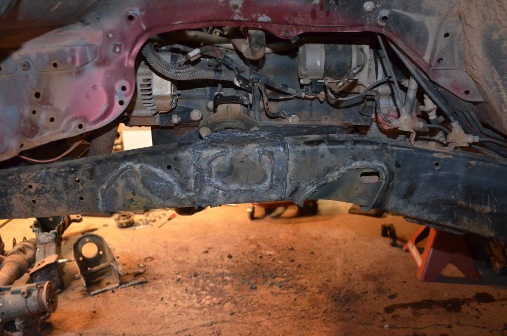

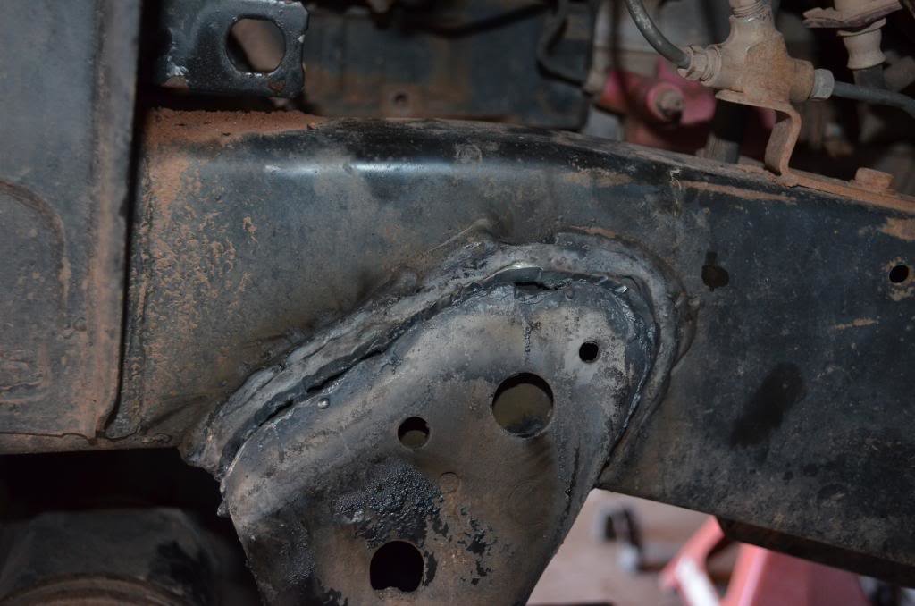

    Welding the front hangers in.
    1981679E-4A3E-42F2-BCDA-CB48E84A8A9F-219_2f3b7e0b3eab70579bc2951ca13df37b785d0b98.jpg

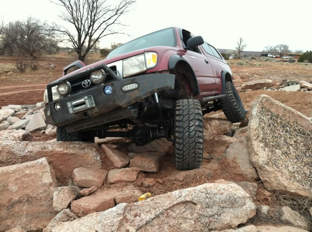

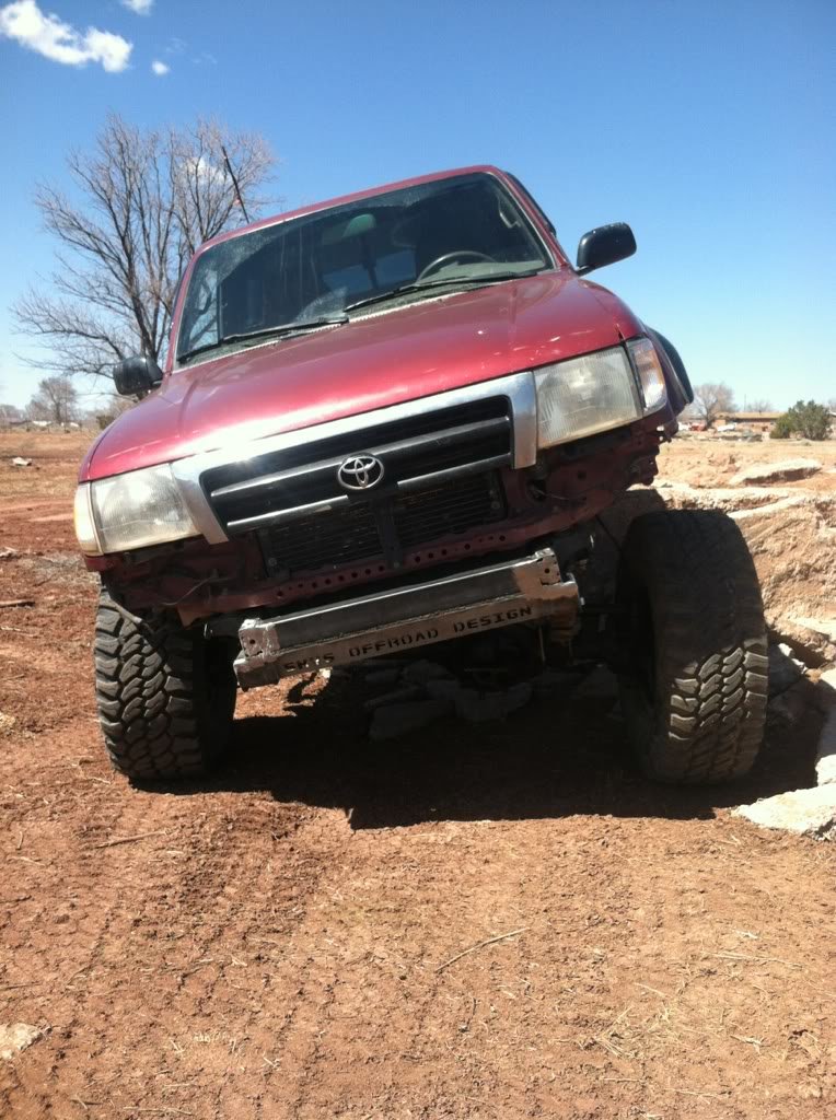

    Flexing the front.
    82BE3EDF-2A9D-42AC-B03F-1F4EF8AFD3E1-621_6d0e0b487b21993cd01a84531a7d867a8edc953b.jpg

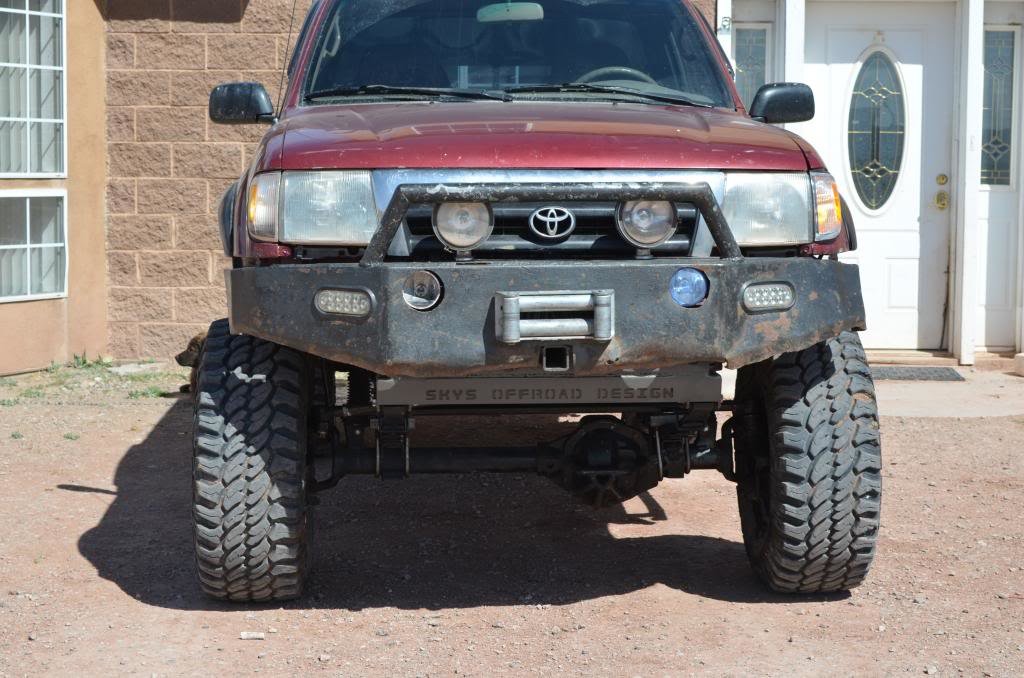

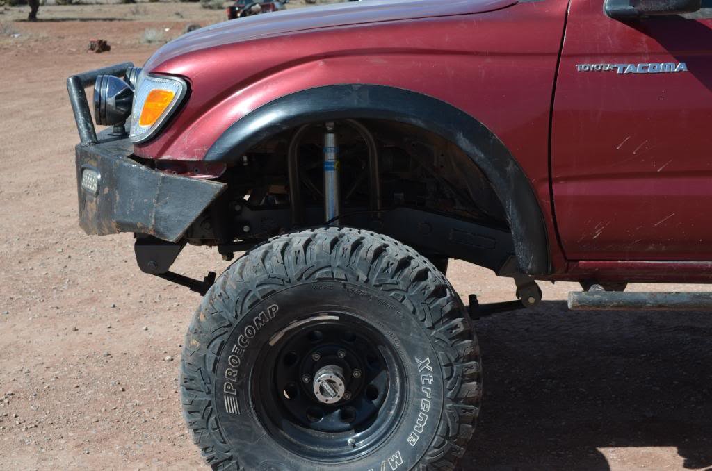

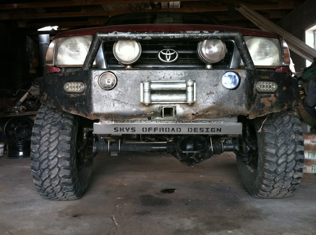

    Front bumper back on using the two bolts on the fairlead.
    750EEF2F-28F3-4038-B204-B3E563D5DA17-219_fb373c7650dcd6d1df71ea11965cfd23ffa26e54.jpg

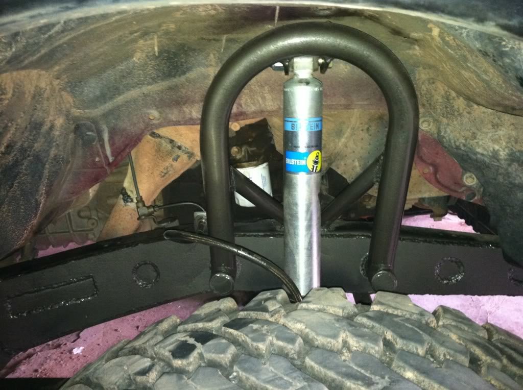

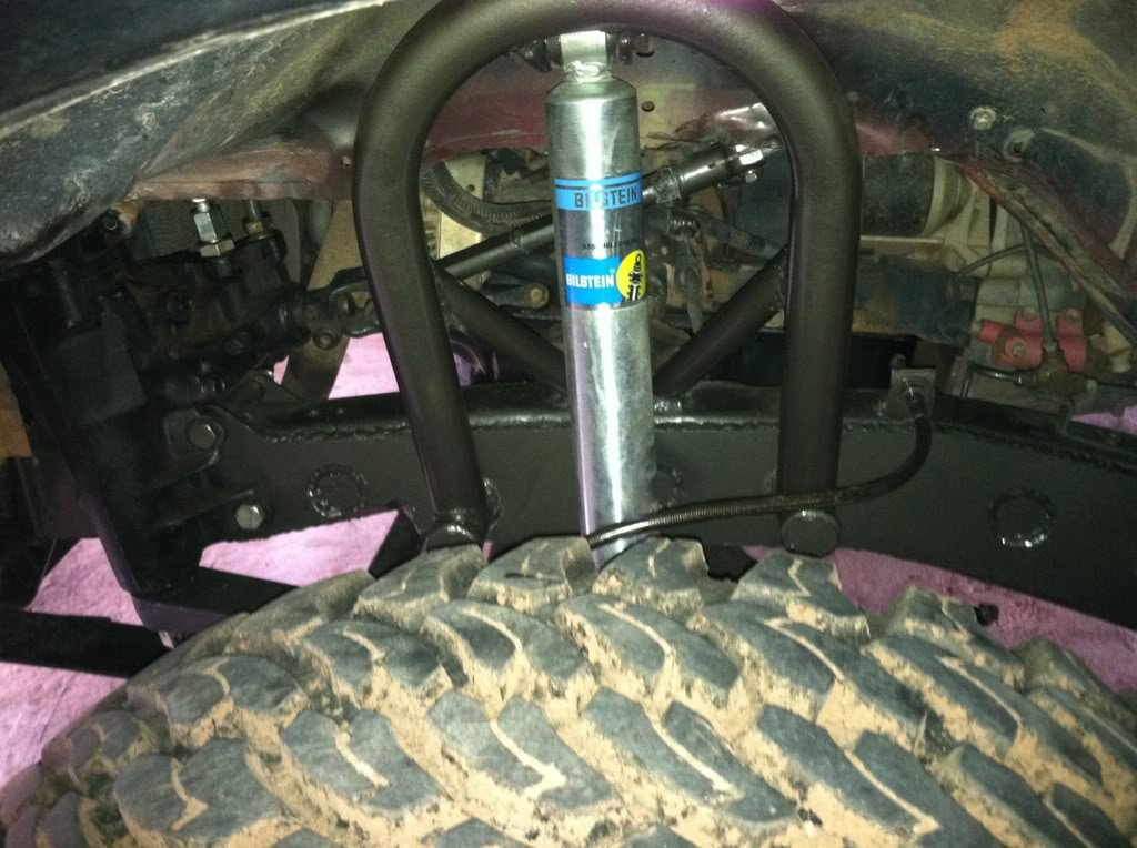

    The passenger side shock hoop
    A5B25874-64F0-4FFC-9493-75599BDDFAF9-219_5754876b3d1b8e5bd897fb59100df9f83f77e06b.jpg
    Driver side
    689C0E4D-B0D8-4966-ABA3-0A0AC68D985E-219_2c979d9164f0b27fedb1f3ae2ba91d5ba8f76f20.jpg

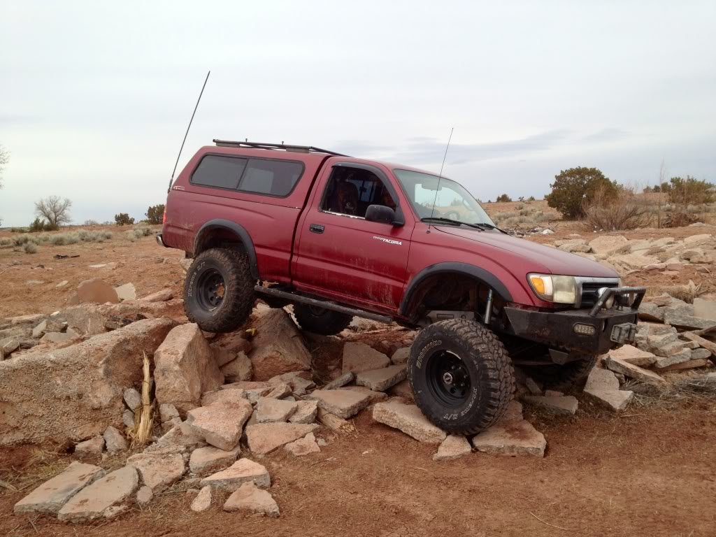

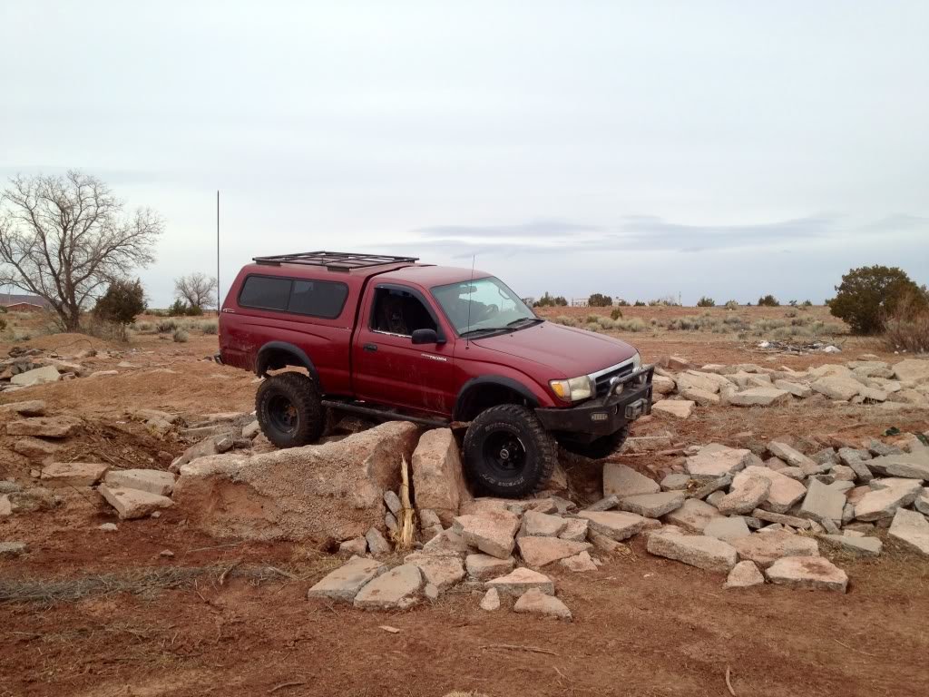

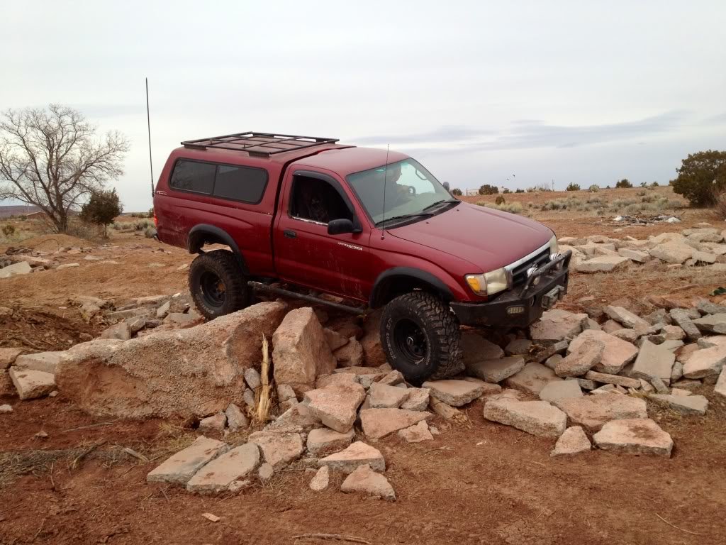

    In this spot with my IFS, I would get hung up on my passenger side. Now the tire hits and with a lock-right in the rear in 2wd I was able to go up and over.
    052409EE-262A-4941-BF68-E5EFB5DCEE61-219_a722729b30a3b42ada72eba0d3ea9959c07f1e05.jpg
    4AE11CAE-42B8-49CB-BFD8-A2831092C2D1-219_a5224dfc19cd456e83a5385fbb2a0322ecf8a345.jpg
    B426F7DA-C67B-422F-8B00-CC164110AFD8-219_3563ff6a4daecf1465d63eabe358107b8ae22579.jpg
    43CB66DA-1175-4B46-9E55-20D0ECC5773E-219_b28b500ac7072c3f299332479e9874d4fd9bbf4a.jpg

    Just like most people say: you gotta relearn how to drive the truck. It handles differently and I gotta get used to the turning radius. Just a little wider that I was used to.

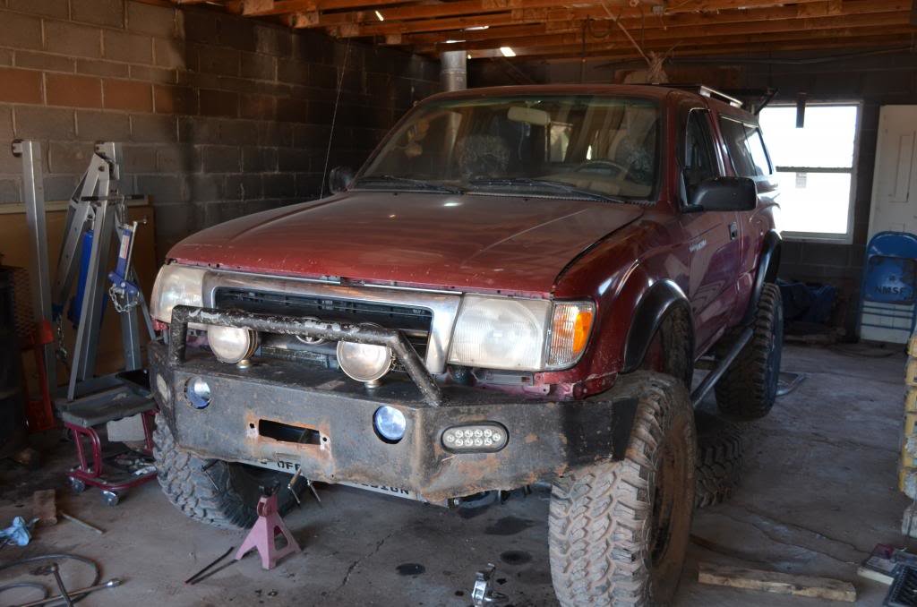

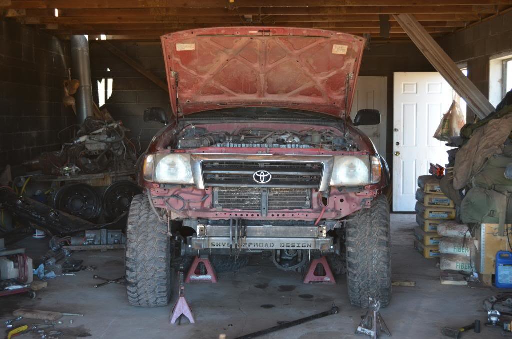

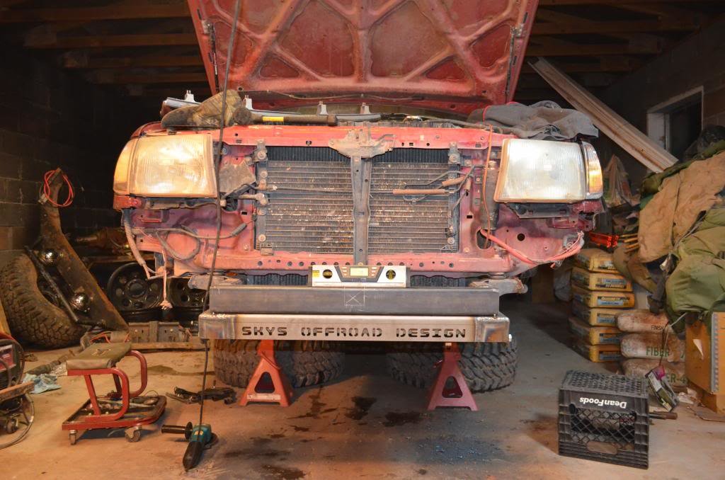

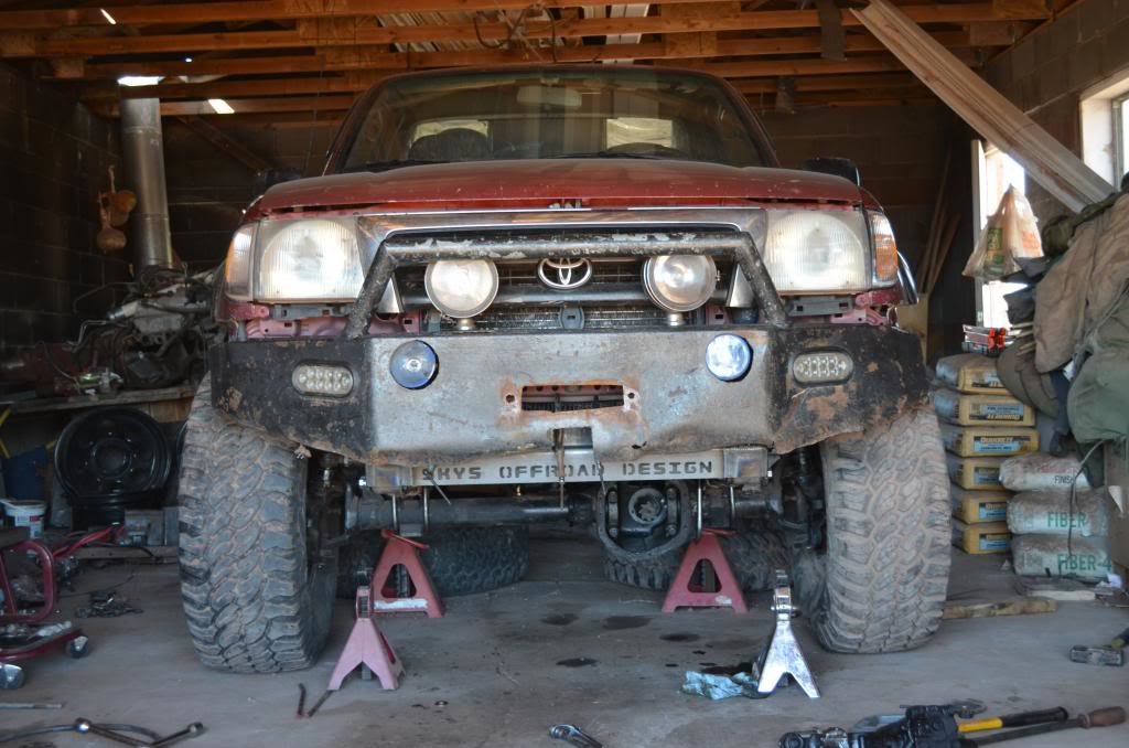

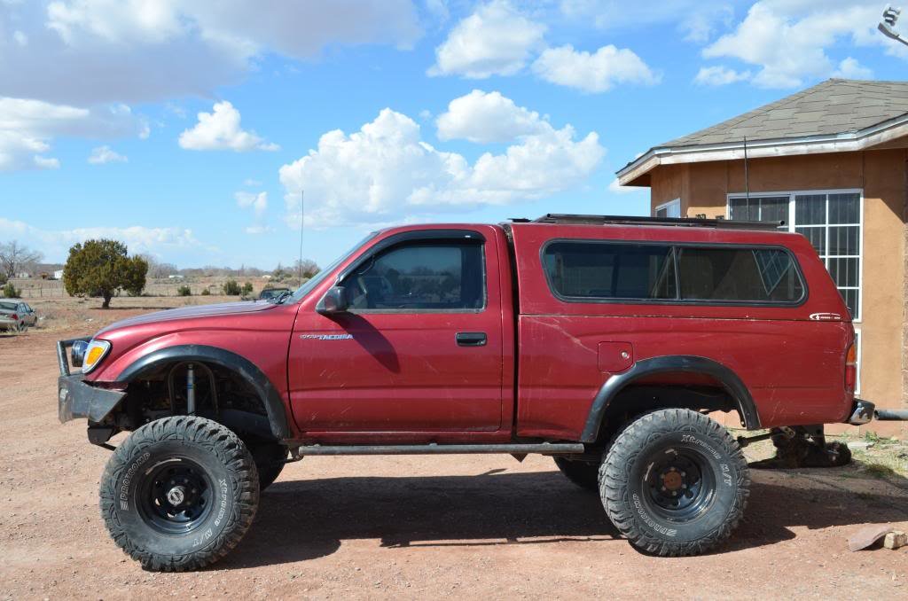

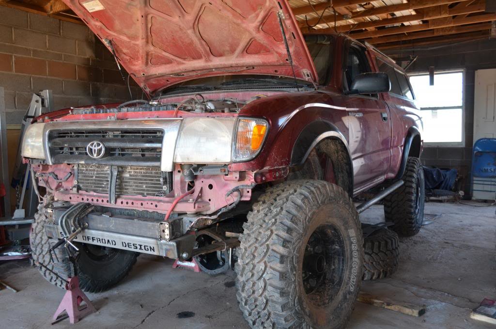

    Sitting on jack stands. Decided to mock up the front hanger.
    Point of some return
    Did a rough cut then got closer with the torch for minimal grinding.
    I ended up with a pile of parts and scrap metal
    The grinding
    We were here in no time.
    Hanger mock up

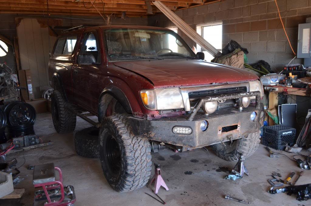

    Approximate ride height with Jeep YJ springs and Taco 3" lift add-a-leaf
    Sitting on its own weight
    Front bumper mock up

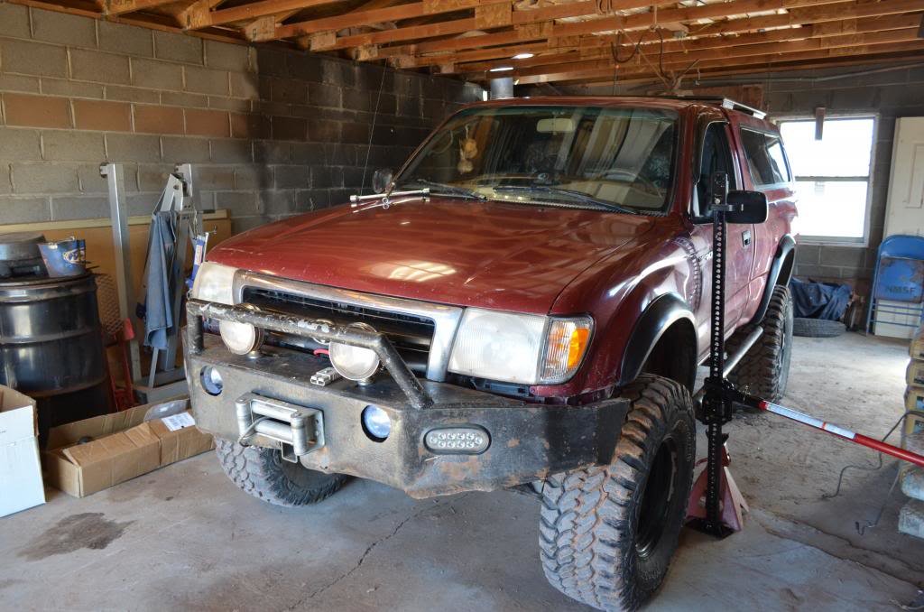

    Finished product with Rubicon Express 2.5" leaves
    Now I need to break in the springs and move my rear leaf shackle hanger to about 45* to help lift up the rear end.

    Awesome! I see you still have an offroad light out. lol

    Lol. Yeah that was on the back burner since Moab last year.

    Looks goo man what's your frame height? It looks pretty low for a leaf setup :cool:

    Was at 21" with the YJ leaf setup. Not sure now.
