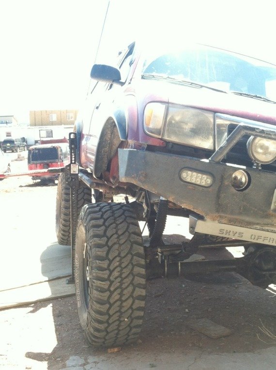

    Used a 4' hi lift and wanted to see how far my tires went down

    looks like you need a 60":D

    I have a 60" :D. It was just on my rack I made for my camper. The 48" is for my work truck and was near the truck.

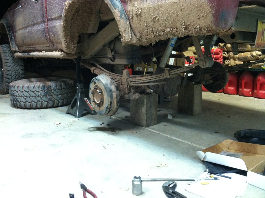

    So my rear end is up once again... This time it isn't due to a lunchbox locker install :spy:
    My truck decided it wanted to sit on blocks because my rear leaves would flex and would still be sitting on the jack even with the jack stands fully extended.

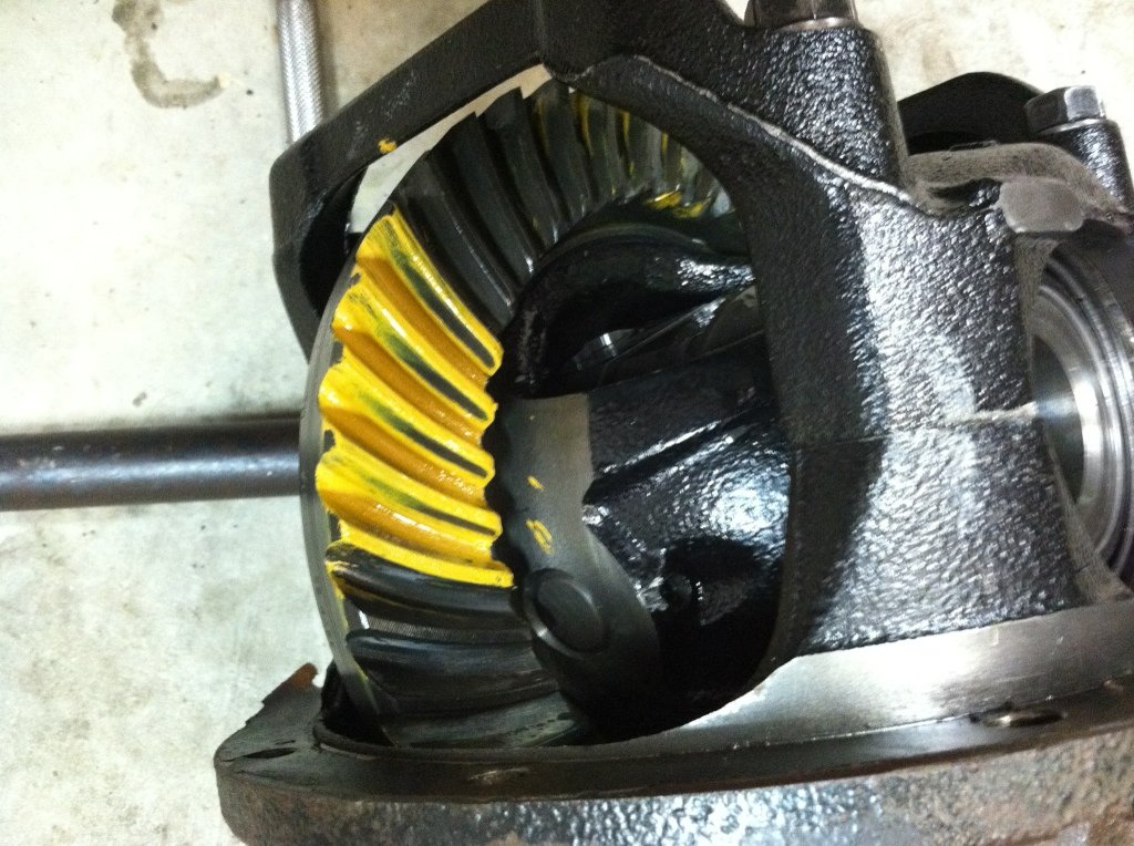

    BIG thanks to Slodgetto and Ripcord for helping on this endeavor.
    Finally got around to installing my 4.88s with some much needed help.
    Took us several hours to knock this out (we got lucky) which was pretty good considering Slodgetto took several days to regear his diffs.
    The patterns.
    Drive...

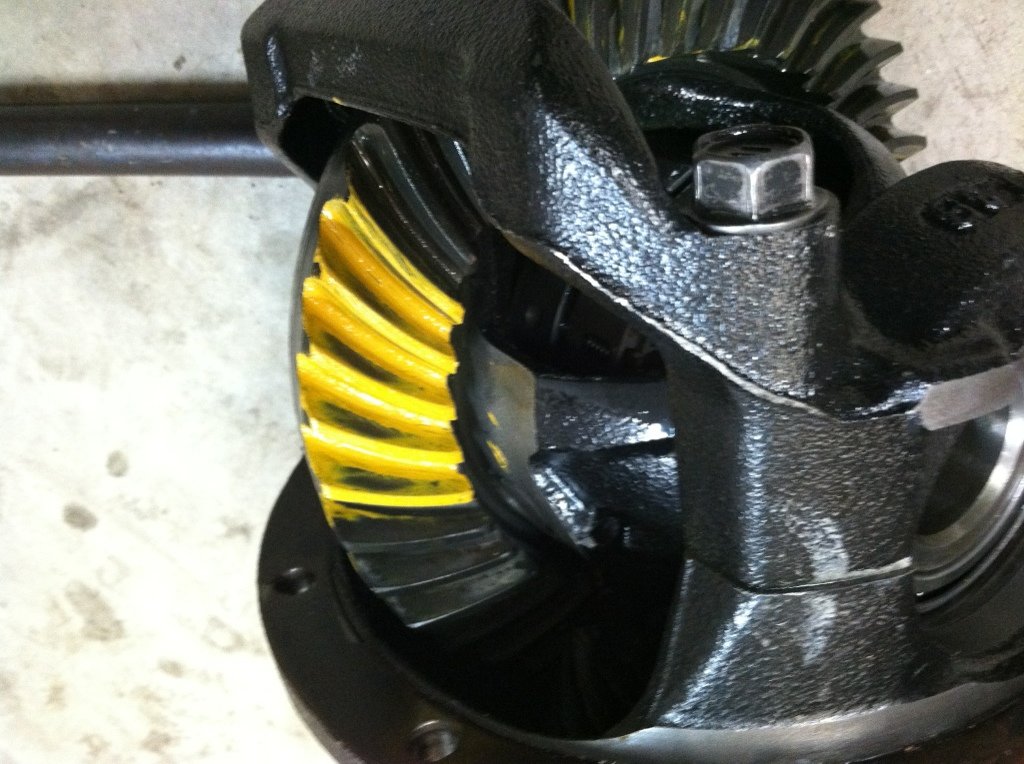

    Coast...

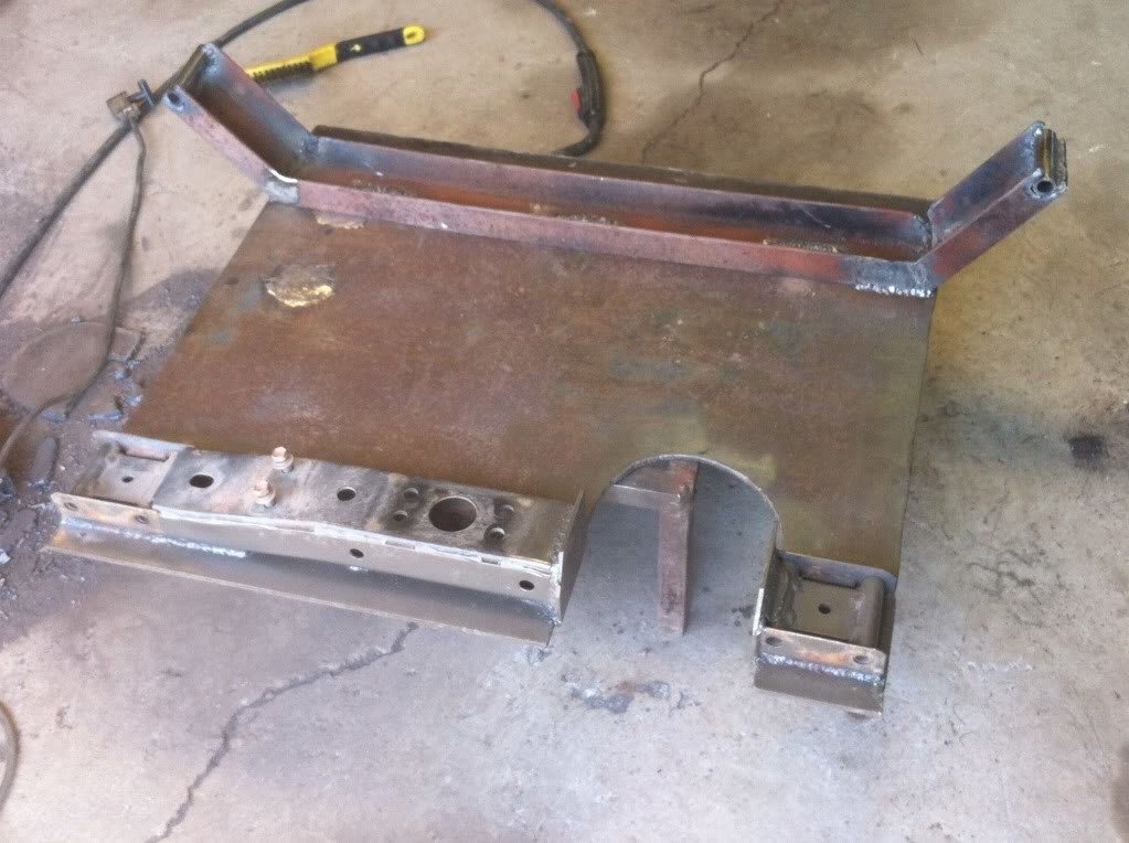

    Making my skid plate/belly pan so I can finally make my driveshaft.
    D55CFDC8-6037-4DE9-A1D8-EF86ADB599DD-272_6cbe6404ca850b427fc5436b8df5e215d5ecb8f5.jpg
    1/4" plate with supports :cool:
    Still need to put support for overkill factor. I've got some 2"x2"x1/4" angle for a center brace and thinking about 1x1x1/8" angle for the sides.
    I just need to go and get more welding wire. :(
