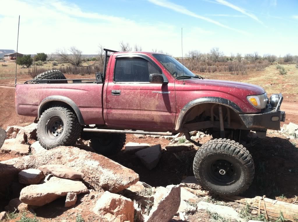

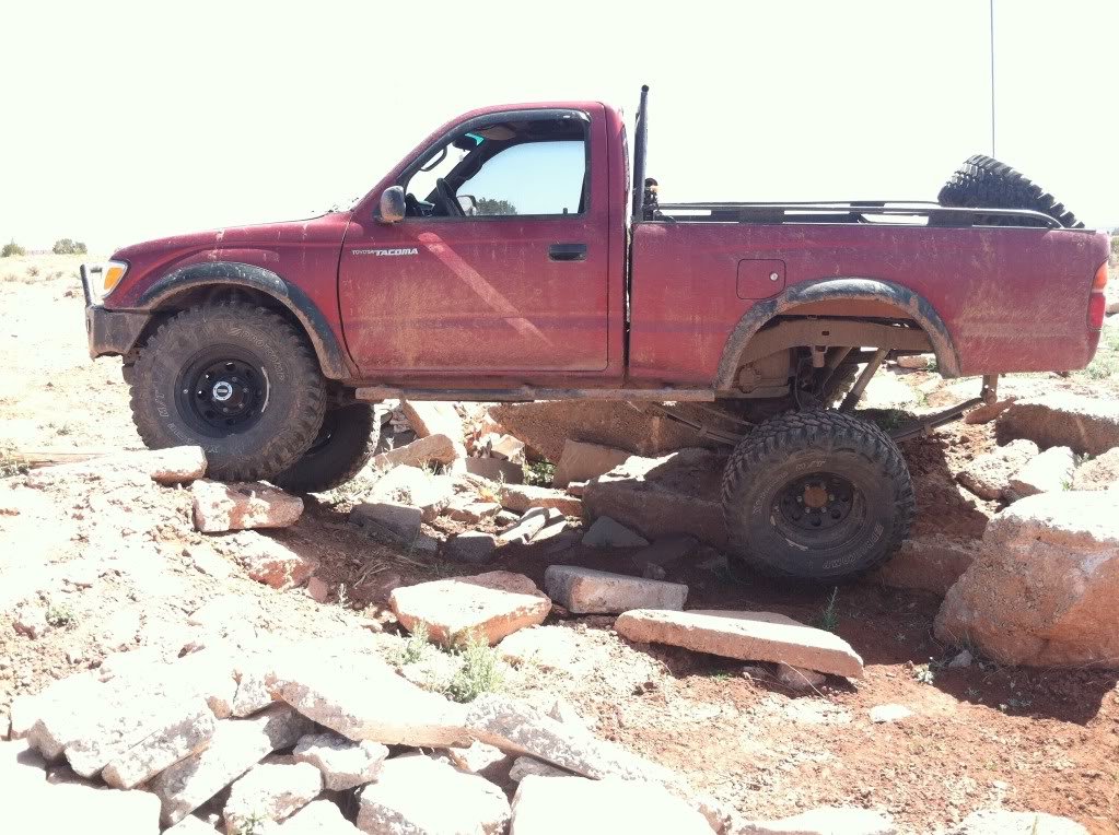

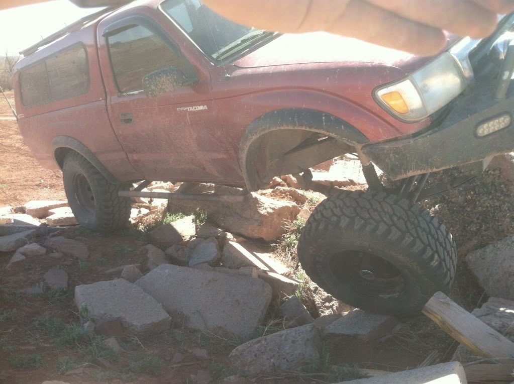

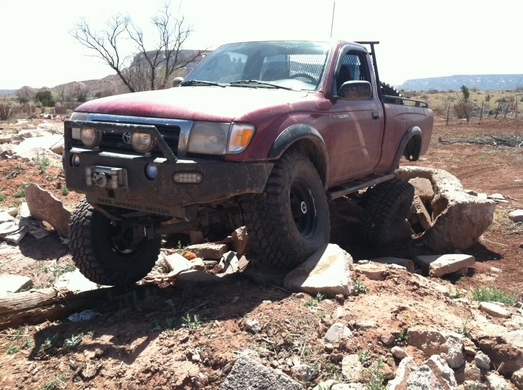

    Tested out the stock DS stuffing the driver side.
    FAAF4F32-0135-4946-90B8-1BCAA031843B-272_f34dc8627a234735dff07b8bafaba350b96688b9.jpg
    696FAE17-77E5-45CD-B332-171DE44ED0F8-272_b52875a36f3a808c3440dddfed513aea3fbdf09e.jpg
    0EAC2550-891D-4768-A9AA-B521B4A543E6-272_52b0ff3532086fd8ff6a5eb4f8b6c520a2631b3a.jpg
    Didn't test out the passenger side stuff didn't want my DS sliding apart :laugh:

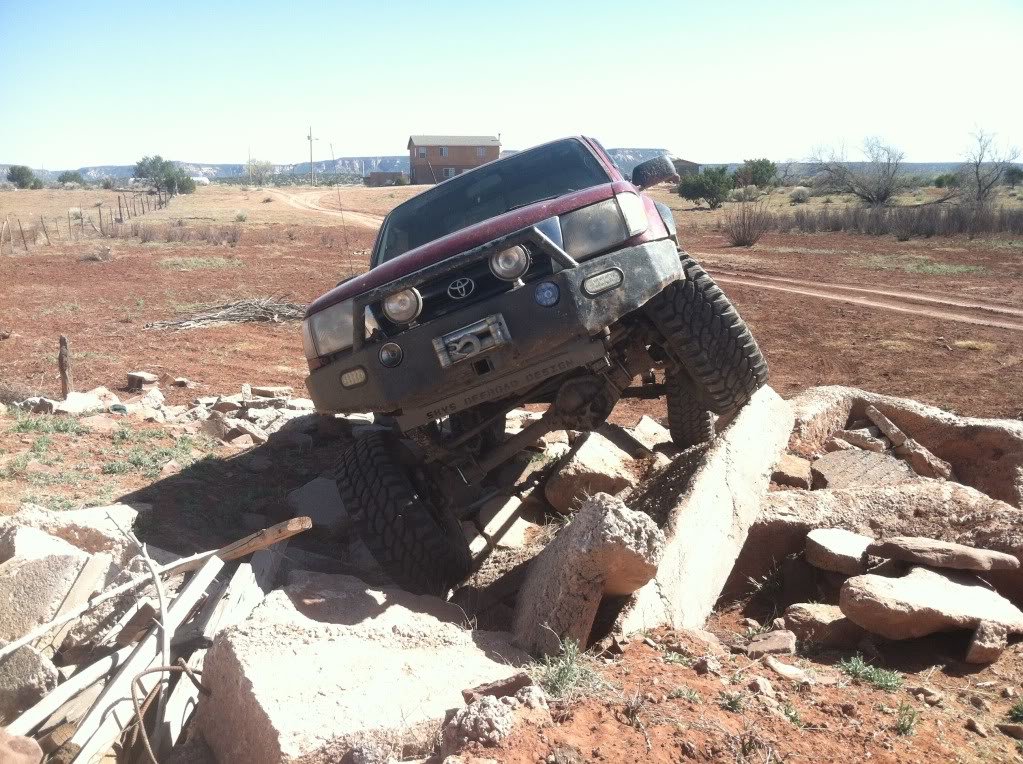

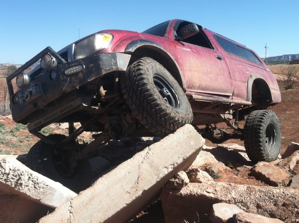

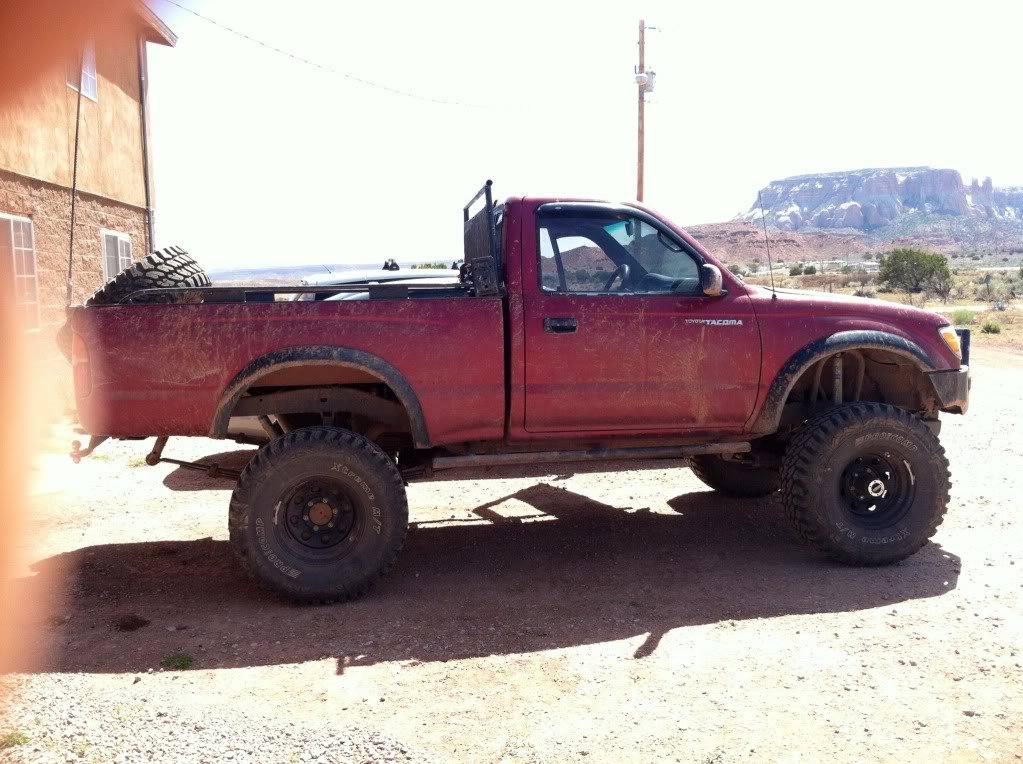

    Got bored. Still need to bend up the rear edge of my belly pan.
    How its sitting now.
    FD745E62-4CAB-4E04-A3E4-C87FEB08E001-105_a54bbf276b545f83cb9770292e29fc02de4e8f06.jpg
    A little flexing.
    400DF97D-93EE-4F5C-8E35-A3B0F6AA9D95-105_2d572276c6be26d8ef70fe0bf6b33c175f7d4a6f.jpg
    6B8F206C-B2E0-4AD5-BF89-7A139B4DE201-105_8cd9b59bcb416725238d796bc5dedf6a0c35b1de.jpg
    8063E537-3371-4785-9861-38AE836DDF69-105_cfe934682a73e30c40bcfe877dd4e035bccff31f.jpg

    Nice!! Does your front driveshaft come apart if the other side droops like that?
  7. May 4, 2013 at 5:00 PM

    dam, that thing articulates great! awesome job!

    It fell apart just drooping a few inches. :anonymous:
    So I welded up the extended splined add-on from trail gear which I still need to flex out to see how it does. :cool: when I do I'll post pics.
    Btw... The 1/4" belly pan isn't moving even when I kinda slammed down near the edge. Still might reinforce it with the 1x1x1/8" angle whenever I get it. No rush on that.

    lol That a lot of droop!

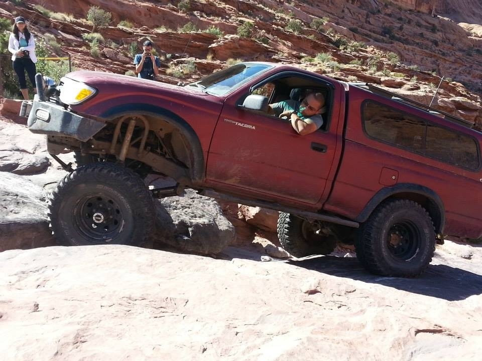

    Stolen from Ripcord's photobucket.
    On the Devils crack on the Moab Rim trail

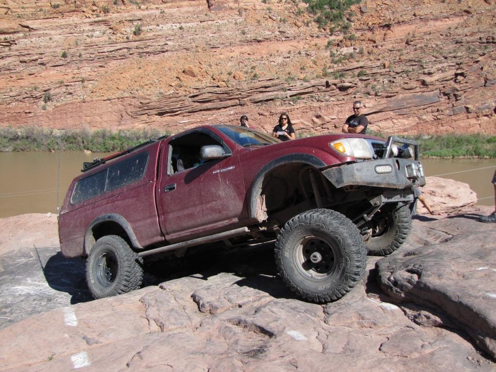

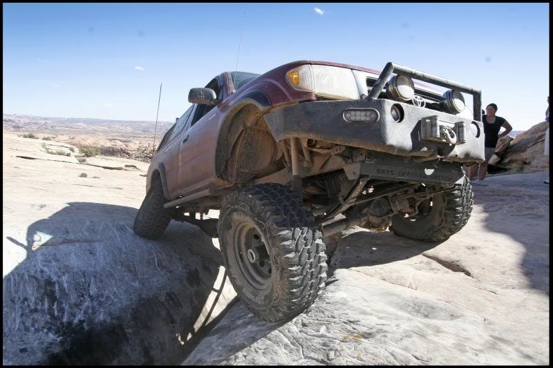

    From Low Range Offroads Facebook

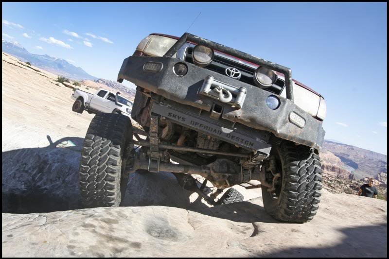

    From Box Rocket's photos
