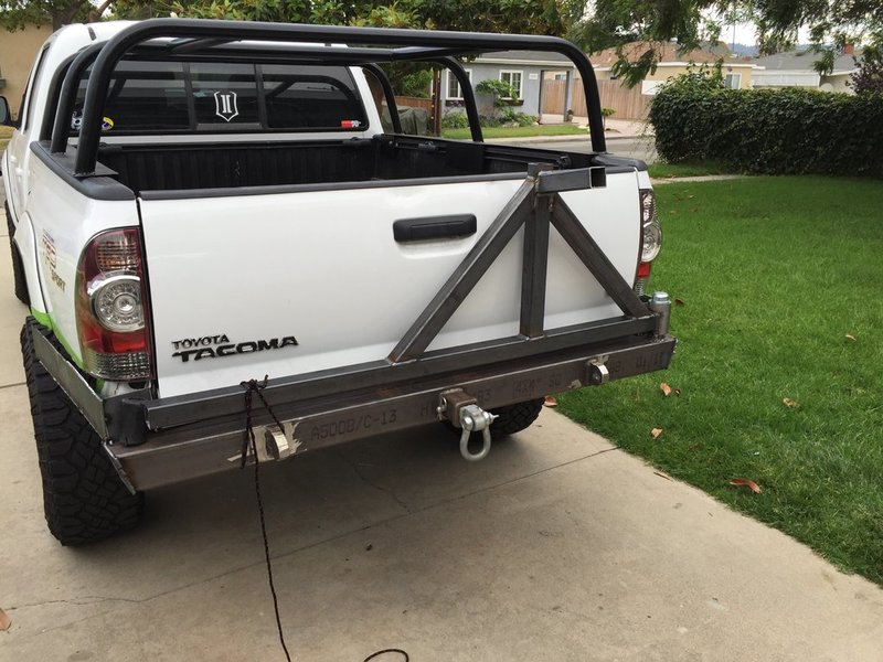

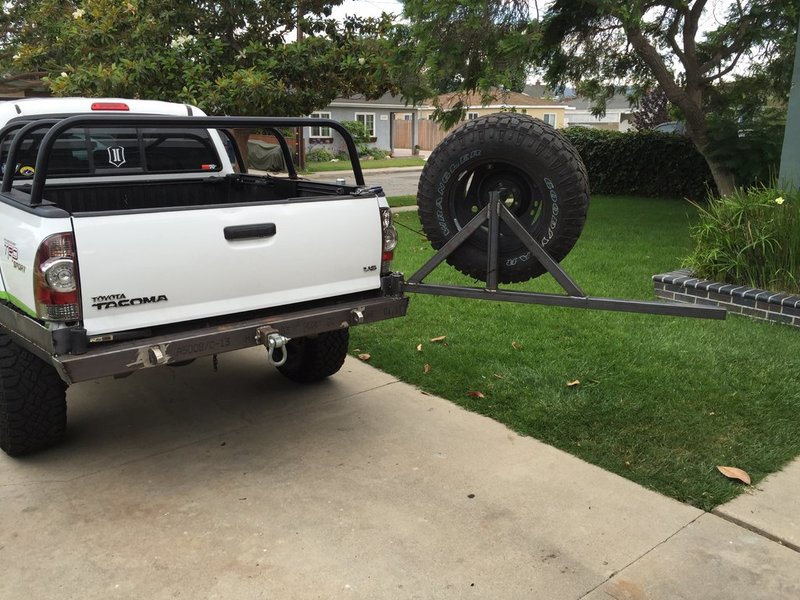

    Thanks Brian!! I really appreciate that. There is gonna be a lot of finish work but I think it will come out how I want it so I'm stoked on that. I ate some inn n out for lunch and got back to work and built the whole swing out. I'm pretty stoked about it!

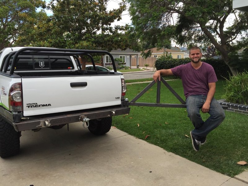

    LOL Love the photo of you sitting on it.

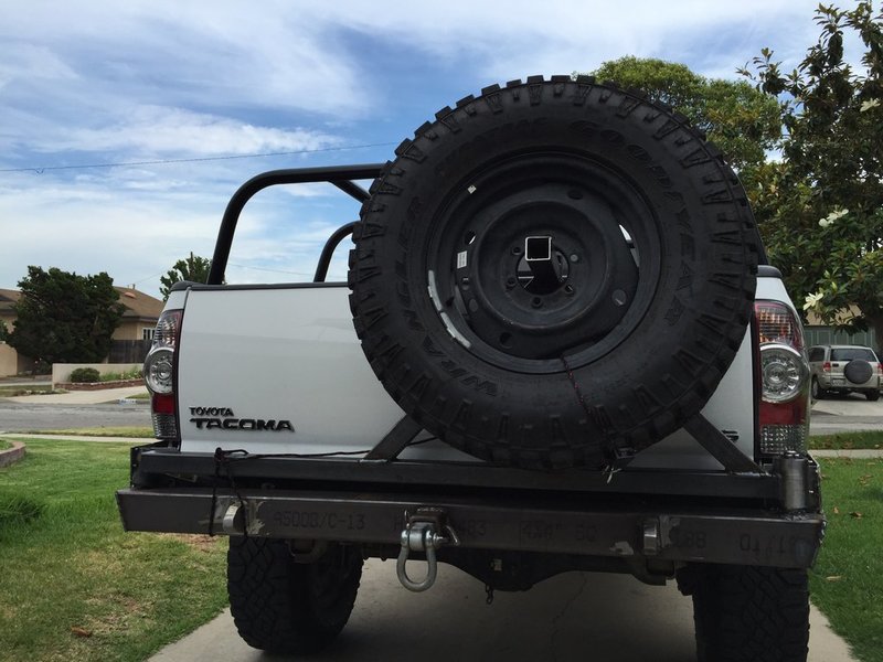

    Curious how you plan to secure the spare tire/wheel? You going to just drive a cotter pin through the steel tube?

    Haha thanks man. I wanted my wife to sit on it cuz she's way better looking than I am but she didn't want to haha. I was stoked how beefy that spindle is. The arm didn't even deflect at all with me sitting on it. And I weigh more than a tank of gas and a spare tire.
    So I just wanted to see how it looked with a tire up there haha. What im gonna do is cut out a circle from 3/16" plate that I have and match the lug pattern of the wheel and drill the holes and weld in grade 8 bolts. Then I'm gonna weld the circular plate to the end of where the tire holder part is and then I'll secure it with some nuts. I'm gonna cut out another piece of 3/16" plate and gusset it under there for piece of mind for the tire holder part.

    Smart. Wonder if you can match the thread used on the truck? Could find some locking lug nuts so nobody can steal your spare?

    Yeah dude that's a good idea! Thanks! I have pro comp lugs on my method wheels and it's a special socket to unbolt them. I could get lugs like those so that nobody can jack me haha

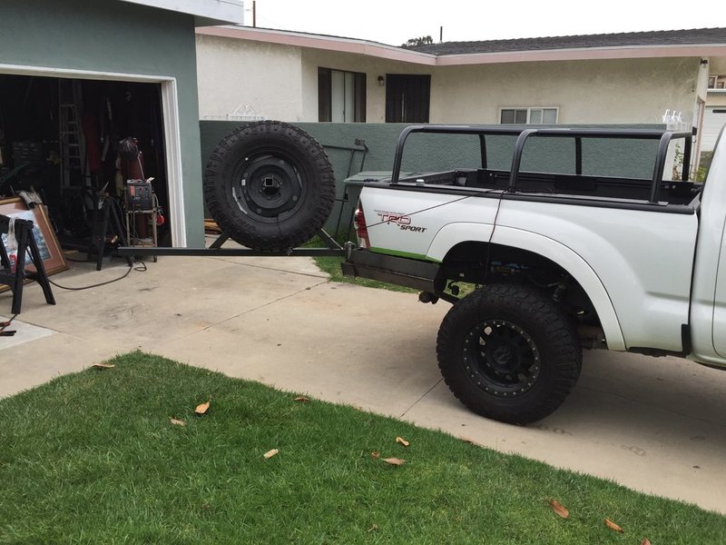

    Hahaha that's my garage for you! I had it out towards the front of the garage cuz a dude came to buy a fridge, that picture, and a couple of mirrors from me last night.

    Hey Ryan, just another idea is go to a junk yard and take a hub off a wrecked taco. Already has the studs and bolt pattern, then weld that on. A little more work but just another thought

    i had thought about using the inside of one of my old rotors if/when i do a tire carrier another thought if u or someone u know has just done brakes or maybe work at brake place

    Got the latch welded on and started making a Jerry can holder. Got the base of that welded on.
