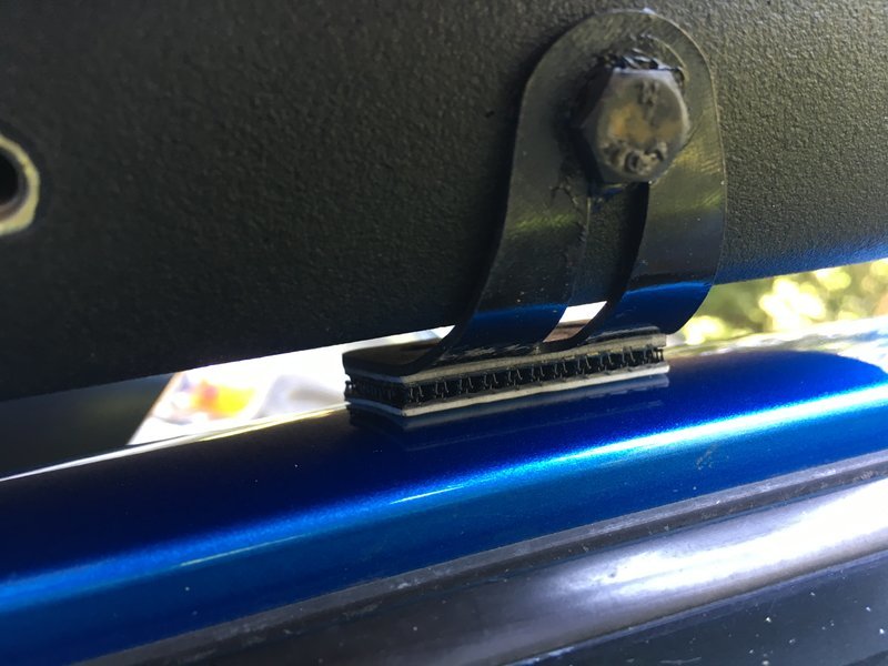

    Velcro, or VHB will do it in most cases. I wouldn't put holes in no pillahs.[​IMG]

    Don’t go drilling holes in your A pillar OP. You can find this industrial Velcro at Home Depot. It will be fine to use the truck to drive there with it loose till you get it. Just leave the bracket off for the pillar so it doesn’t scratch the truck.
    @Taco Stallion
    When you’re working on something like that in the future remember to grab a spring loaded punch to have something for the bit to start in and not wander.
