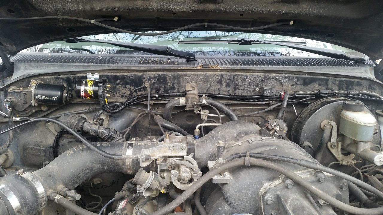

    Trd S\C with nosecone hybrid bearing upgrade kit. 2.0 urd pulley, 7th injector kit-urd "6 fabtech lift with 3" body lift. 20" XD spy wheels with toyo open country r\t's in 37"x 12.50x20. Front and rear diffs re-geared to 4.88 dirty 30 drive axles. and a rhino pack clutch. Custom exhaust and huge mudflaps!

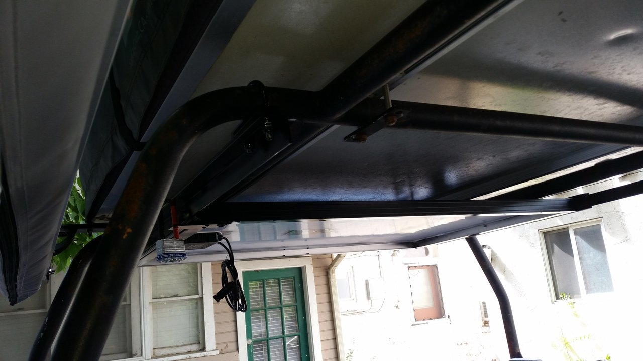

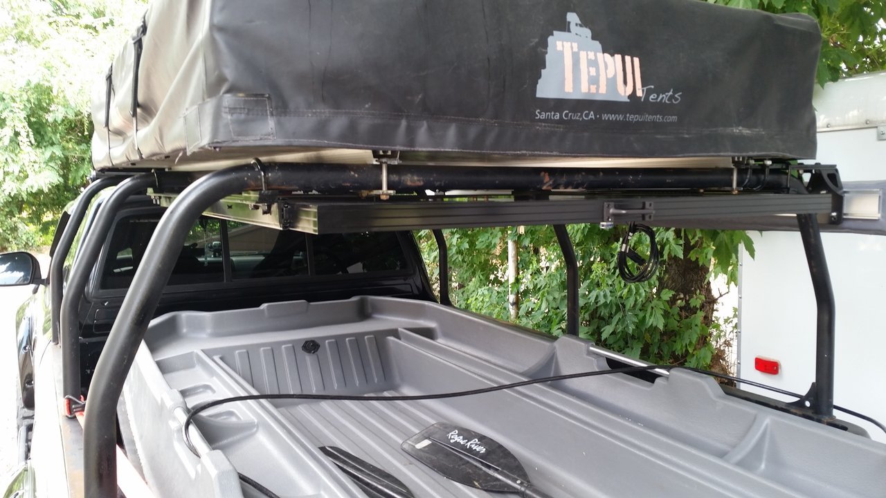

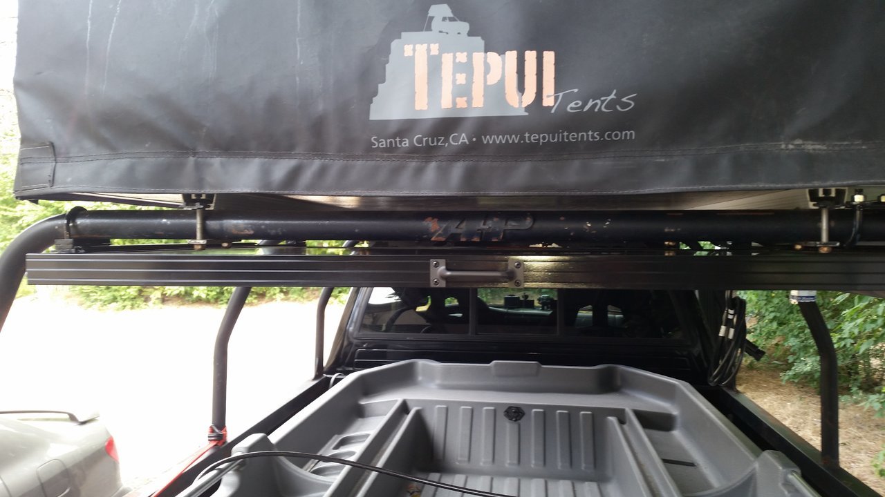

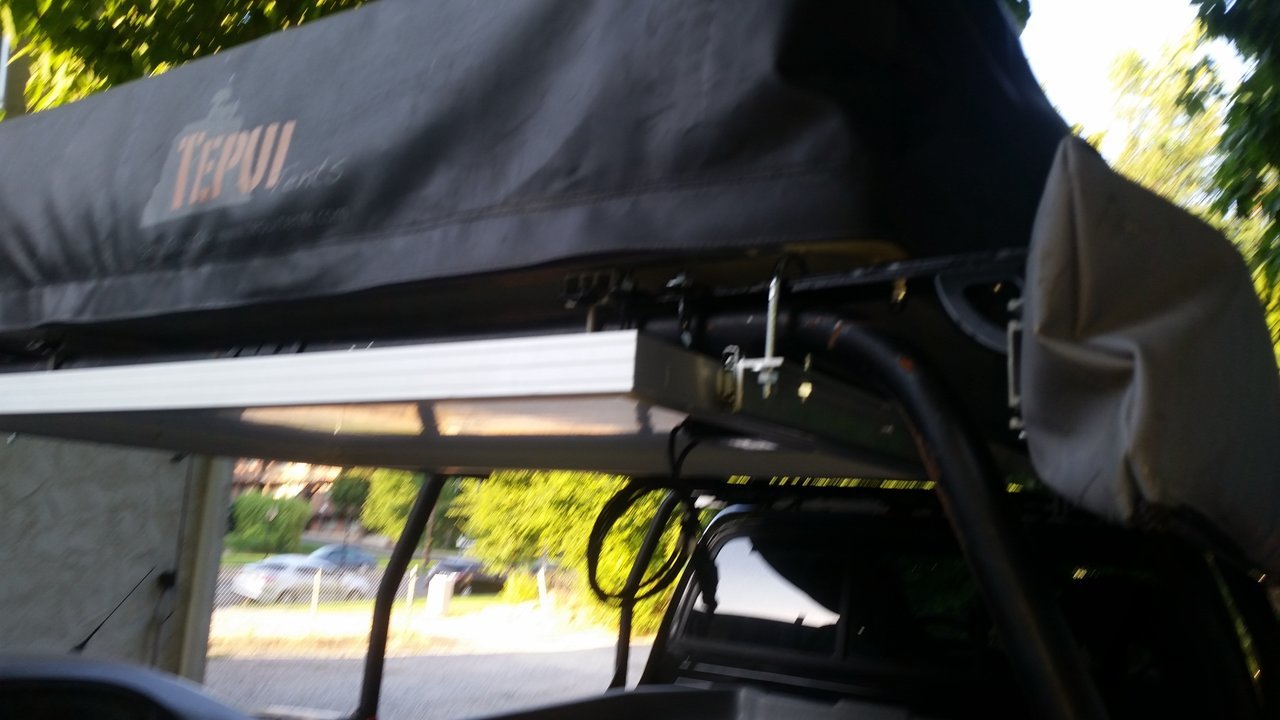

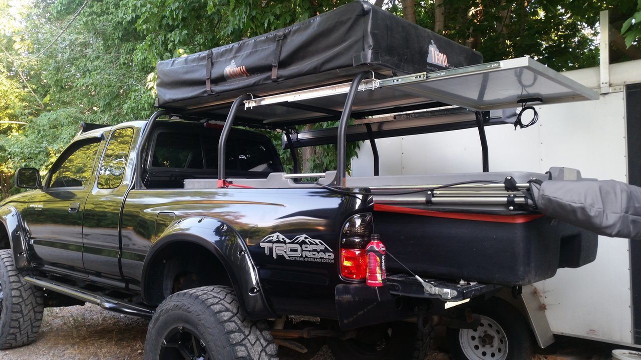

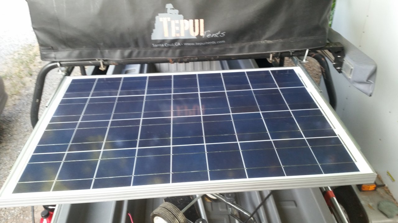

    Well i have already made the jump to dual battery a couple years ago and also a power inverter and isolator system for charging my battery's when driving. Now i went further and enhanced my system to include a solar back up so when the truck is not running or just sitting around it can charge both batteries off the solar panel. This is my starter test set up. I am thinking of running 2 panels at around 200-250 watts. But currently i have just one panel installed. This mod is almost complete. I had to fabricate all the mounting hardware and parts to make this happen. I used.........

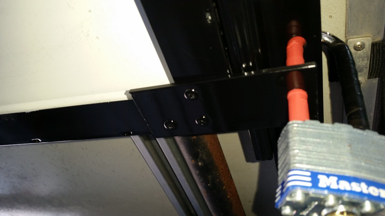

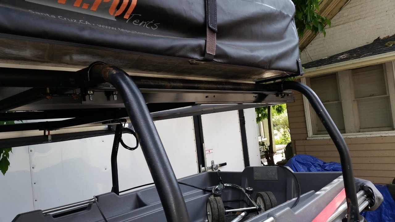

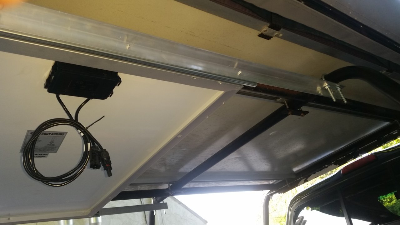

    1x gennsi solar panel 100 watt with a 30 amp max 400 watt controller. $129.
    1x angle aluminum 1"x 1.5" 1/4" x 96" home depot $15.00
    1x aluminum flat stock 1"x 1/2" ace hardware $15.00
    3x u bolts 8x nylock nuts ace hardware $3.99 each
    1x square u-bolt $3.99
    5/32nds x 1" aluminum pop rivet with steel shank. home depot $6.99 (I already have a rivet gun)

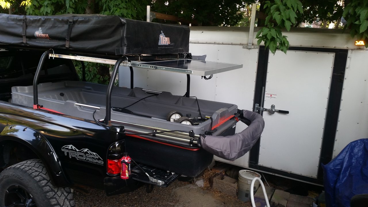

    1x set of 100lb rated drawer rollers to retracted it under the tent. Next is a hydrolic strong arm and a pin so i can pull the pin and it will self deploy!
    1x set of red\blk solar 10 gauge AW wire solar extension with connectors attached fleabay $25.00
    1x 4CT (2 piece set) solar quick connector d.i.y. kit fleabay $6.99
    1x 10 gauge 4ct connector pigtail to attach to battery so solar connector extension can quick connect and dis-connect easily. fleabay $6.99
    2x cans of krylon black satin spray paint. Ace hardware $6.99 each.

    Thats awesome! I'm hooing to do somethung like this down the road. Where did you find the drawer rollers? I seem to find crap or crazy expensive ones!
    Most important, how you liking it?

    I like the set up but i really think i might go 2 panels and linear rollers. This is a test run so well see how i like it so far but the rollers are pretty nice and sturdy. I do put a snow blower up there in the winter and mountain bikes but they have seats that lower or come off. I used a pad lock to keep the panel from rolling out and secure it for travel. I wish i could some how mount a ERGO-TRON mount to the panel so that once it rolls out you could angle the panel any way you wanted to catch the sun better but it would be bulky.

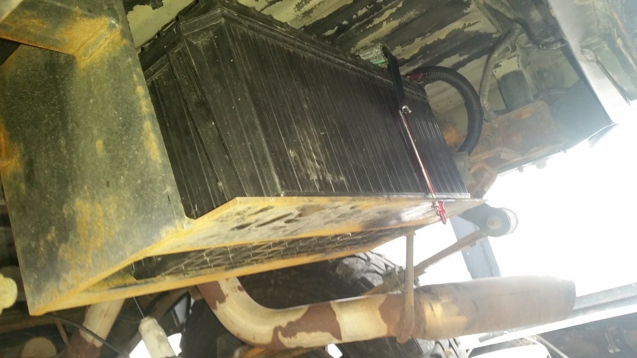

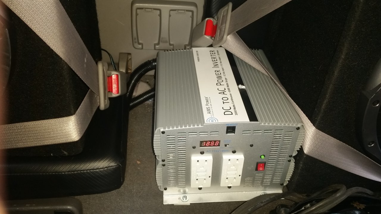

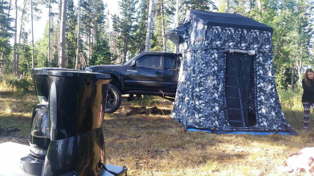

    This all started with a coffee maker...........The WIFE MUST HAVE COFFEE. percolators were out of the question the wife must have coffee french press meh. So after a couple of camping trips and the wife forgetting the cables to hook the inverter up to a battery or something else. One time i had to hold the inverter directly on the battery to make coffee. So i always overdo things and this is what happened. And i actually do run a chainsaw off this inverter and all kinds of stuff. I have a tiny shop vac made by bulldog i take for clean up. It's a wet and dry mini. I have the mini bass boat that fits in the back and man i've got that boat in some small lakes with a transom mounted dolly. I like music a lot so i have crazy loud speakers and they suck power like crazy. I HATE GENERATORS AND TRAILERS!! But i like having a\c power on board so my trucks possibility's are wide open. chainsaw,coffee maker, small heater when its cold or the heated blanket. I like the outdoors more than the wife but this way i can get her and the dogs to some remote locations in comfort......See house electric heaters make no poisonous gas so many advantages to power on board. I like to be able to charge my mini bass boat trolling deepcycle battery, My Cell phones,wireless speaker for campfire music that doesn't blow the neighbors out like my other speaker system. Some times i take my Drones out camping and fly them with my fat-shark goggles for hours so i really need power for when im out for days and days if i stay a long time its nice. Next were gonna go watch old home movies in the woods with the old-school family projector and then scary movies with the mini projector and friends. There is something so fun about watching scary horror movies in the middle of no-where. ok ill only list the major parts for the battery mod
    Aims power modified sine-wave inverter. I don't run flat screen tvs or laptops off the power supply so i don't need that clean of a power source so modified inverter it is.
    1. Inverter w\gfi outlets my model has 4 sockets and was $439 butthis is very close.
    http://www.aimscorp.net/3000-watt-power-inverter-gfci-etl-certified.html
    2. Interstate srd4 deep-cycle rv battery
    http://www.wnybatteries.com/index.php?main_page=product_info&products_id=321
    3. stinger Isolator for charging 2 battery's on 1 alternator. also allows discharge of auxiliary battery and not vehicle primary operating battery.
    https://www.amazon.com/Stinger-SGP3...r=8-1&keywords=stinger+battery+isolator+relay
    4. 28 feet of AWG 0 gauge arc welding cable for maximum voltage from battery to inverter for best quality power and flow delivery from inverter to powered device.
    https://www.amazon.com/dp/B016HFD5G2?ref_=ams_ad_dp_asin_3

    I have been thinking about doing a solar panel on my truck for so time. Struggledwith how to mount it. Thank you, of the idea of using drawer slides. Your set up is awesome! :thumbsup:

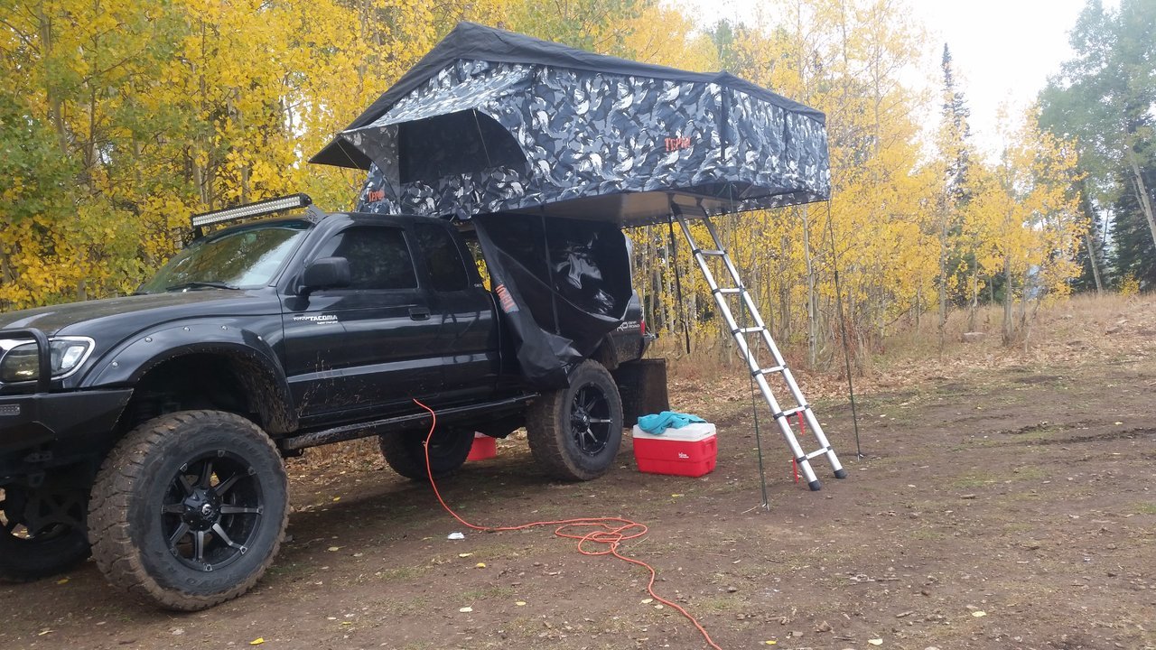

    Thanks a lot guys for the compliments! I have spent hours thinking of how to do these things. Sometimes i just go and hang with the truck and climb on it and hang on it off it and under it and THINK. I have seen some bad solar mounts on trucks where people drill the roof and weird stuff. and i wanted a clean economic way of doing this. This is the easiest way i could come up with to do this. I did have a bunch of tools to do this with. Drill press. bench,grinder, Cordless drill, saws all, pop rivet gun. spray paint. I do all my own work when i can.
