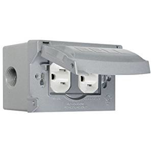

    Next project is setting up 1 or 2 external waterproof sockets so i can simply open one and plug in around the truck for external power. I was thinking something like this.

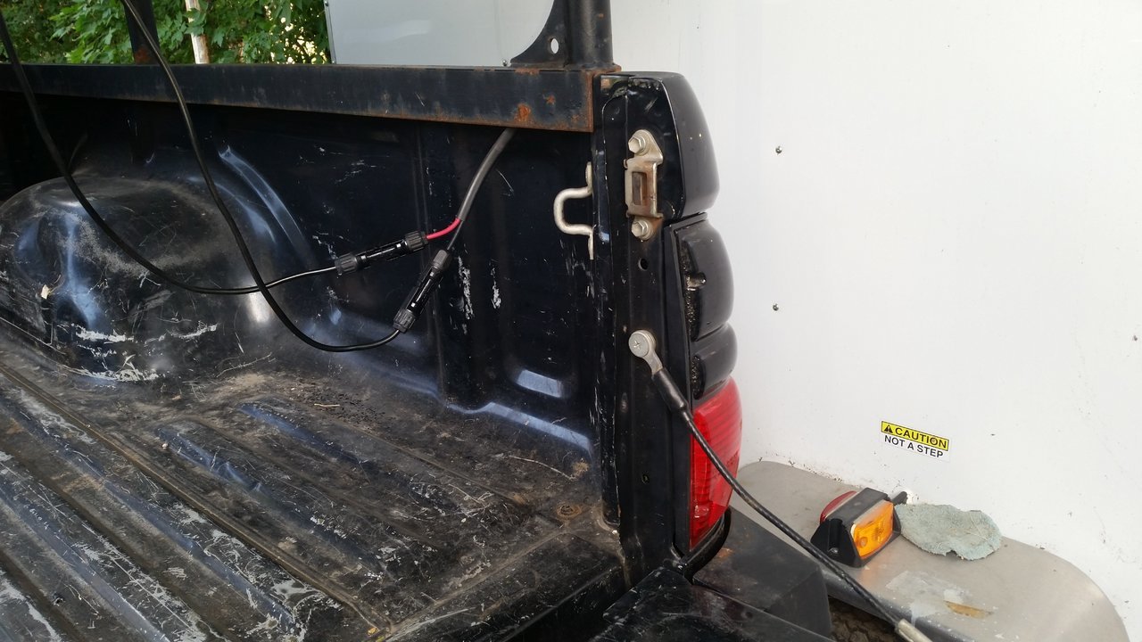

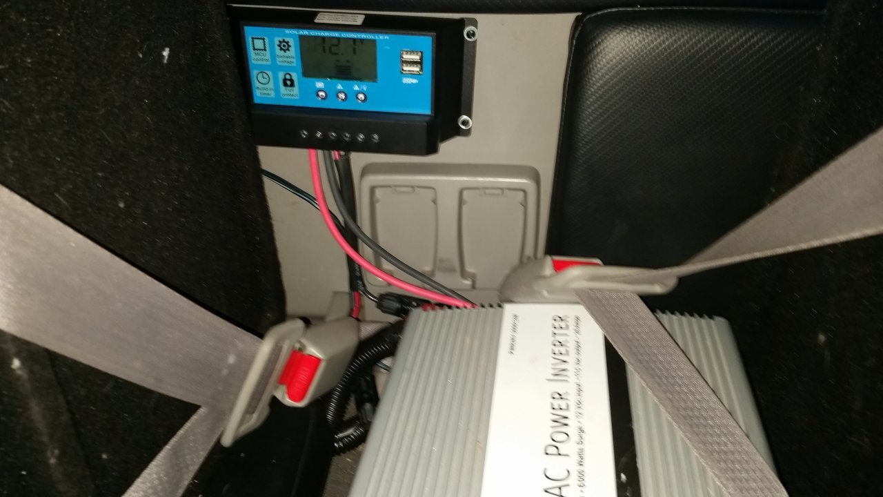

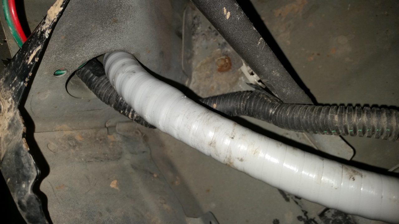

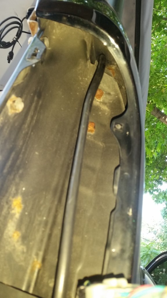

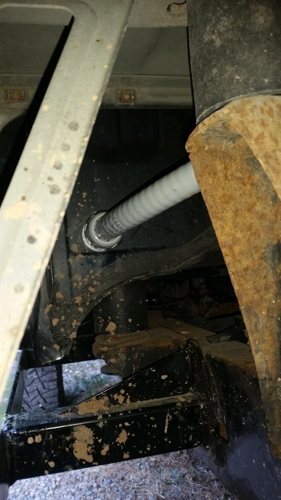

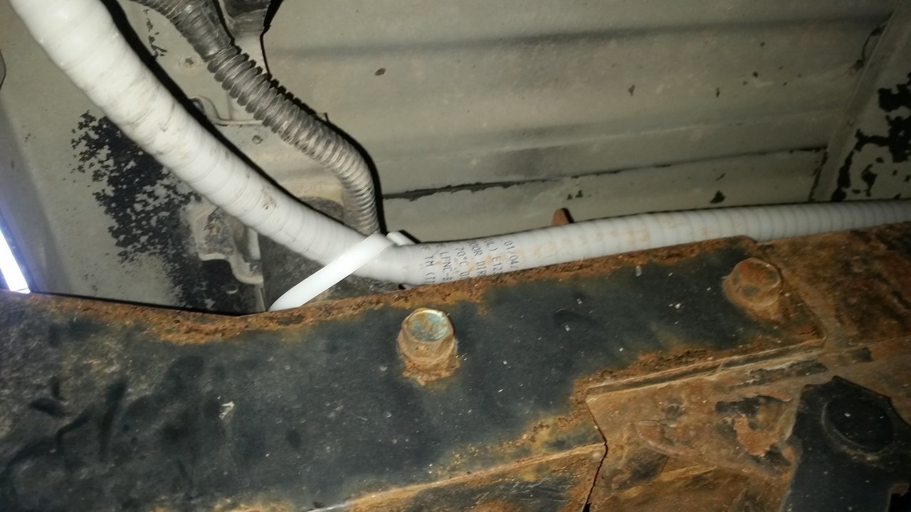

    UPDATE: Ok got a bunch done. I wired up 2 external sockets and a junction box see this thread:https://www.tacomaworld.com/threads/waterproof-dual-external-plug-sockets-mod.505741/
    Then i had 1 more 6 foot section of liquid tough brand conduit which i returned for a 3/4" 6 foot conduit whip. Then i went back into the junction box and undid 2 of the conduit connections.Then I ran an 16' section of underground (meant to be buried) 10gauge solar panel wire. I used a small hole saw behind the taillight. You can sneak a wire up inside above the taillight and over the metal brace inside to the bed rail underneath with no drilling. Then i inserted a 90 degree conduit elbow into that hole and attached it with the nut washer. I then ran it down the inside of the taillight bed corner area with the wire inside of it also and back to the 4th hole in the round junction box. then i removed the wiring into the cab and i swapped the main wire conduit for the 3/4" tube so i could run the original flexible cable and the solar power cables back through the same conduit and into the cab. Then i mounted the charge controller up on the back extra cab with tiny threaded riv-serts but below the passenger back cushions. Then i made a small pig tail with the exact dimensions of the placement of the existing parts and then i attached solar panel quick connectors so i can disconnect the battery if the truck sits where there is no sun so it will not parasitic drain running the charge controller without solar input. Then i made a second pigtail and connected the solar wires under the passenger seat with the extra solar quick connectors i had left so i can disconnect quickly. Im running a 40A charge controller and 30 amp panel in case i go bigger later. It was another fun mod but harder than you would think. It's so simple in your mind but can take hours to come full circle from idea to reality. Pics to see what i did................
