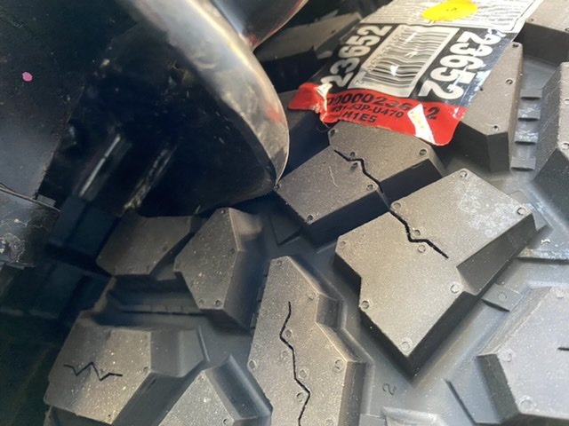

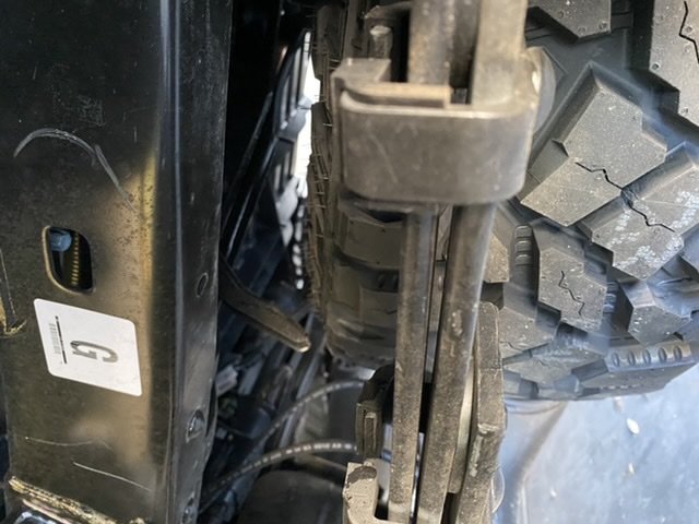

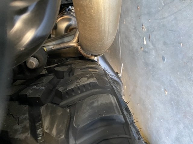

    64829FBE-BA50-46C4-AB34-633BD1AF8158.jpg ED2BA7D6-065B-443E-8FA7-7696E803FB1F.jpg 564AE551-34EC-4840-83C6-F9C8002C7FDC.jpg Yea this looks rough... thoughts ?
    285/70/17 STT Pro

    You hammered the tabs back right? Mine barely fits as well, is pretty much touching the exhaust heat shield

    I didn’t hammer anything but I’m about to lmao

    yep hammer those tabs back

    careful with the tire being that close to the exhaust, the heat can/will melt the rubber over time especially if it rubs it. The exhaust is on hangars and moves around some
