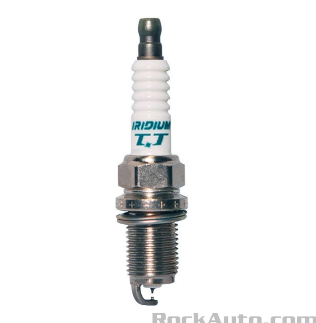

    So I bought my 1st gen at 164k miles 4 weeks ago and knew I was going to tackle the regular maintenance one by one starting with the spark plugs.
    Well, a week after I put in these plugs (below), my gas mileage went way down, lost a ton of power, and truck began to stall when idling in park.

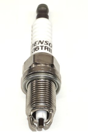

    So I went to Toyota yesterday and asked for OEM plugs from the parts department. Slapped these babies in (below) last night and man what a difference in mpg and performance overall.
    Anyway, I may not have installed the Iridium's properly, but I also read somewhere after the fact that iridium are actually not recommended for the 3.4. But feels good having a much smoother ride now. Thought I'd share

    There's a sticker on there from factory saying only use dual electrode. It probably fell off, pretty sure it's because of the shared coils.

    The ASE guy got it backwards. The twin ground should last longer. The plugs are fired twice per cycle, not just on the ignition/power stroke. Besides that, owners have found better drivabilty and MPG using the Toyota recommended plugs.

    Dont use the Denso TT's in a truck or large suv....
    they are most likely engineered for small direct inject turbo jobs....
    they needed a plug that wears out as fast as the engines.
    Any modern iridium or platinum one spec'd for the truck should do

    Doing this as well, the FSM specifies Denso K16TR11 and O'Reilly carries them. Side note, these were seven bucks + change, wife's Rav4 uses Denso SK16HR11, and they're almost thirteen bucks apiece. Both are Iridium tipped, so it was around $48 for four in the Rav4 and $36 for six in the Taco. Gone are the days of the $20 tune up.
    Inquiring minds want to know where you read that. :p It's in the FSM and the Haynes manual.

    If the K16TR11 are the right plugs for yours, then those Denso iridium TT are not the right gap. The Denso Iridium Power are the ones that meet the spec. I don't know if the gap difference is enough to matter though.

    Iridium plugs will last longer than copper, But it is a less conductive metal.
    I have run them about 100k miles in my Tacoma before it was supercharged, and they looked perfect.
    I went with single-sided iridium for my water, mostly because I like them in my Tacoma, but honestly didn’t realize that the 3.4l plugs were dual ground strap.
    I’m not an engineer, but I would guess that the dual strap in OEM plugs are because as said above, each cylinder sparks twice per cycle, every time the piston is at top dead center, regardless of compression stroke or not.
    Dual grounds will wear slower, Iridium will also wear slower.
