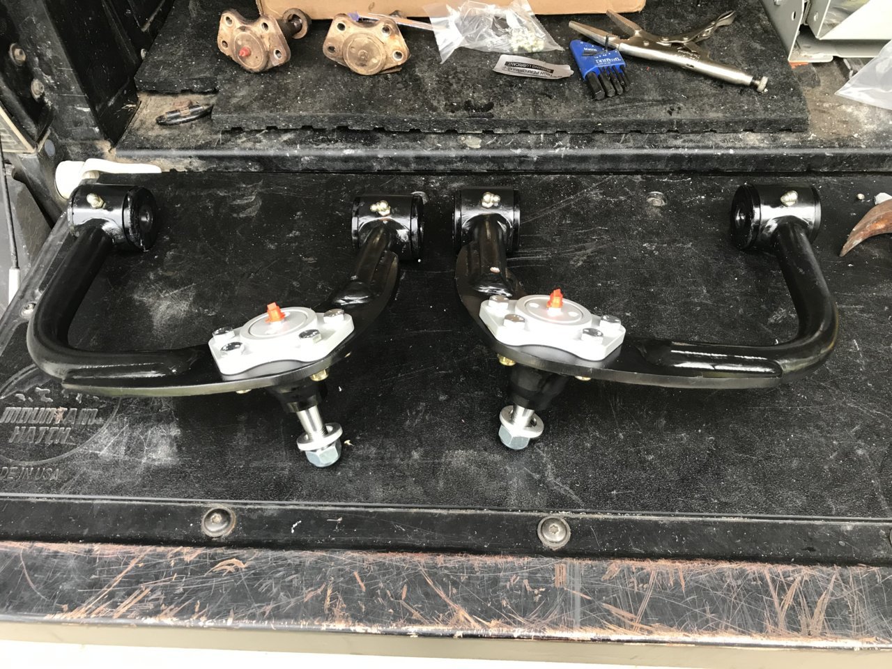

    I love mine. They don't make noise, they ride great, and supposedly more articulation than a uniball.
    Marlin shipped mine bare, and I got them powdercoated black for $60. I thought the yellow and teal of Dobinson's might clash with the red, haha.

    The JBA clean up nice when painted black.
    i wire wheeled off all the powdercoat and rattle canned them.
