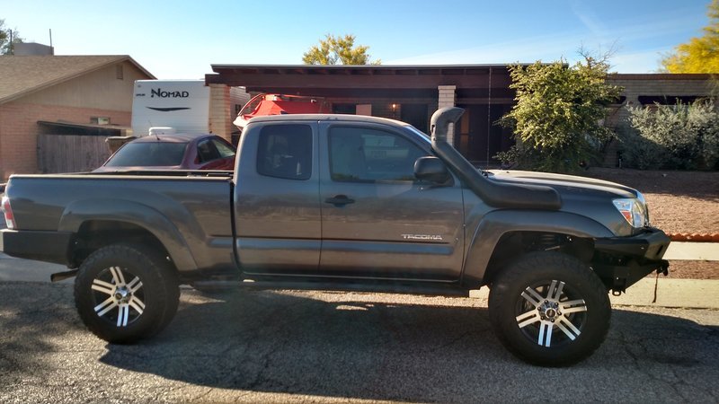

    As it now sits. May, 2015 I picked up my 2015 AC SR5 4x4 in MGM.

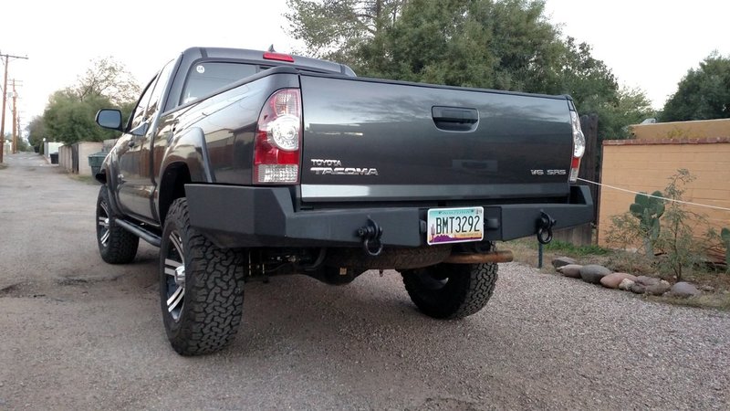

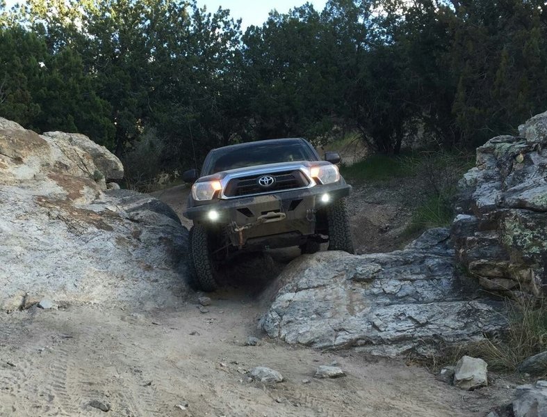

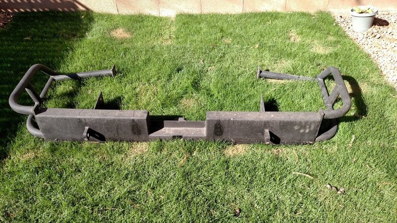

    I finally went with SOS front and rear steel plate bumpers. I added a Warn M8000s in the front and went high clearance in the back. I got to do some more trimming of my bedsides.

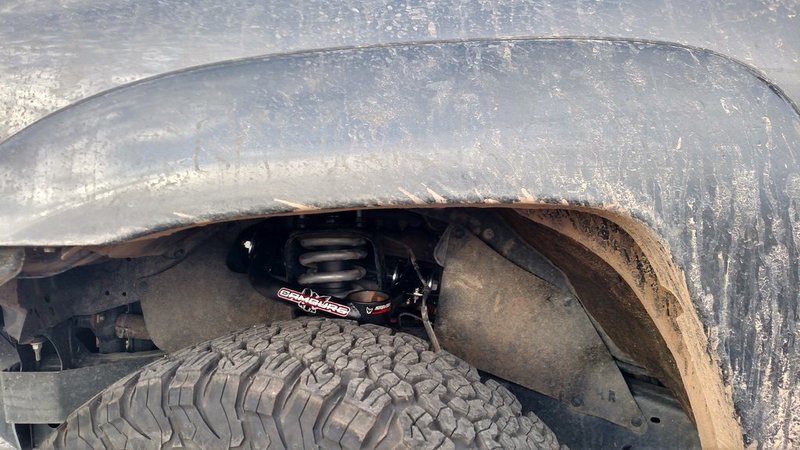

    Most recently I've added Camburg ball joint UCAs and 5100s. I switched to OME 886 coils and ditched the 1/2 spacers. I've added after market fogs, an onboard Viair compressor, diff breather mod, yellow wire mod and a couple of bright bed lights.

    What setting are your 5100's at with Eibachs? How much did the new setup change your lift?

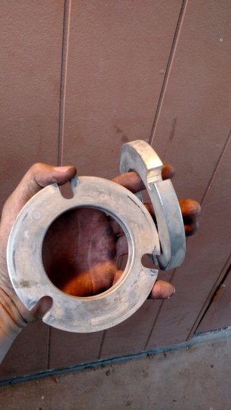

    I started out with the eibachs 2.5" coil and 1/2" spacer. I ditched the spacer, kept the lift springs and added billies. I set them at1.75, the third setting. It feels softer up front but only added 1". This was after losing height from the weight of the bumper. My total amount of lift is about 2.5. My front is 22" hub to fender.

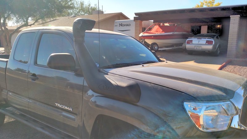

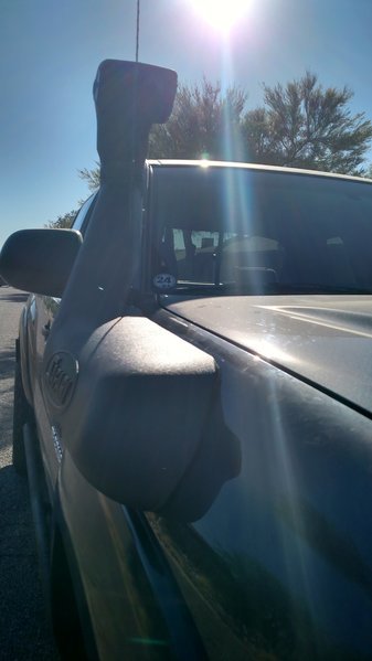

    Got my snorkel on. I really like that it fits the body lines. I just orders full skids from Eddy at SOS. To hold up the extra weight I'm getting some OME 886 coils. I'm kinda worried about having a bro-lean so I might go with a shackle flip at the same time. That's something I'd planned to do anyway.
    https://www.tacomaworld.com/threads/my-safari-snorkel-install.423876/
