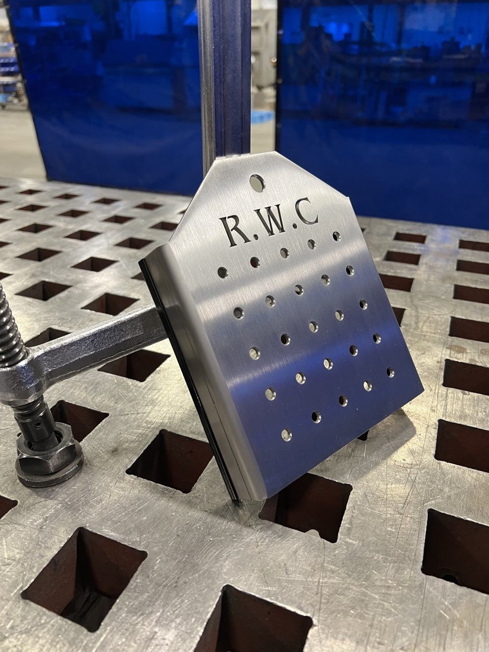

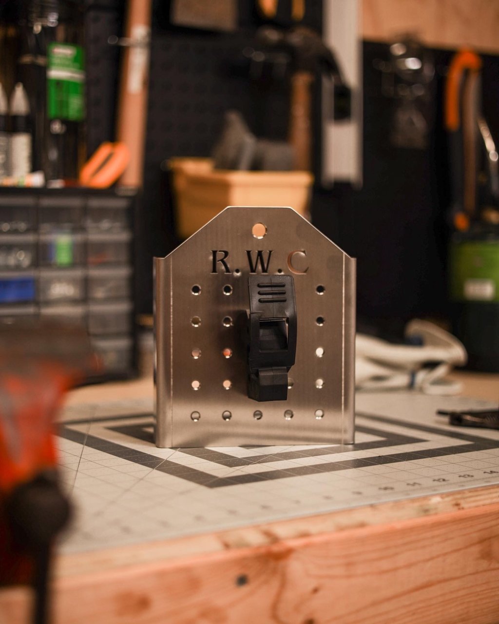

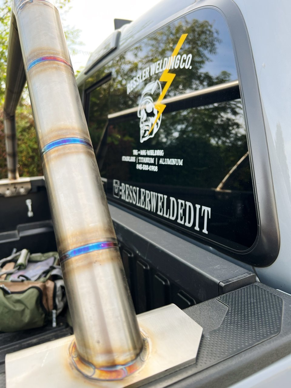

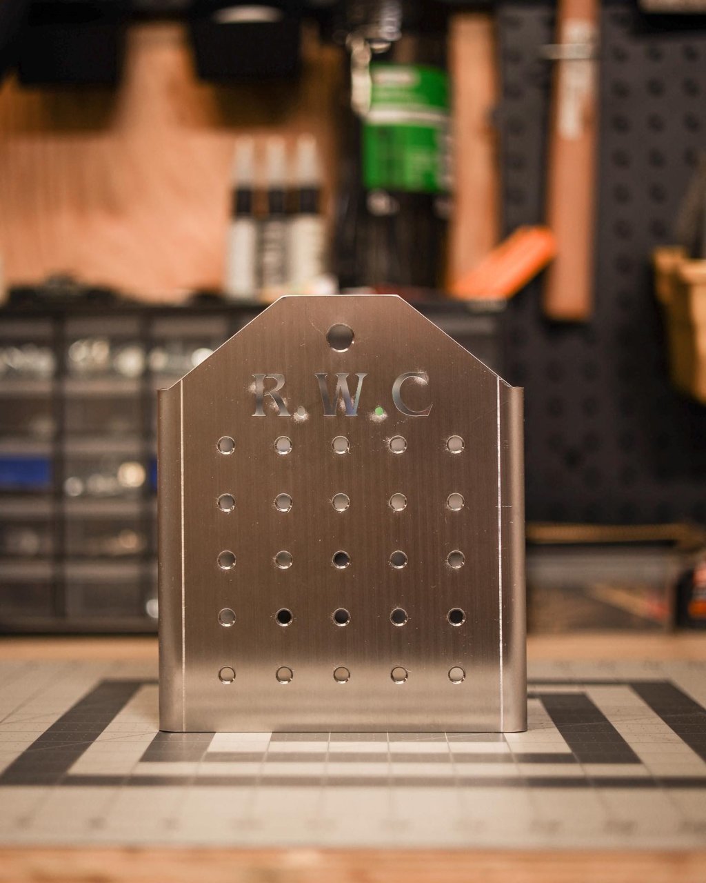

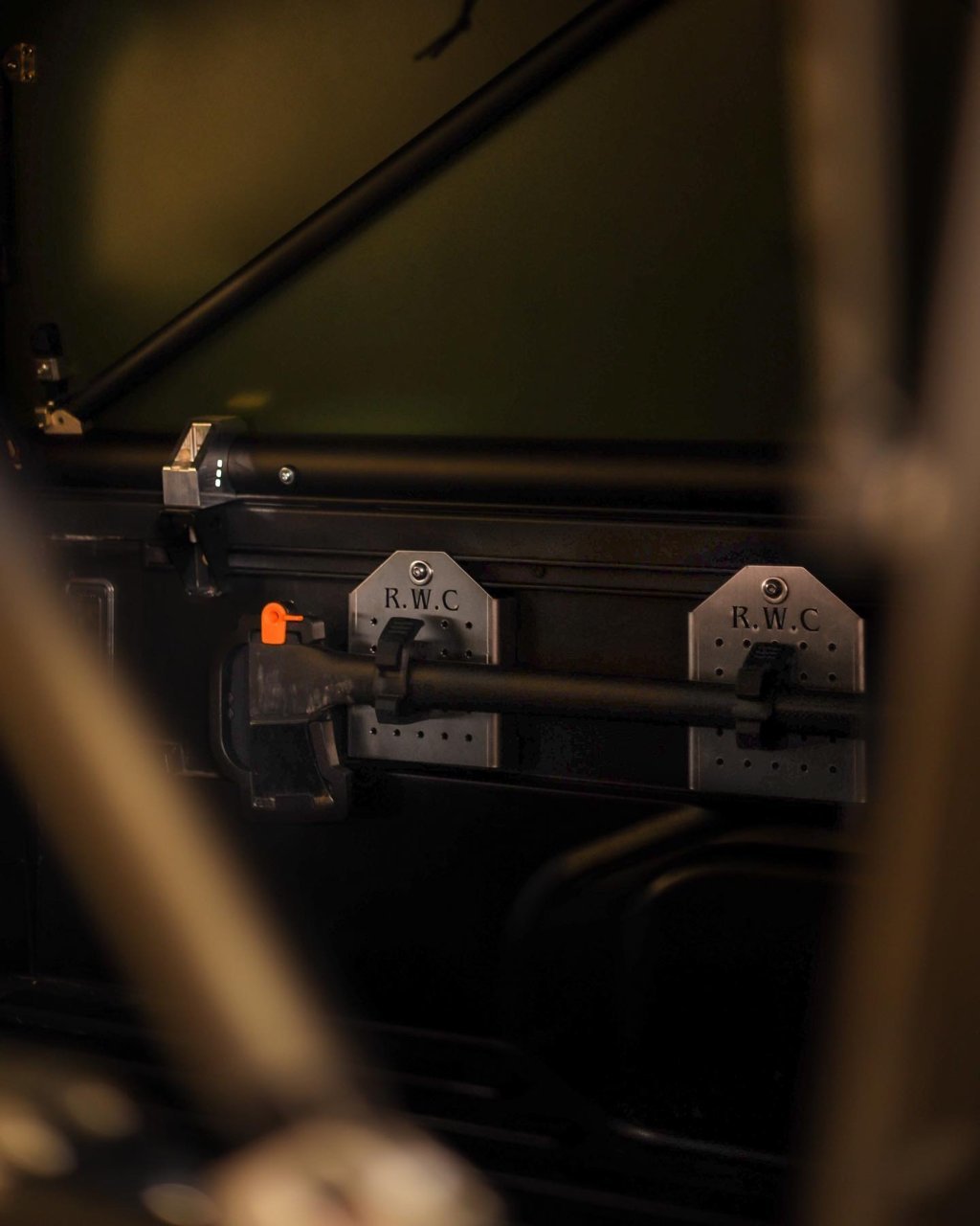

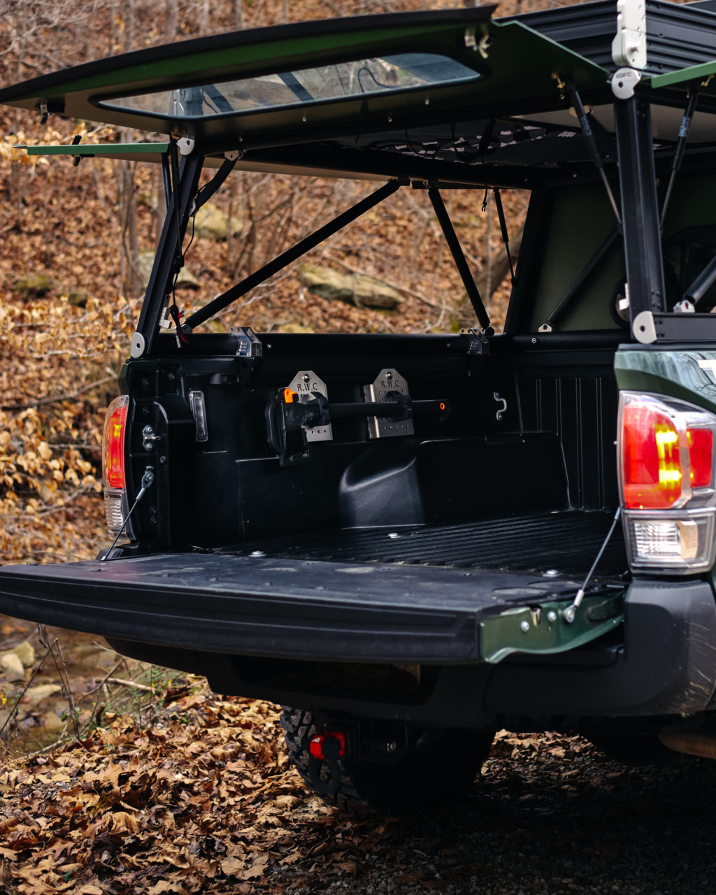

    howdy guys! long term lurker with something i deem post worthy. im looking for feedback about these 11 gauge 304 stainless steel mounting plates i made for my ‘21 tacoma. im a welder/fabricator by trade so it felt wrong to not make my own. they are laser cut and cnc bent. the holes are 1” on center and i mounted my quickfists to them. id like to know what people think and if there’s any interest in a stainless steel product. these plates won’t rust like traditional steel can. ive now added some trim to the edges to prevent scratches and vibration in the bed. looking forward to posting more and hopefully creating new things! also made a set of 2” stainless pie cut bed bars for my truck.
