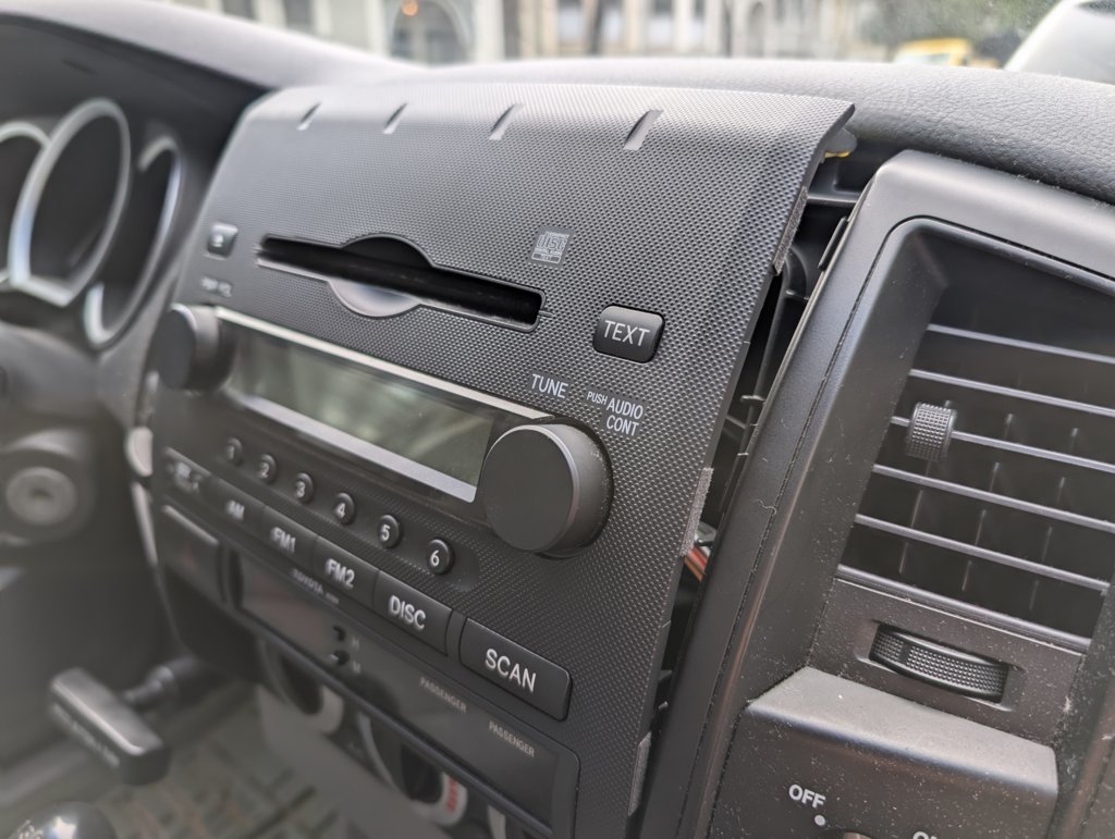

    Pulled out the radio to install a bluetooth module in my '05 Tacoma. Now the deck falls out when climbing steep hills. The clips are still in place on the faceplate, but they don't click in so the whole unit is held in by gravity only. It sits flush with the dash but falls out at the top, since the bottom has a lip to hold it in. I removed the faceplate from the head unit and it still doesn't click in, whereas the climate piece below goes in and out fine. The holes seem to big to offer any purchase for the clips. Did I break five mounting points? Were there backing pieces that fell off? What am I missing? Thanks for any advice.

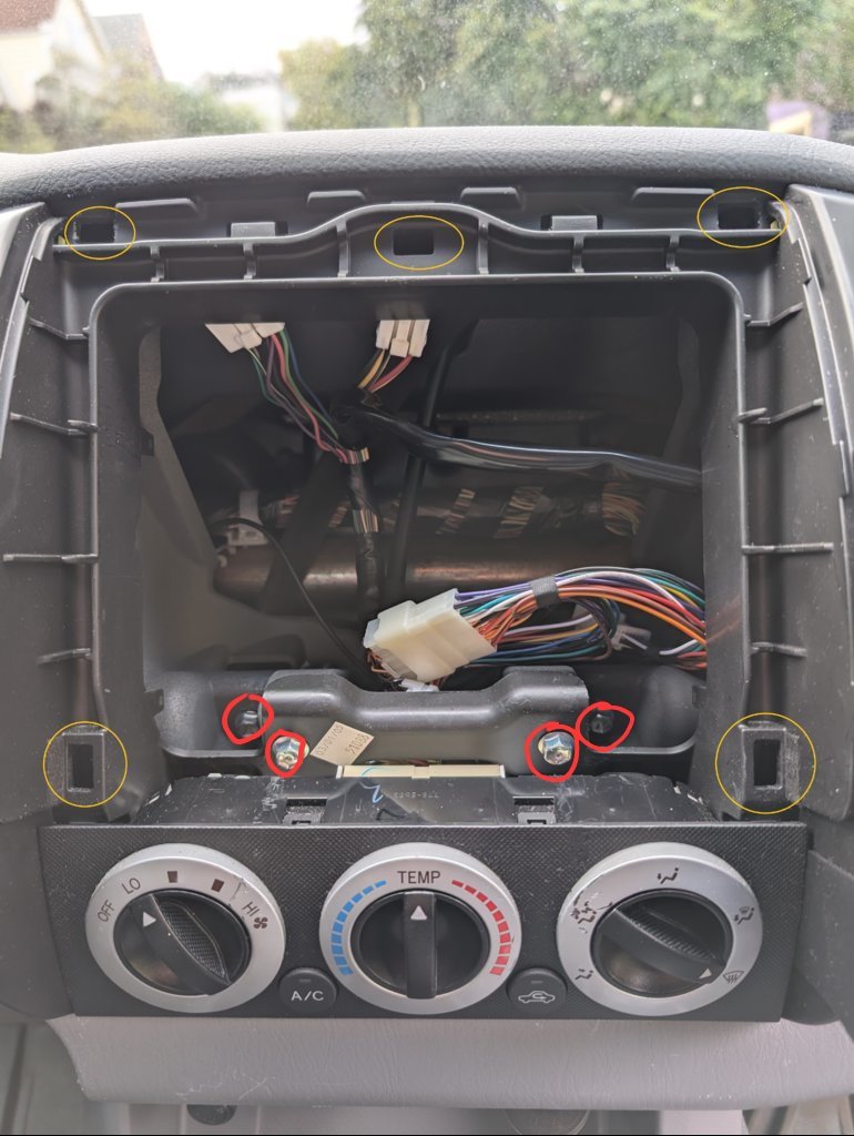

    The mounting for the radio looks broken. Those four 10mm bolts above the AC unit are supposed to hold the radio in.
    IIRC to remove the radio you're supposed to pry the AC controls out and then undo those bolts before pulling the radio out of the dash. The clips line everything up but they're not going to hold the radio into the dash.

    The head unit should be held in by two brackets (left and right) that attach to the dash by the bolts circled in red in the post above. The clips secure the bezel to the dash, but are not capable of securing the radio. I had a pair of plastic brackets that came with an aftermarket bezel for an aftermarket head unit. I threw the plastic brackets away and used the metal brackets that were used with the OEM radio. The OEM part numbers for the brackets are: 8621104050 and 8621204040

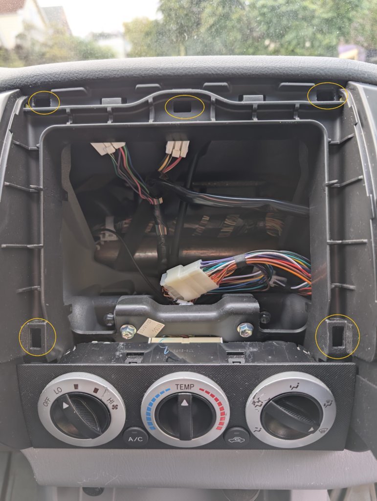

    Here is what the brackets look like.
