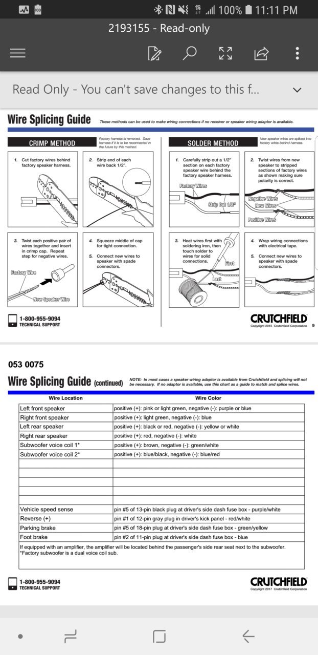

    Can someone give me a link to 2012 DC OR speaker wire diagram?

    If you get the supplies from crutchfield, they should email you a wiring diagram for your truck I know they did with mine.
    I've had people on here tell me sound processors aren't worth it without an aftermarket head unit but I can't remember the reason hopefully someone else will be able to help better with that
    What I got with crutchfield but I only ordered speakers and not an amp maybe they'll give you more

    I've attached the Directechs wiring for the 2nd gen non-JBLs.
