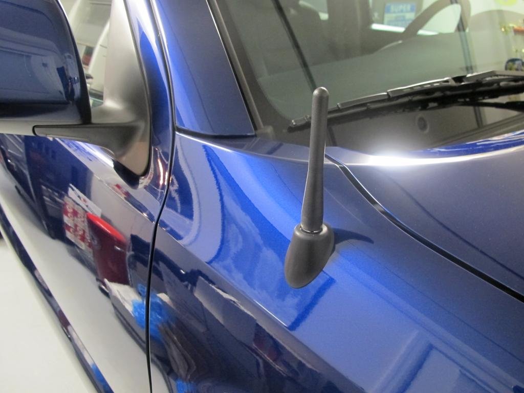

    I did not really care for my OE mast antenna and dug around in my parts bin for a replacement. I found my "CravenSpeed" stubby that I used to run on my 350Z. It fit great and look good.

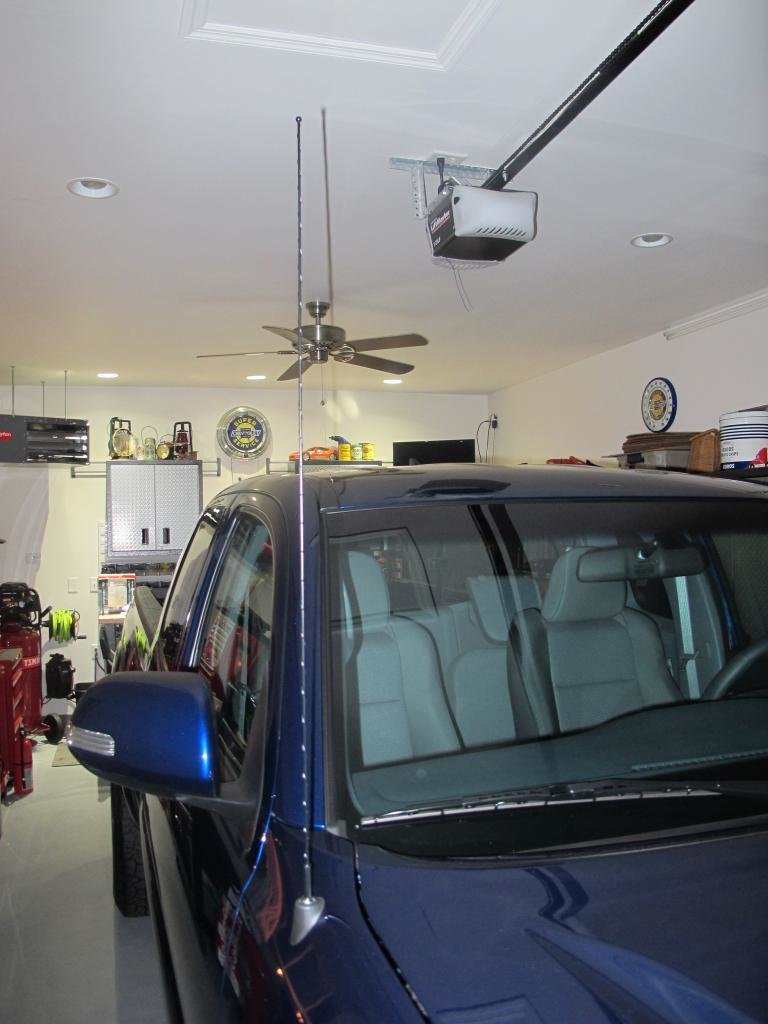

    I have a '15 Sport AC with non-JBL Entune plus and NAV. The stubby picked up my FM and most of my AM stations which was fine. The shark fin works great for the satelite stuff. However, my HD weather app does not work with the stubby. It cannot download any data. The weather app does work fine with the mast antenna. Obviously the weather stuff is received by the mast and not the fin (which would have been my first guess).
    I love the look of the stubby but I need the weather updates for my work. So I had to put the stubby away and go back to the mast.

    It's probablly just not making full contact with the base, inside the antenna mount. I had this happen to another truck of mine. I had to "modify it" by extending the screw-in part of the antenna and JBwelding it to the inside circumfrence of the mount.
    Don't recommend doing this though, as it is not easily reversible.

    Yep, stock mast antenna for 2015. I think I had a CB whip on my '82 Toyota that was about the same length! I have a 9 foot tall garage door, it would hit a shorter one.

    Thanks for the advice.....I may play around with mine over the weekend as I think my threaded insert does screw out of the mast. Possibly screw that in first until it bottoms out and see if there is enough thread left to engage the stubby.

    No, that is the stock length unless there are different lengths for different head units. I took that pic standing looking straight on, I am 6 feet tall. I can measure it tonight after work if anybody is interested.

    Just got home and got out the tape.
    32" from base to tip. Entune, non JBL, with NAV.
