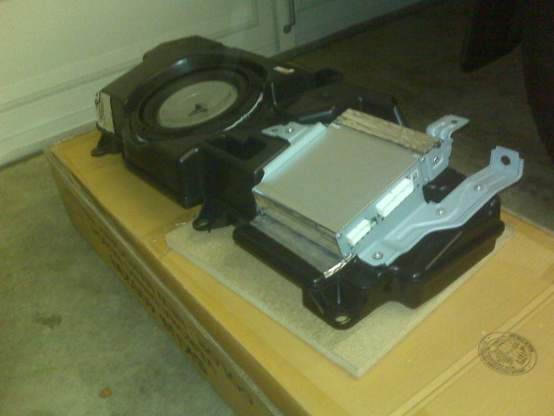

    My taco came with the JBL sound system with a Kenwood DNX-5120 HU. While the HU wouldn't have been my first choice, it was already in my truck when I bought it - it was a dealer upgrade.
    The stereo sounded decent, but I've been a little spoiled with my last few vehicles that had Bose factory sound systems. So the more I drove the truck the more I wanted to upgrade the system.
    My key objective was to maintain the factory look (including the back wall surrounds and the covers on the back of the seats).
    So, I decided to upgrade the factory JBL 8" sub with a JL 8" sub, utilizing the same OEM plastic enclosure I replaced the sub. As soon as I turned the system on, it was evident the factory JBL amp wasn't sufficent to power the new sub. So I dug through my storage and found my old skool Soundstream Little Wonder and decided to hook it up.

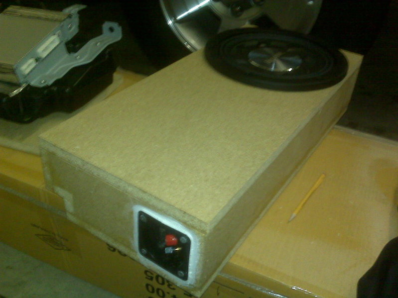

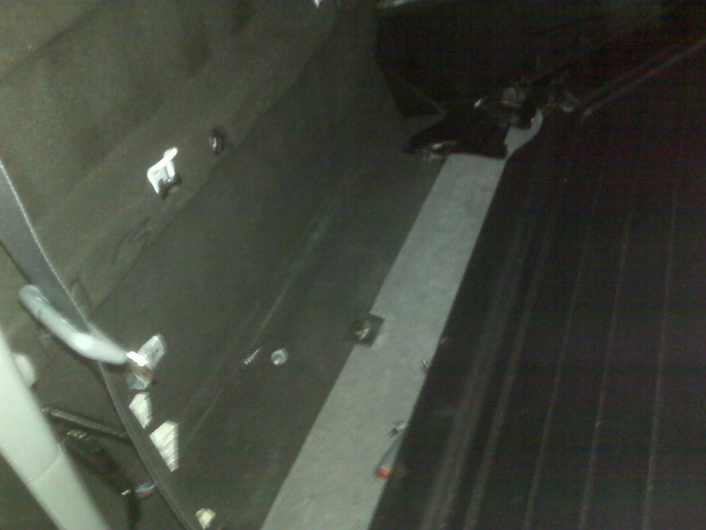

    Then I was going through Marv's pictures and discovered a little shorty box he had made and it got me thinking - what if I could purchase a shallow mount 10" sub and create a box that would go behind the OEM JBL back wall panel.
    So I dusted off my table saw and got to work. The attached is what I came up with.

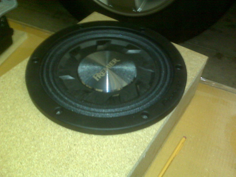

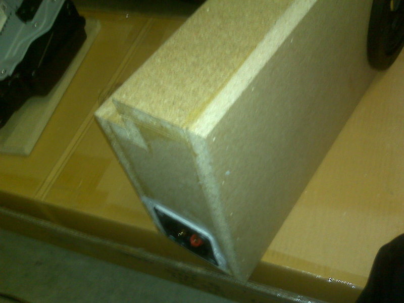

    The box dimensions are 24" (w) x 11" (h) x 4" (d) or roughly .61 cub ft with a notch cut out of the top for it to fit under the brace across the back wall. I'm using a Pioneer Premier 10" Shallow Mount Sub (recommended dimensions .35 - .75).
    Should my box do the trick?
    How much Polyfill should I use?

    Looking good so far :) however "Houston we have a problem"! :eek: Your airspace is not actually .61ft^3 since it appears you used the outer dimensions to arrive at that number without accounting for the notch. By my calculations you have less than .3ft^3 and I don't think any amount of polyfill is going to help. :(

    Thanks for the feedback. I just noticed I misquoted the depth it is actually 5". Ooops! :p
    I get 0.43294 (not taking into account for the notch). I will have to go home and measure that to make sure I'm ok.

    MUCH better on the airspace! The passive crossover is used between the mid/tweeter of a component set (high passes tweeter/low passes mid in most cases however some just roll off the top naturally) but it does not high pass the bottom end of the mid so you will need to use the headunit or amp crossover for that.
