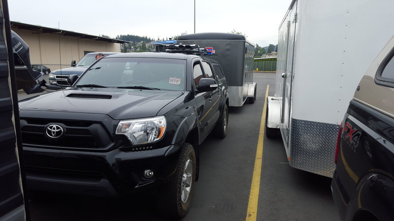

    Hey All,
    I've been stalking on this forum for the better part of a year, so I figure it's time to jump in. This will be a little long winded (slow day at work), so please excuse me in advance. Last year I picked up a totally mint "salvage title" supercharged 2nd gen for an absolute steal:
    The title was branded due to "owner refusal", meaning it had been in a wreck, and the insurance company got a quote from a dealer body shop (in this case around $7 grand) and went ahead and repaired the car. After the repairs they presented it back to the owner, and after driving it around for a bit the owner decided it just wasn't the same, so they wanted to cash out. The insurance company paid the owner for the vehicle, took possession, and sent it to auction. As soon as the insurance company takes possession, the title is branded - I was lucky enough to have the funds on hand to pick it up for ~12k less than it would sell for with a regular title!
    Anyway, since then it's had a full dealer inspection and a full 4-wheel alignment - Nobody could tell it had been in an accident.
    For those who are really curious or find themselves in a similar situation when it comes to buying a salvage title car, here's what you can do. Keep in mind I was crazy enough to buy this completely sight unseen, but here's where I got the confidence:
    - Buy the carfax and look very specifically for an accident report or police report. Once you have this, google it. This number will likely yield an actual police report that you may be able to buy/download.
    - Use this police report to figure out exactly what happened in the accident, and you can even do a search for the previous owner. I got lucky and the previous owner had a public number listed (he owns a lexus/toyota shop), and I just called him up. Be careful though, I believe it's illegal to get ahold of them using the private number listed in the police report...
    - Create an account on the Toyota website and punch in the VIN for the car as though it's your own. If the previous owner didn't make an account and link in the VIN already, you can check out the service records. Since the insurance company had the car repaired at the dealer after the accident, I was able to determine every single part that was replaced, right down to the clips that hold on the splash shields.
    - Ask for every imaginable picture from the person/auction site selling the car. I was nerdy enough to ask for pictures at the SAME distance from the car on the left and right sides, just so I could physically measure the panel gaps with a ruler on the screen... lol.
    Anyway, enough of that crap. Here's the mods that I know the previous owner installed:
    - URD 2.7inch pulley
    - lightweight flywheel (no idea on the brand)
    - extremely heavy duty clutch, presumably URD (it's similar to the clutch weight on my mother in laws RAM 3500 diesel)
    - Dough Thorley long tube headers
    - URD/TRD short shift
    - Aftermarket speakers with modified OEM stereo
    I got very lucky here, since I would never have been able to install most of these myself - I'm pretty low on time and available workspace/equipment.
    Here's the mods I would LIKE to install or have plans to install:
    - Full URD exhaust from the Y-pipe back
    - CAI (mostly to increase supercharger noise)
    - AFR and Boost gauges
    Now, I have concerns about the CAI and aftermarket exhaust, given that I'm at sea level, already running the 2.7" pulley, and I don't know if the previous owner upgraded the fuel pump or not :eek: Which brings me to my questions:
    - Is there a quick way to figure out if I've got an upgraded fuel pump WITHOUT much effort, IE dropping the tank and actually examining the unit?
    - Would the aftermarket exhaust lean out my AFRs at all?
    Feel free to ask any questions about anything in here :)
