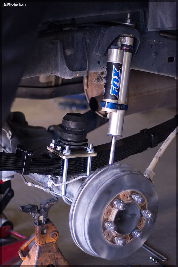

    good job HBMurphy, nice write up...the peeps at all-pro were more then accomodating to both SiRMarlon and myself during my 2 day LT install at all-pro. can't go wrong with any of them or their customer service!
    i have the same exact setup that HBMurphy just purchased...
    3" All Pro Leaf Pack, Timbren Bumpstops, U-Bolt Flip Kit, and Fox Shocks
    can't get any better in my opinion, the 3" leaf pack has some great flex on the trail and rides nice on the road..those rear adjustable Fox's are valved pretty much perfectly for our trucks. for each click to adjust the compression to make it harder or softer makes a huge difference. hint...i find the "3" setting the best overall. the Timbren bumpstops takes away that harsh bottom out and that distentive "thud" you hear everytime the rear hits hard.

    Good to know. I am getting my truck back Thursday and I added a Deaver 3 inch leaf pack. I can't wait to drive it. What is the advantage of a u-bolt flip kit. I think Deaver sent me a regular u-bolt setup, not sure.

    added clearance under the axle is the biggie
