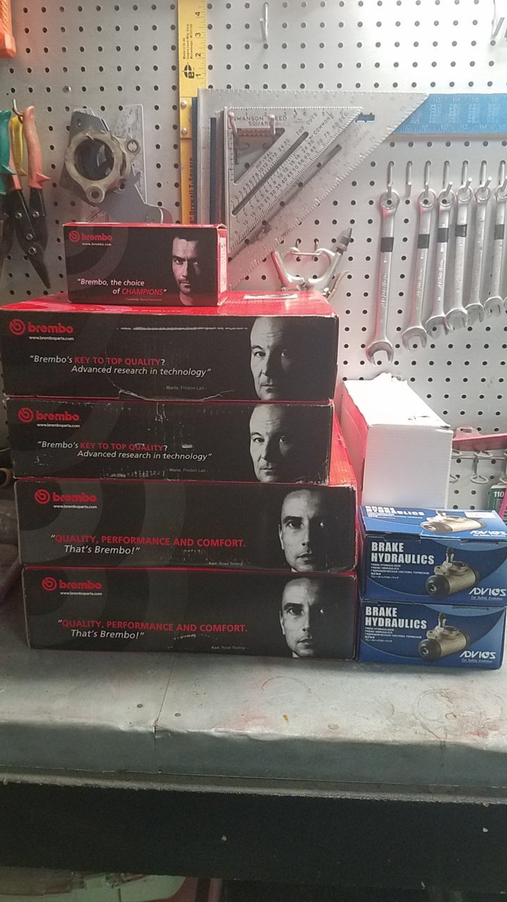

    We'll start by going over the parts.
    231mm Tundra Rotors and pads.
    231mm Tundra calipers.
    Tacoma drums, shoes, and hardware.
    Rear wheel cyliders
    Tacoma to Tundra swap 3 inch extended brake lines.

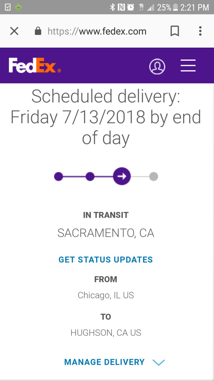

    All of the parts have arrived, except the calipers, as of today.
    The calipers are tracking for delivery by Friday end of day... so with any luck, the calipers will arrive as planned, and I should be able to get the brakes going this weekend as planned... fingers crossed

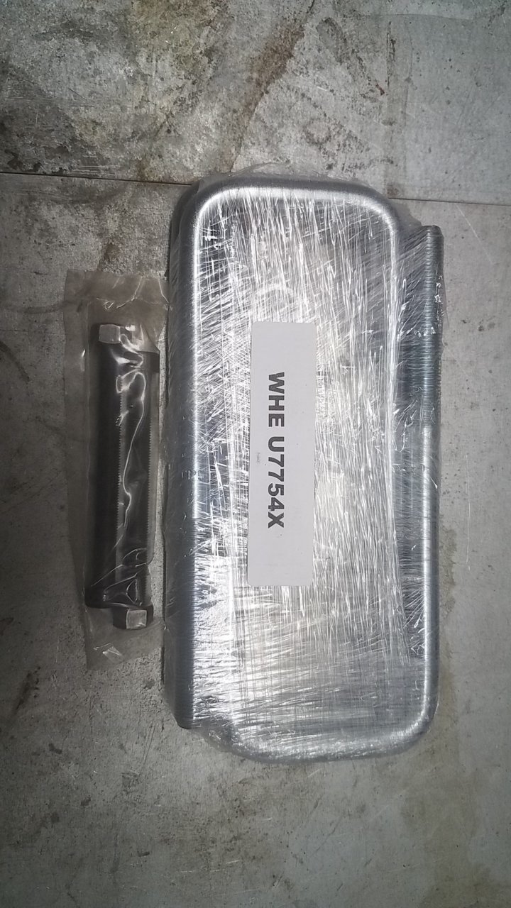

    For the leaf springs, I picked up some Wheeler's oversize U bolts and center bolts. I'm not sure I'll need them or not. I'm hoping I can get the additional lift I'm looking for while deleating the "rock catcher" overload spring. That part is going to be trial and error. Wanted to have the extended U bolts and center bolts, in case I need them.
    As for the leafs... I picked up a set of (middle) leafs off a 98 or 99 (can't remember) 5 lug. 5 lugs have a stack of 3 springs. The middle spring, from a 5 lug, stacks nicely as the second (from the top) spring, in a 6 lug leaf pack. (I can't take credit for this idea. @foxrcing07 was the one who told me about it, and it worked out nicely on his Taco).

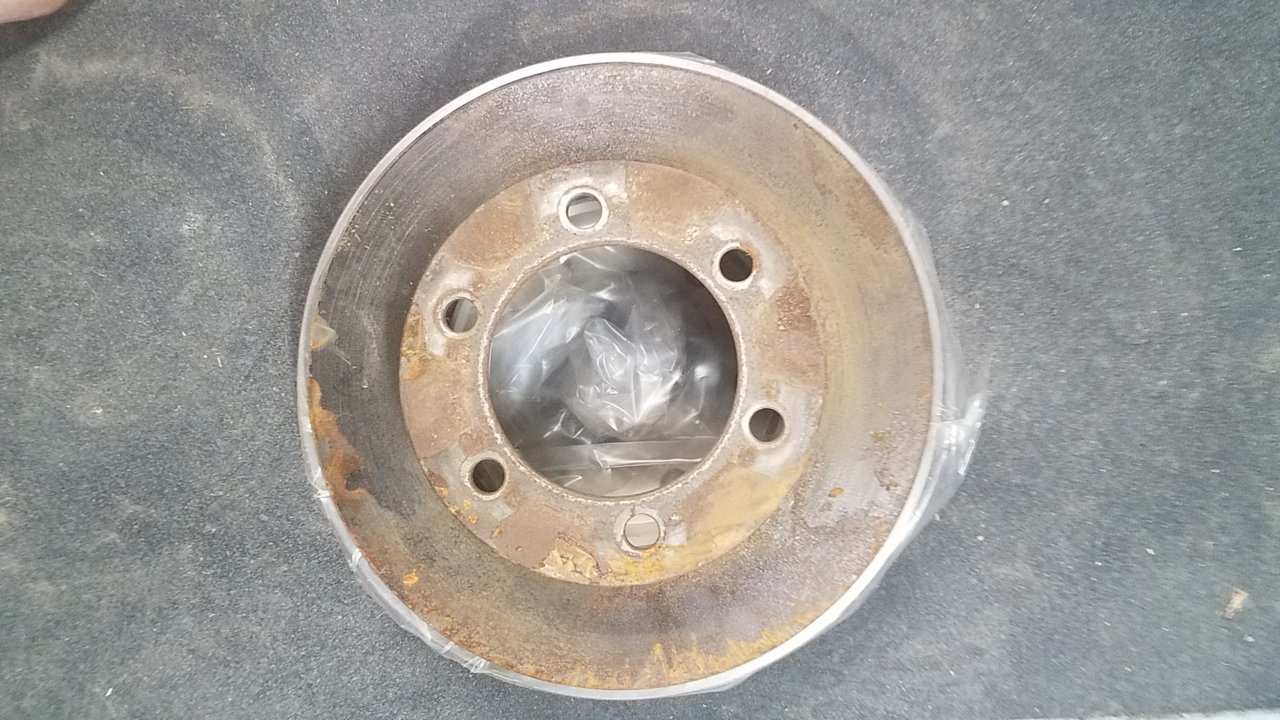

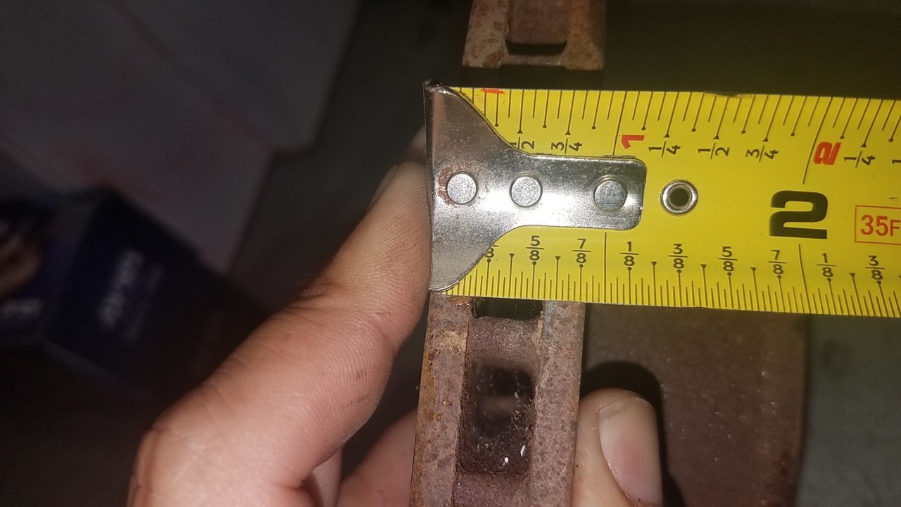

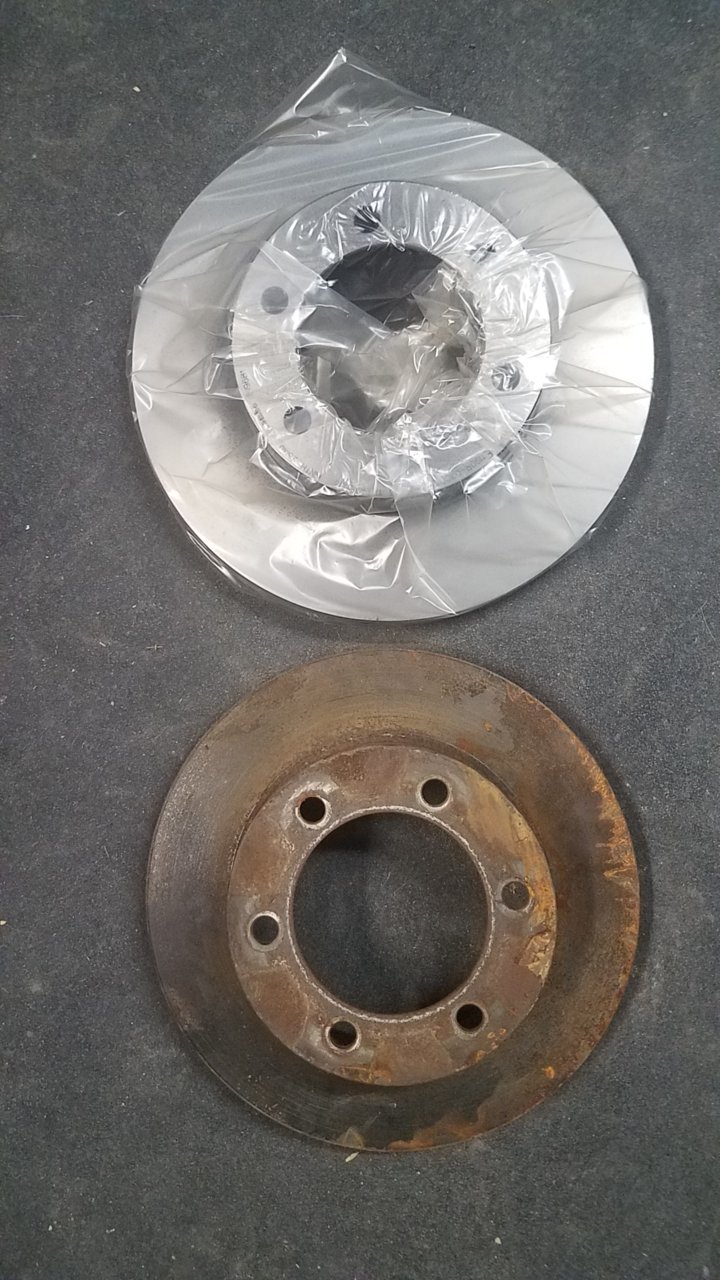

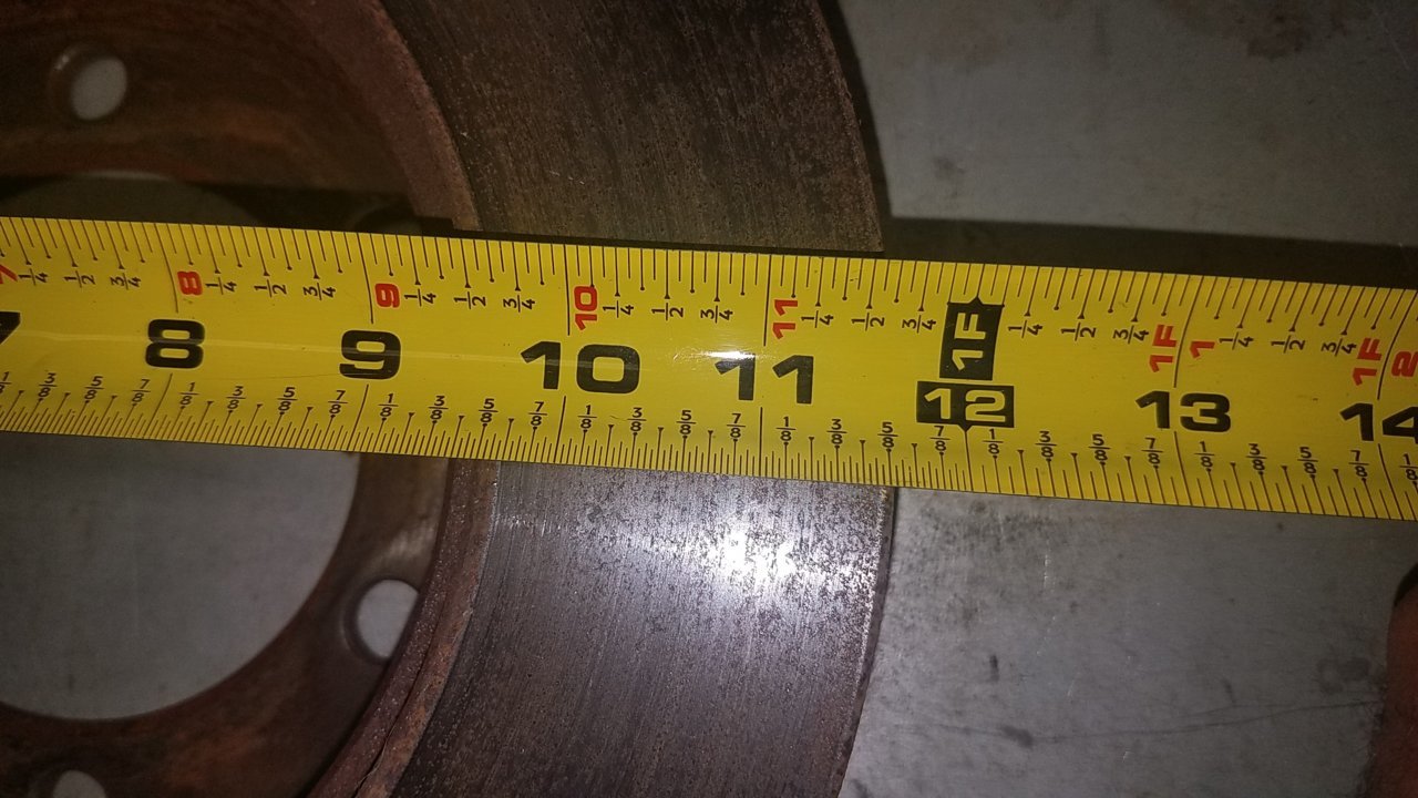

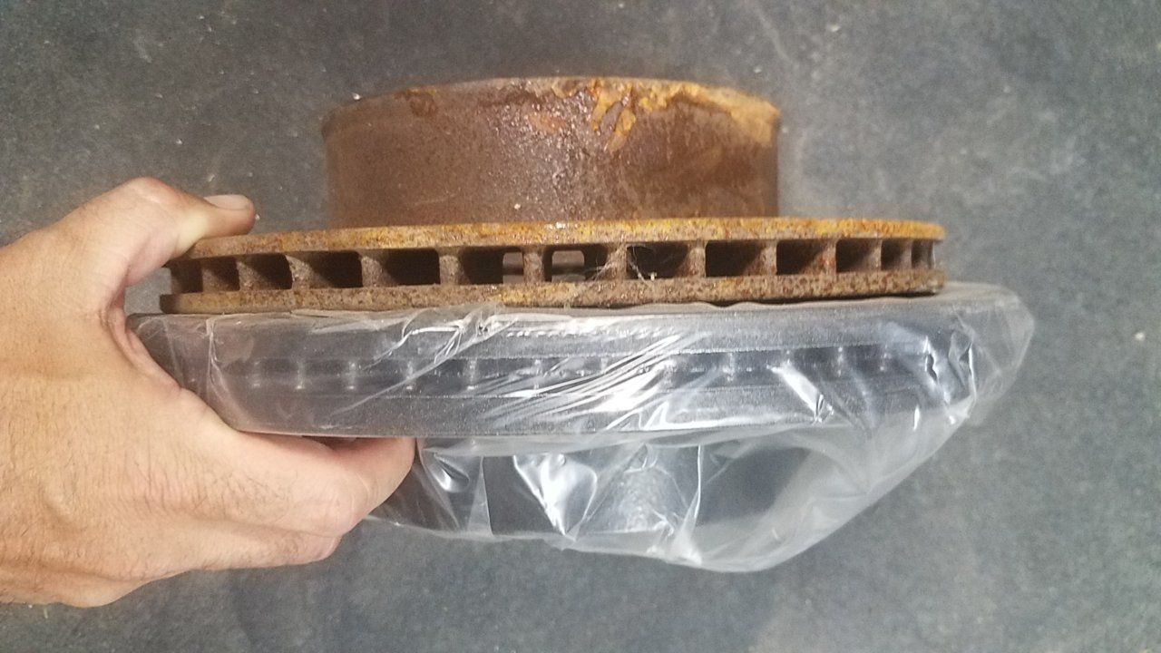

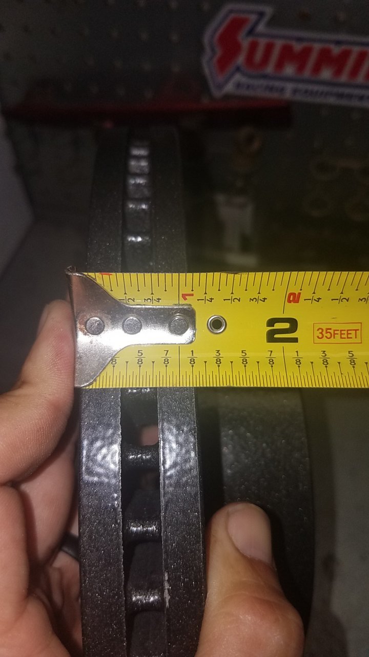

    I know the comparisions have been made regarding the size differences between the Tacoma rotors and the 231mm rotors... but I figure I'll add them here for those who aren't familiar... and because more pics (supposedly) makes the thread cooler.
    ** Disclaimer** The pics here, of the Tacoma (smaller) rotor are a rotor I had laying around of a salvage truck I got 4x4 steering knuckles off of. I have not been running them on my truck... they are for size comparison only.

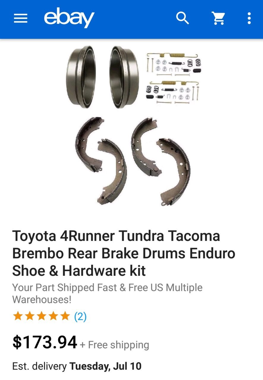

    It's worth noting, on the Brembo rotors. I found a whole lot of good reviews on them, but I understand one of the TW guys got some a few years ago and had a couple of gripes.
    First he didn't like the way they were uncoated on the vent edge and side of the lug face "drum" portion. He said they rusted, and looked ugly.
    Apperantly Brembo identified that as a problem and have since corrected it. They have applied a very nice looking coating in these areas, as you can see here.
    Secondly, he said they warped. Now I have trouble believing that these huge hunks of metal have a problem warping, especially on a truck that weighs a LOT less than the truck they are designed to be on. And I also have a hard time believing Brembo would stamp their name on something that is so low quality that they would be prone to warping.
    I do know that one way to give yourself problems with new rotors and warping is to install them and not properly torque the lugs, or not properly bed the brakes.
    As for the Brembo pads. I have read that they do a great job stopping, but they make a whole lot of brake dust. Since these pads came with the rotors, I figure I will give them a shot. Hopefully the excessive brake dust is another thing Brembo has identified and corrected... If not, I'll give them a month or so, I will change them out to something else like Akebono or Hawk.

    I've got the exact same brembo rotor and pads on my 13wl swap. The pads put off an ungodly amount of brake dust. I've had them on for about a year and finally decided I've had enough and bought some akebono ceramic pads to replace the brembos.
