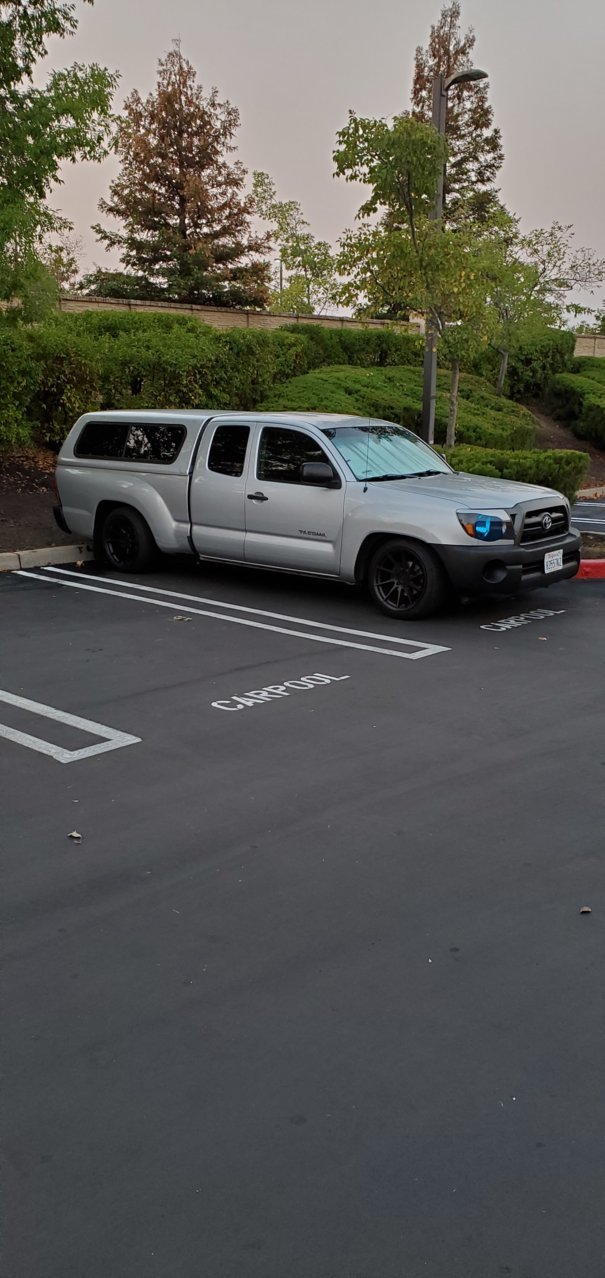

    Lowered change headlights & taillights plus new grill rims

    based base version. how did you lower her?

    Blocks in the rear....springs cut in the front

    please elaborate

    Struts were removed in the front then the springs were cut....the rear added blocks to the rear leaf springs

    how much spring did you cut? what size block?

    4" from the springs 5"blocks in the rear plus i cut the bump stops in half in the rear on the frame

    damn. thanks! how does it ride?

    Hey r u going to do it? Hey dont cut as much as i did in the front my wheels r aligned but the chambers is off there is an adjustment under it but i pushed them as far as they go so u cant get the wheels right / \ this is how they sit when u look at the front of the truck ppl ask if i drift in my truck

    Its not bad a little bouncy but I've always had my cars lowered so im use to it20210428_150639.jpg
