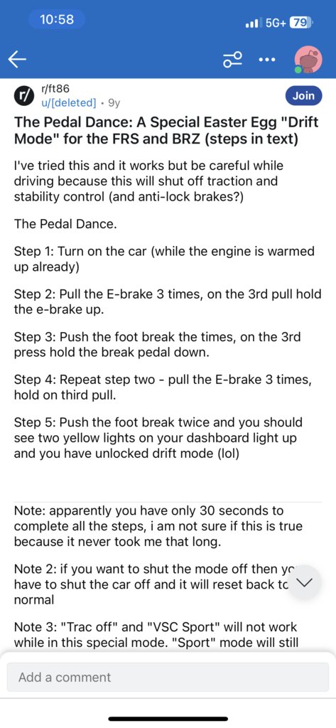

    I know you said don’t suggest anything tcs related but have you tried the pedal dance? Ive confirmed that it does indeed work for the third gen, (the sequence pasted below lit up my dash) but I’m not sure if it disables the rev limited thing you’re talking aboutIMG_4074.pngi heard this technician diagnostic mode will disable anything traction and safety related

    Trac off and VSC are not relevant to what im referring to at all. Please, if you haven't tested Tacoma 3rd behavior when reaching the cut off limit, do not reply with any suggestion. Again, I wanted my 3rd Gen Taco to behave pretty much like 2nd Gen when reaching the cut off limit so as long as the throttle is on, I want the cut off to remain active without disconnect after 1/2 second which's a protection that Toyota built as part of the stock ECU. Here's an attached short video for more insight of the cut off behavior issue and my VFTuner snapshot of the limiter. I'm quite sure the professional tuner will be able to advise about the VFTuner tunable parameter to overcome this issue. Simply extract the compressed .zip file to get the snapshot and short video Thanks all
