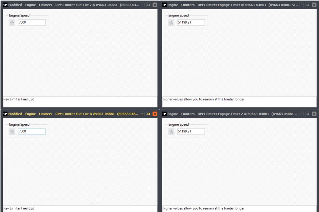

    Han_zn
    Han_zn [OP] Member
    Dec 12, 2024
    #462231
    13
    and Of course, I did try the Pedal Commander which didn't help at all unfortunately
    Thanks a lot for sharing. Do you think this table are correct parameters for that please?

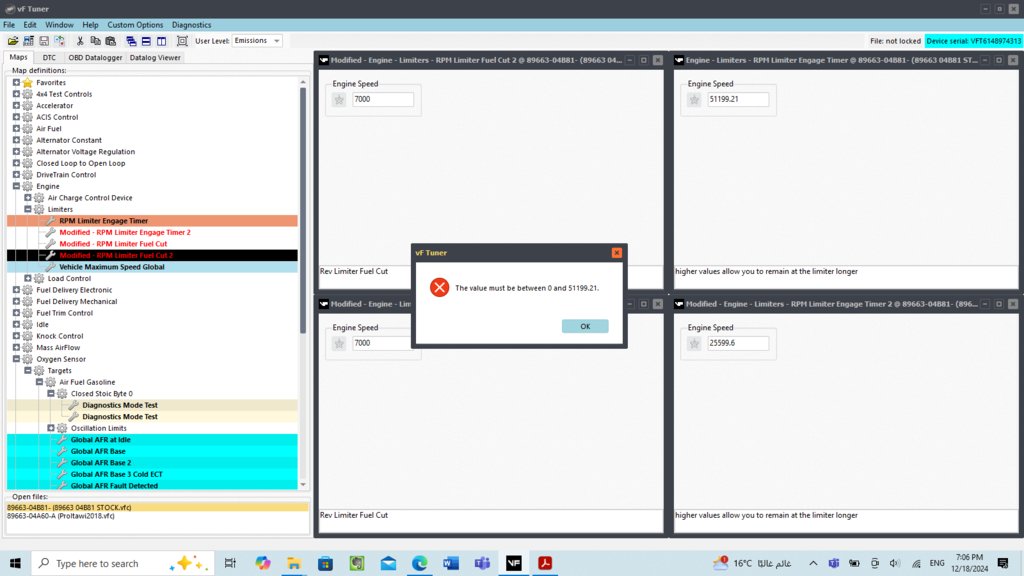

    Han_zn
    Han_zn [OP] Member
    Dec 12, 2024
    #462231
    13
    Thanks :)) You're the only one so far who's feeling my pain. so how did you translate the 10 or 15 secs into the below table ? Do you think the below value range is in Sec (0 and 51199.21)? VFTuner does not give clarity on that
