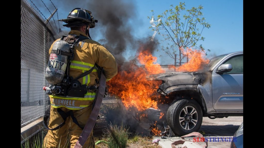

    Seriously. OP's truck gonna end up like this when he disables the rev limiter:
    Getcha popcorn ready :popcorn:
