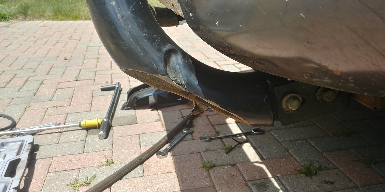

  16. Jun 29, 2017 at 9:06 AM

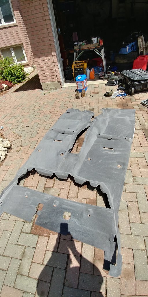

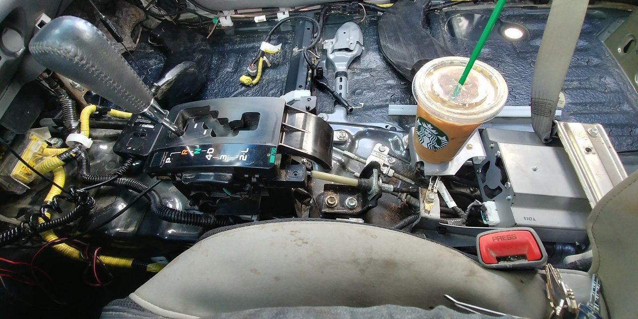

    One of the most trying things about this whole ordeal, was trying to find a spot for my coffee
