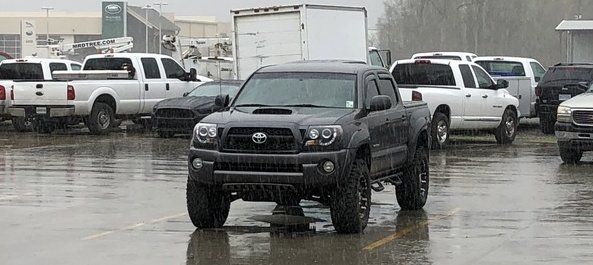

    This is how I solved this problem. Bought some Spyder headlamps.
