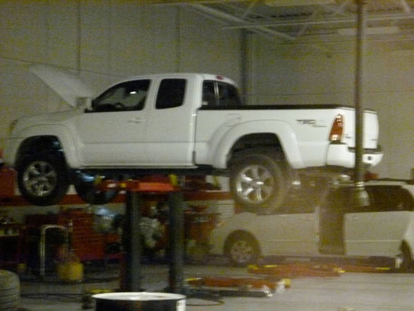

    My taco is getting the Throwout bearing TSB done at 46k miles. It has been making the noise for a while, but it took 3 visits to get the dealer to hear it.
    I took it in Monday, and they tore it apart and found the bell housing was gouged, so they had to order a new one. Snow on I20 kept it from getting to the dealer Tuesday, so I am hoping it arrives today.
    I didn't realize it when I took the picture, but my whole transmission is on a rack under the truck. I would love to get in there and look at all that, but I am sure that is not allowed. :(

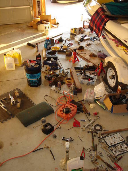

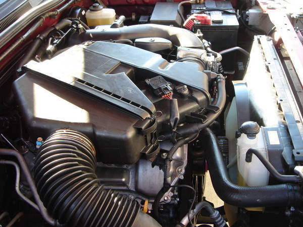

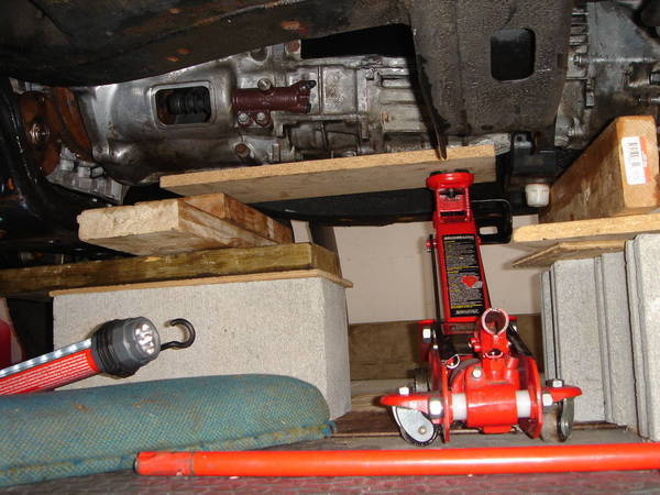

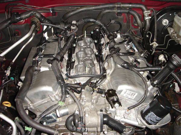

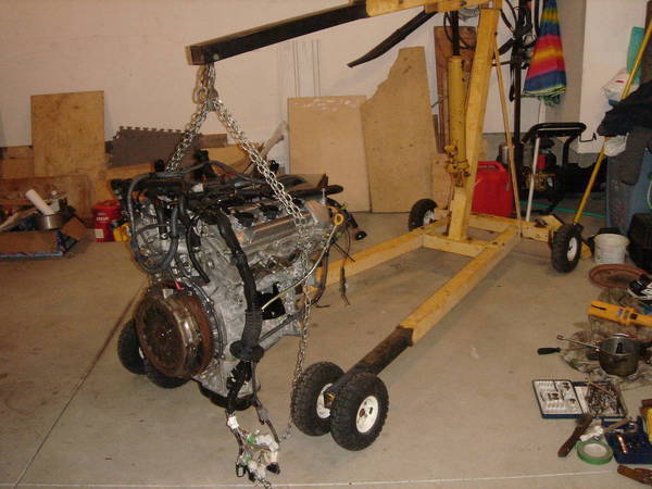

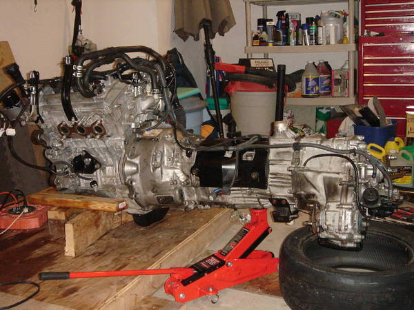

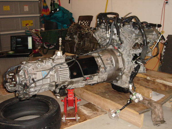

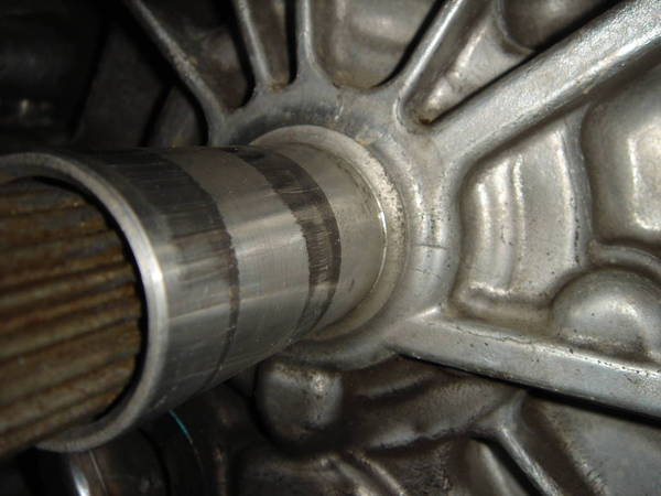

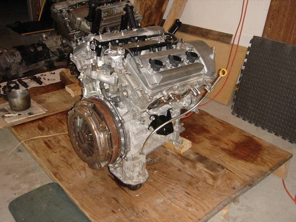

    I was putting in a new engine at the time so I just did the TO bearing TSB myself since I had the transmission out. I figured it was cheap insurance ... here's a copy/paste from another thread where I posted the pics.
    Here's a picture of the aluminum quill with 25K miles on. Despite appearances in the photo, it's actually quite smooth with almost no wear so I'm amazed when I hear of people who have had significant issues when mine is OK.
    Now for the rest of the job ... the new 1GR-FE with the clutch installed.
    Test fit for clutch alignment and wiring harness routing.
    The other side.
    On the way up.
    The Eagle has landed! (almost)
    Connecting the top end.
    Seconds before the first firing.
    Ceremonial first drive to the exact spot where my old engine died 3 months earlier (those oil spots on the ground by the front tires are mine ...)
    Post-install mess.

    Cool Wally, thanks for the pics. You did some major work there!
    Got mine back yesterday, and all seems well. I hope it lasts long term.
