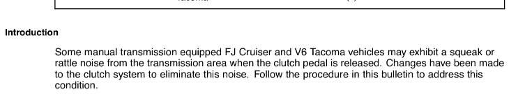

    According to the TSB, when the noise decreases when the clutch is pressed, it's a tob.
    https://www.tacomaworld.com/threads...lutch-release-bearing-is-finally-here.130843/

    Hmm, I would describe the sound as a constant chirping rather than a rattle or a squeak. Could be wrong. If he replaces the tranny, it will fix it either way though, no?

    I wonder if the shop is aware of the TSB? The dealership should've been at least.
    Its just that if its just the TOB then it would be a helluva lot cheaper to replace than a whole trans. But I mean if its a reputable shop and you don't wanna mess around getting any more quotes than go for it if you got the money.

    Wow, this sounds exactly like what happened to mine. I wonder if he'd be able to order the part for me and get it in the shop while they do the tranny. Going to give him a call now, thanks.

    That was the URD part I was trying to think of earlier... I don't look forward to needing it but its nice that there is a fix for it. Hope it works for OP instead of having to deal with replacing the whole trans.

    Spoke with the mechanic and he is saying that's an external fix whereas my issue is internal. Sorry I can't capture all that he is saying since I am not well versed in these types of matters.
