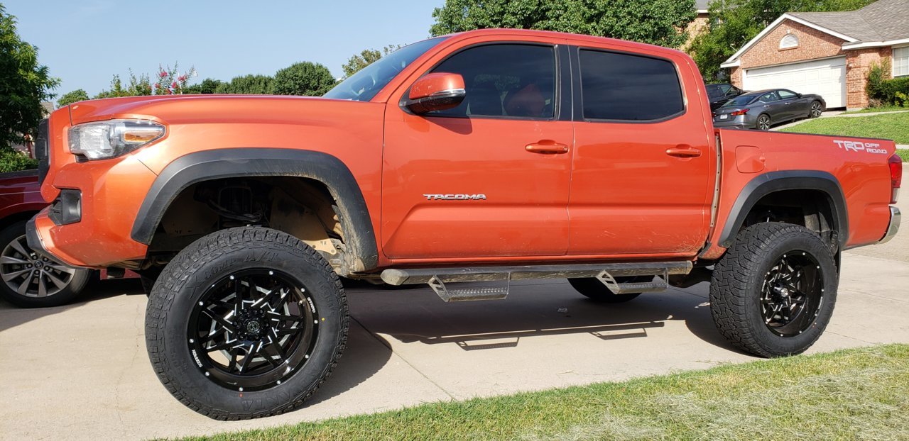

    I lifted my truck with 6" lifted kit from Rough Country and Installed by Texas Tires today. It's look so good at first but there is a problem is when I drive over 65mpg the truck started shaking so much. And the steering wheel was alignment but it's still go on one sides. Is anyone have the same problem

    sounds like death wobble like symptoms. Check torque on arms and bushings. Or could be you are binding the brake line and applying brake force to one side due to lift. I would go longer and better shocks all around instead of the RC ones which are poop. You have to cut the frame to install the cross members. Maybe they welded it in crooked. You cant really go to stock at this point either, so you are stuck with having to figure out the issues. And what do you mean by the steering wheel, makes no sense the way you worded it. Sounds like you need an alignment also is needed if Im reading that last sentence right?? Also what tires and rims are you running

    Pics or it didn’t happen

    That’s a good looking truck.
    I’d go back and have them bring the suspension back to stock, get a more understated set of 17” wheels and 265/70-17 ATs, put the lift and showy wheels for sale on Craigslist, take the loss as a learning lesson...and enjoy the truck.
