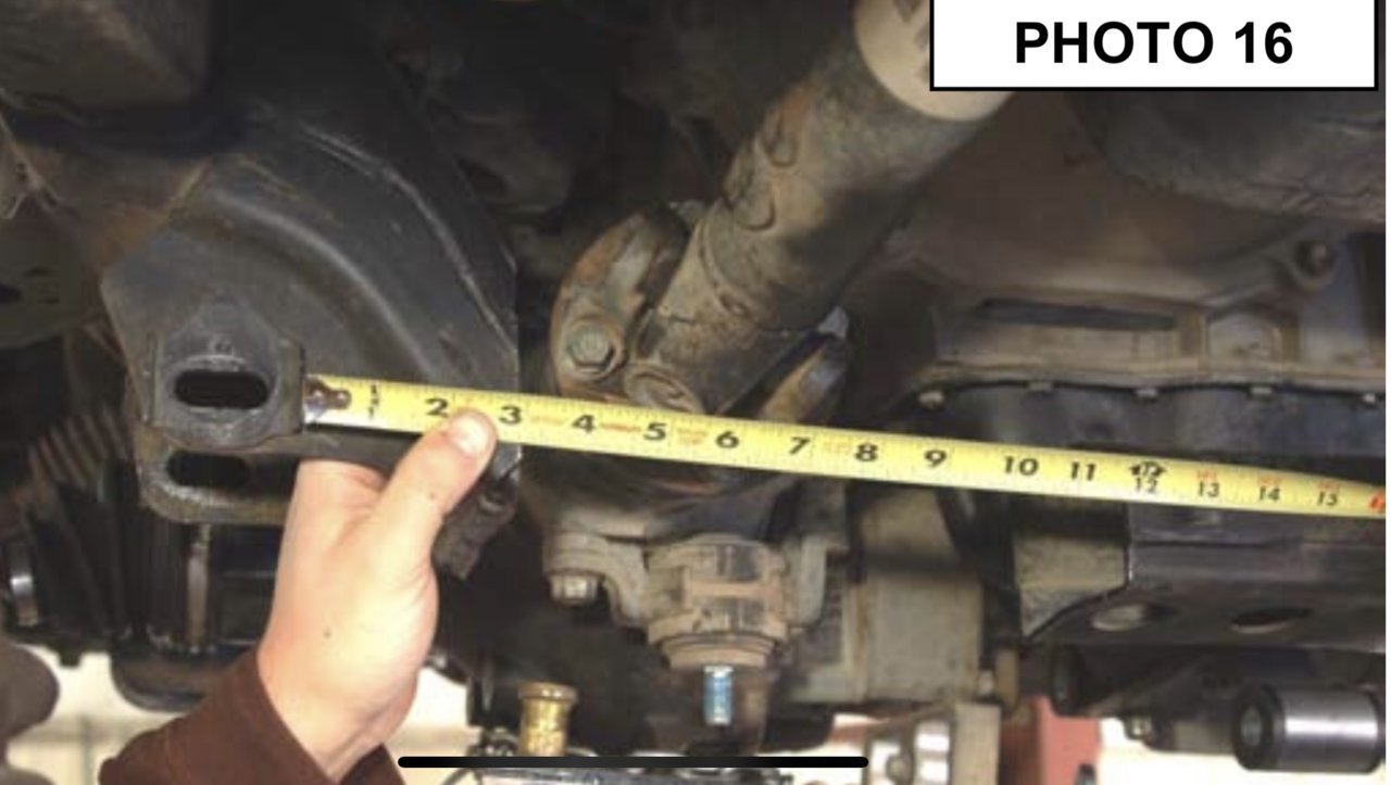

    I can see from the photo your rear diff pumpkin is angled. The output shaft of your transfer case and the input shaft of your differential housing need to be parallel to each other, and typically parallel to the ground unless they install a double-cardan joint on the output of the transfer case, in place of the u-joint.
    I think that’s going to be your issue. It won’t be tire balance. The problem is the phasing of the output shaft as discussed in one of the vids I shared above.

    My old man has a 6" Pro Comp on his 2nd Gen that I installed 11 years ago. Had the same vibration issues. Ended up installing traction bars to limit axle wrap and a Tom Woods driveshaft and it's vibration free. A 6" kit on these Tacoma's is a ton of lift and isn't as simple as just slapping it on there.

    If you watch the second video I posted, and talk to people with this amount of lift, driveline vibrations at specific/certain speeds are a real issue. I don’t have a crystal ball, but my money is on that. However it could be a bad tire. I’ve just never had that problem or heard of that problem on low-profile tires like OP is running. Typically those balance pretty good with so much less rubber.

    did they put spacers in the rear driveshaft carrier bearing ? That was the problem with mine.

    Tacomas have bad axle wrap; rear lift blocks make it even worse.
    I'd get a the proper leaf springs for lift; something with a reinforcement half leaf on top. Then see if the driveshaft needs replacement after lengthening. Then mess with angles. Then decide if ladder bars are still needed ; I'd probably try something like the Roadmaster suspension first.
