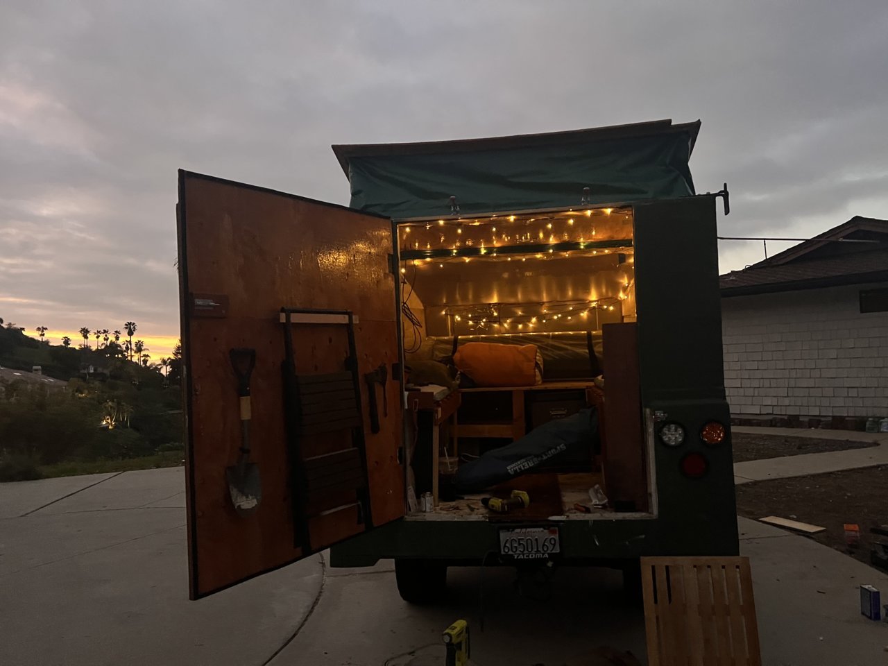

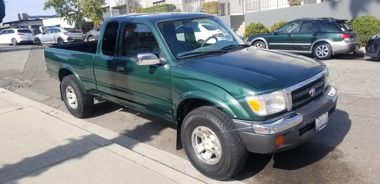

    Bought the truck from a one owner family @186k on the odometer.
    1999 SR5 4x4
    2” old man emu leafs and shocks, with an added leaf to the rear.
    Put airbags to help with the weight
    Reinforced the frame with 1/4” thick steel
    4:56 regear
    7 foot utility bed
    Snorkel

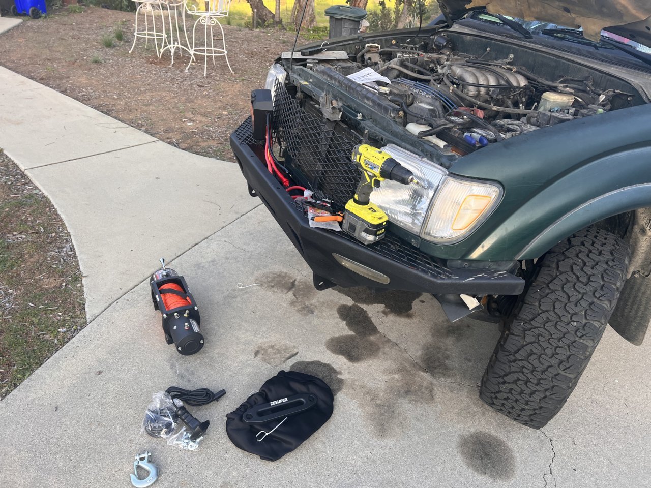

    Front bumper from an 01 Tacoma
    Linex on the camper portion and the bumper
    9500lb winch with synthetic line
    Found metal for the grill, linex and colored

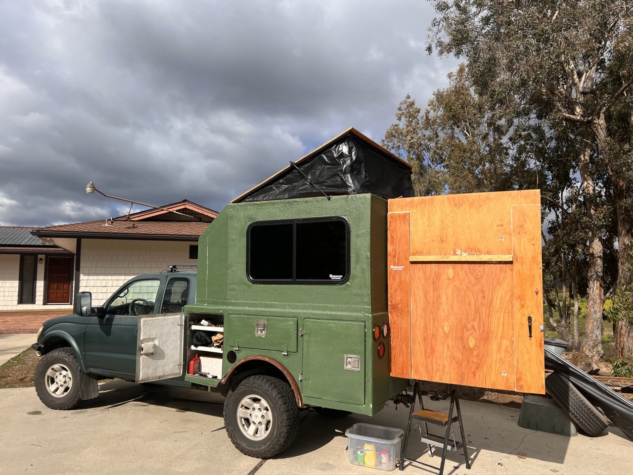

    Passenger seat removed for max to lay down.
    camper is made up of 2” XPS foam, fiberglassed and then linex.
    200 watts of solar
    200aH lithium
    Iceco 45L fridge
    King size bed
    7ft 270 degree awning
