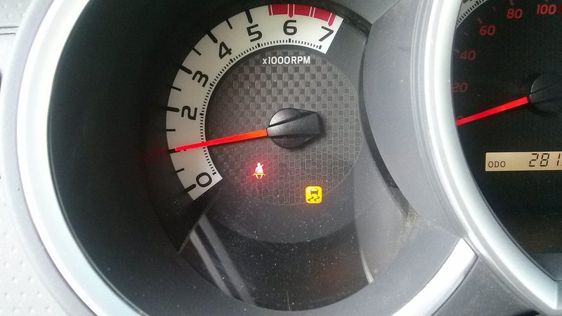

    Hello people, i bought a 2013 tacoma and i could'nt be happier with my choice, i have one issue now, the traction control lights are stuck and the button is not working, usually when i used to press the button i can see on the screen that it tells me traction on or off, and when i used to press 5s+ on the button the traction control will be disabled completely and it shows on the screen.
    now i cant do any of those things and the the light is just stuckm am i missing something here ?
    im new to these kind of stuff

    Just for clarification I believe that's the VSC off light (vehicle stability control), the Traction control one says TRAC OFF off at least on my 2013 sport. Is ABS light on as well? I think when you have an ABS/wheel speed sensor error it will disable traction control and vsc since it uses wheel speed and ABS to control the traction control ABS/TC/VSC

    Try cleaning all ur wheel speed sensors

    This happened recently to my wife's 2015 RAV4. I plugged in an OBD2 reader, scanned the system and poof! The light was gone. Wasn't intending to clear the lights (she also had the 'eco' mode light on)...but it worked. Might be worth a try.

    ill give it a shot

    Have you unplugged battery? Try that if the cleaning of sensors does not work
