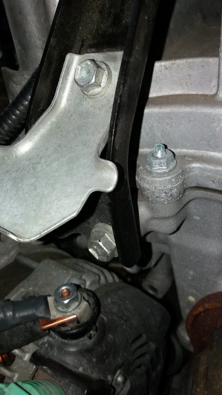

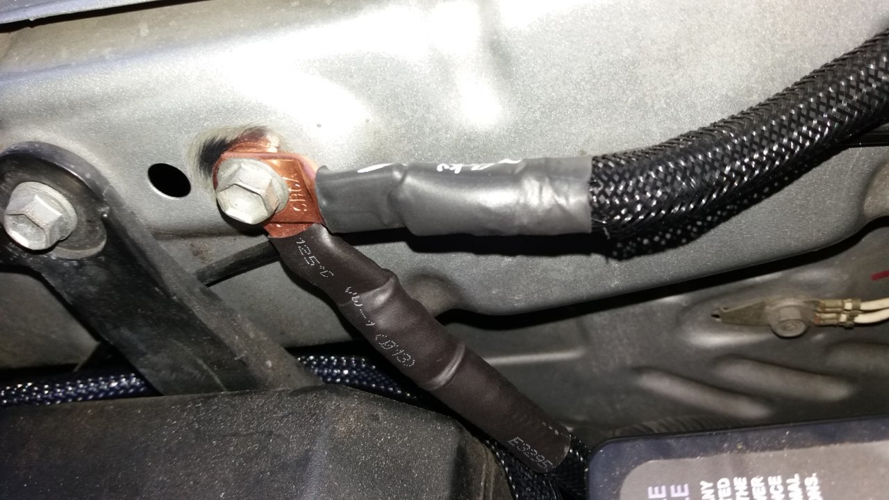

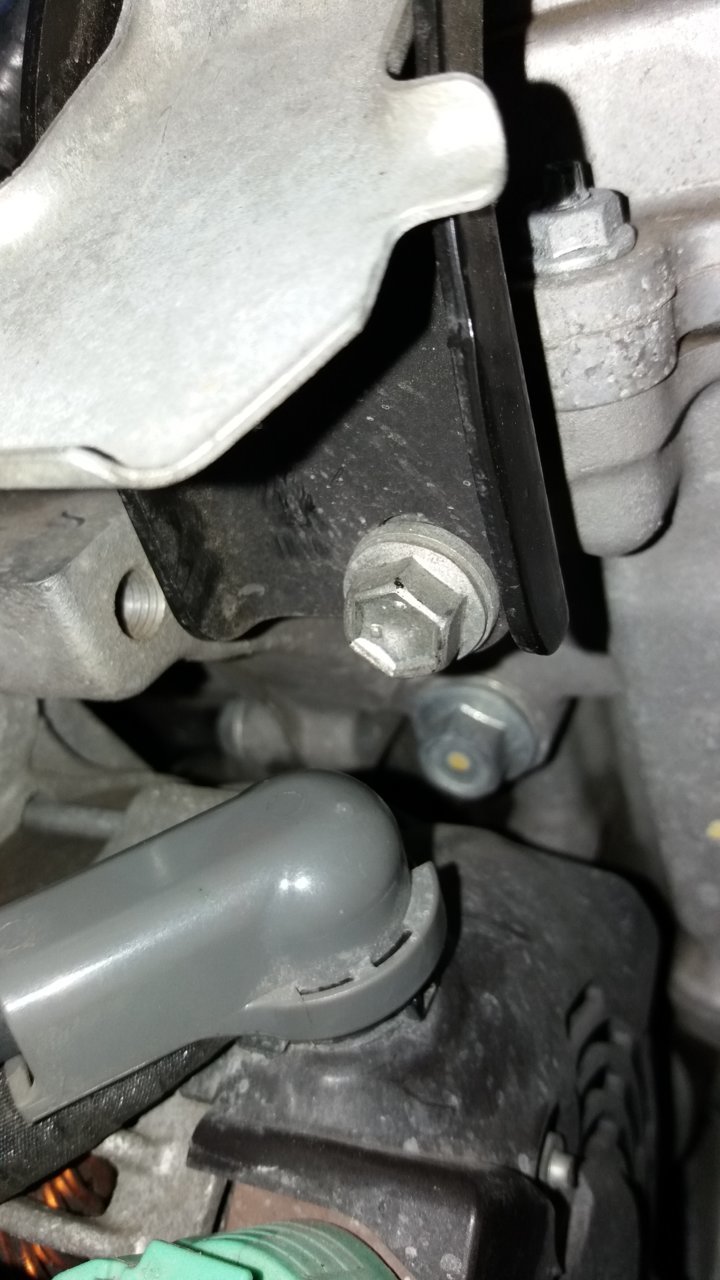

    No it worked fine..lol! It improved my voltage..Im at 13.8 to 14.1 volts with the system running....I was glad i did it..I'll get pics for you!

    I put the after market wire under the original wire so i could put the boot back on to make it look clean.

    Nice! Thanks for the pictures! Looks good!

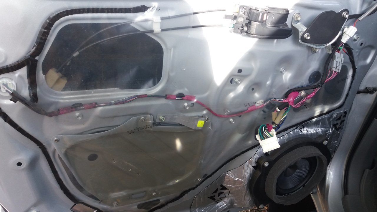

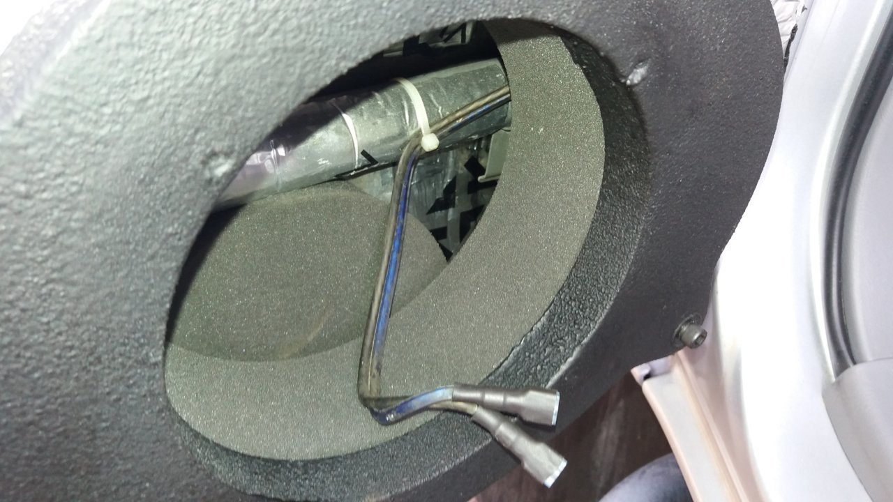

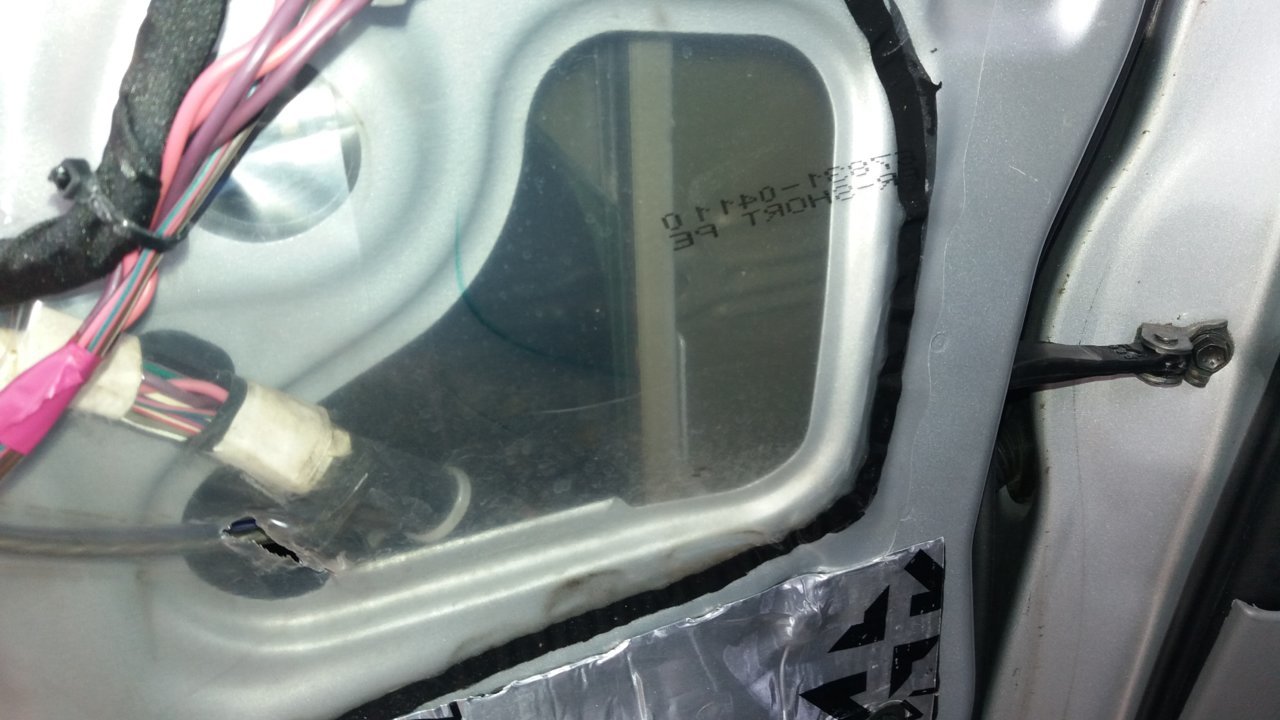

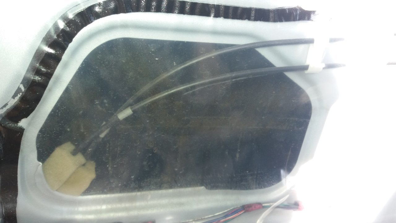

    Went to audio evolution in Charleston south carolina,One hour drive from me..The installer is name Chris Ott...Well know in the industry and award winning installer and a cool and nice guy...He started tuning the twk 88 for me..He spent hours..He came and got me and said there is one problem i need you to fix before i can dial the tuning the rest of the way..He showed me..I did not put enough sound deaden on the front doors..I did put some but he said it would sound so much better if i did the whole doors inside and outer door skins and for me to bring it back and the rest of the tuning would be for free...Here is some pics....Should i do the whole door and cover the access panel and any holes in the door..He said all the sound is bouncing around in the door and it's going to sound horrible if he finished tuning it.

    The holes allow a lot of road noise to come in which makes the system harder to hear and they also distort the speaker quality. I would deaden the hell out of the doors because it made a huge difference in my truck. If you look at my thread you'll see that when I first deadened the doors I left the big hole open & eventually when I came back to plug the big hole using MLV I did actually notice a huge difference.

    Thank you!!Im checking your thread! I seen where i have an excess panel for the window motor that is held in with screws..I guess ill cover that up too.

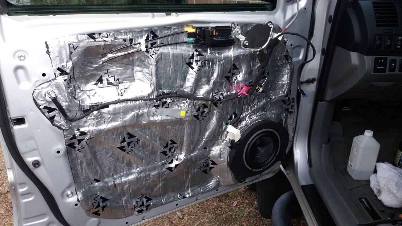

    Started on the doors..So far so good..A lot of work! lol! so far what a difference!!

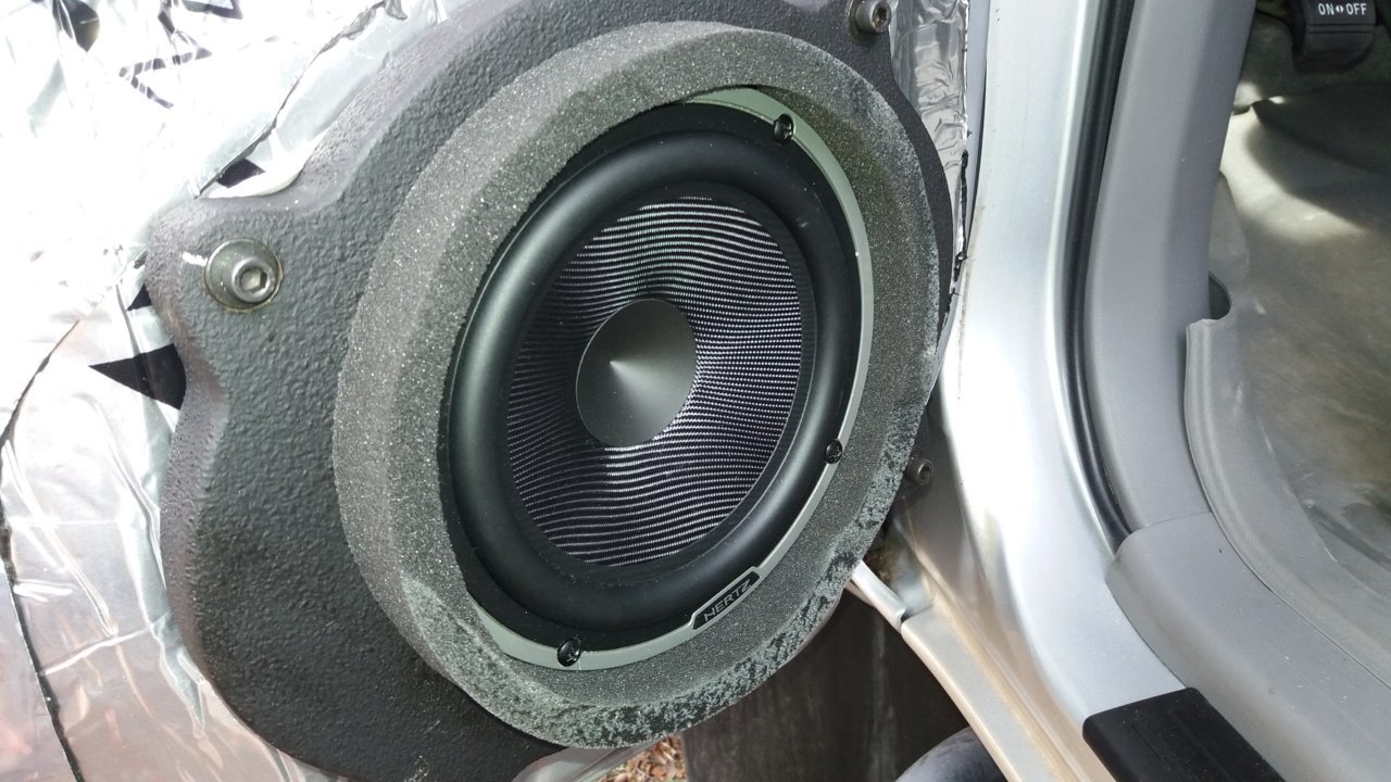

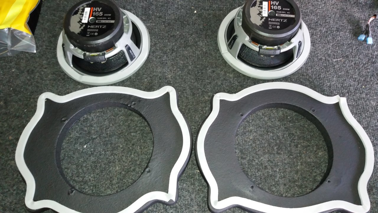

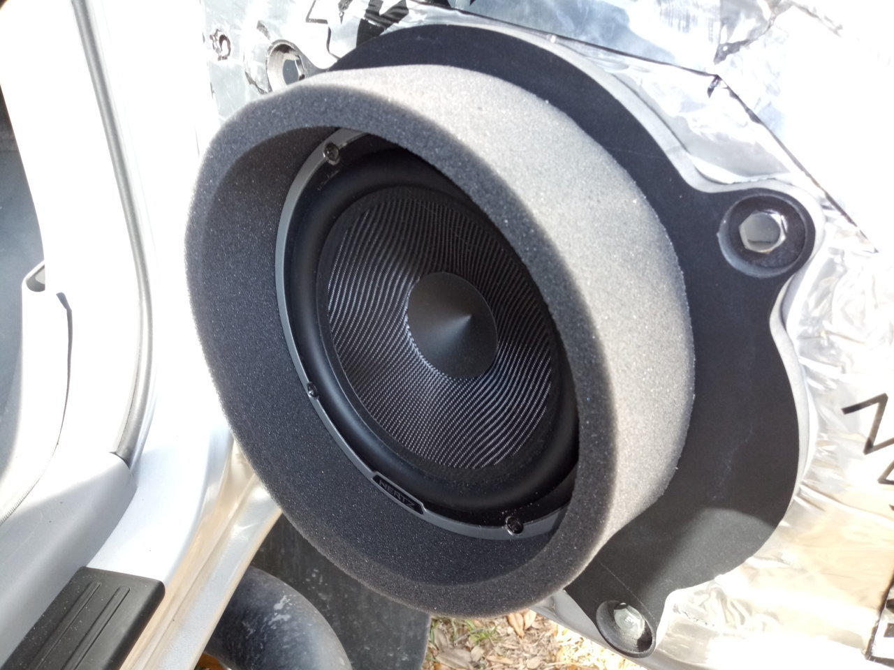

    Added new custom brackets for the 6.5 hertz,Added threads to the back of the brackets and fast foam rings.

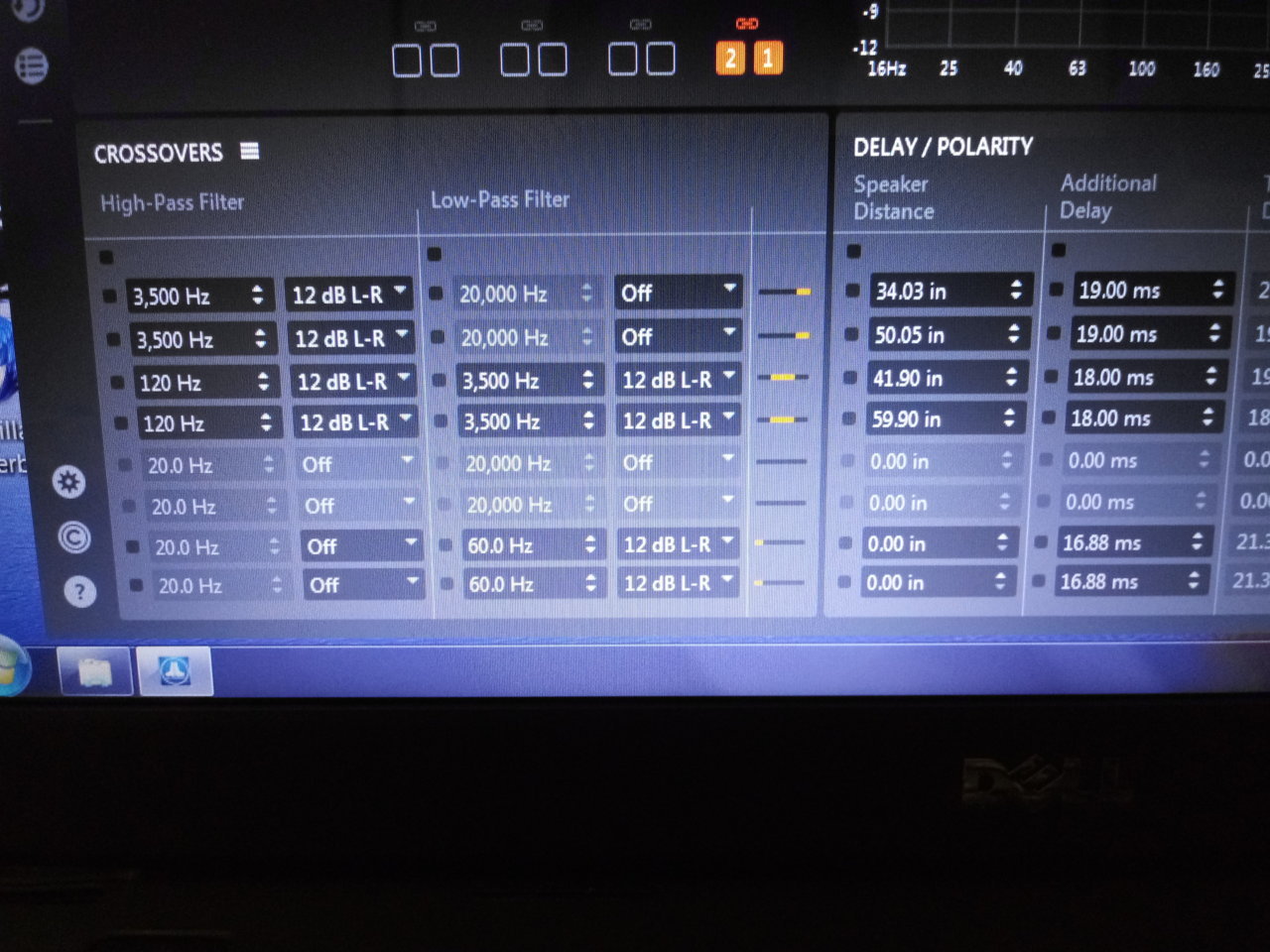

    Hello,
    I wanted to post a few pics of the settings on the twk88,I was wondering if anyone could help me with changing some numbers around to get a better SQ sound..I'm weak at tuning so any help would be much appreciated!
