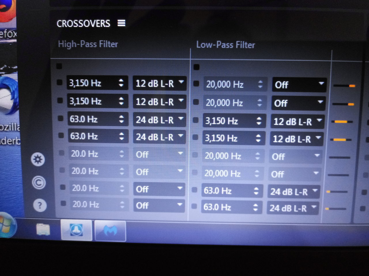

    just wanted to show what i copied.....thank u all so much!!!

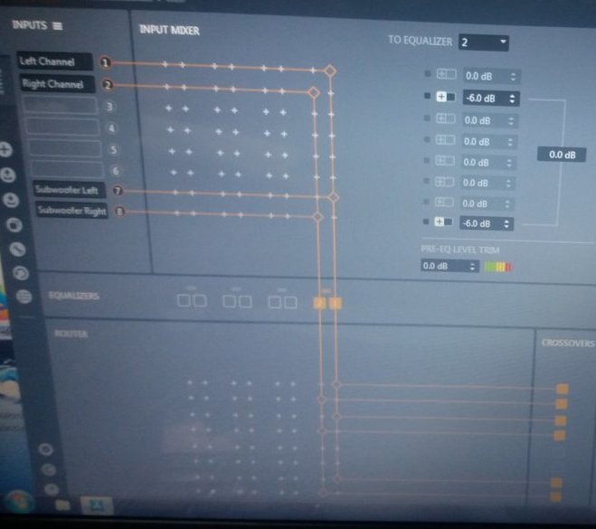

    Flatten that -6 on your input mixer too. Check all the "To Equalizer" gains and set them to 0. Odds are that was set that way because the input voltage wasn't set up. To set levels on your amps, set up a preset with no crossovers or EQ, but with the correct routing and save it. When you are done setting the amp voltages, restore your preset with all those settings and you're good to give it a listen.
    This TuN software is the actual bomb. I love it.

    i tried to set all to 0 "to equalizer" it said mixers attenuation sum cannot exceed 0 db.

    Are you summing front and rear inputs? Let me see your input routing...
    EDIT - Found it earlier in the thread.
    This is nopesauce. What you are doing here is a couple of things. First, you are combining the subwoofer channels with the front L/R in the input, but you already have full range input on L/R and a dedicated subwoofer input. Essentially you are inputting the low frequencies twice to each channel. You want to leave front and subwoofer inputs separated throughout the signal chain. The ability to combine inputs was designed for situations where your inputs are already band limited, and you want to recombine them into a full range signal for processing and setting different crossover points than what you have coming from the radio.
    The second thing you are getting here, is running everything through EQ channels 1 and 2, when you could be getting a separate EQ for High (1/2), Low (3/4), and Sub (7/8). Set it up like this so you get more EQ controls, but also it's ready for the future when you add the rear fill channels, because I know you will end up doing that.
    Don't forget to adjust your EQ bands accordingly. Tweeters are now on EQ 1/2 and woofers are now on 3/4. You can now have 10 bands for high, 10 bands for low, and 10 bands for sub (unnecessary). If you unlink the pairs, that gives you independent control over left and right as well.
    Once you get done doing all that put them Hertz Audio speakers back in. I’m still trying to figure out why you pulled them for Morels.

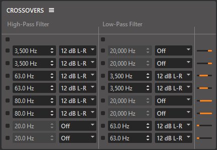

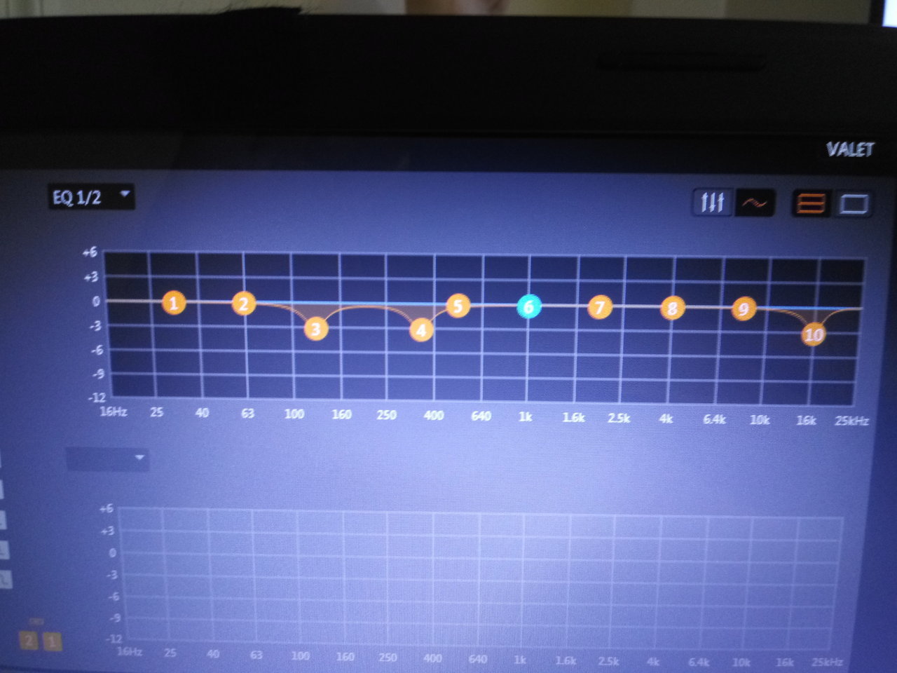

    Here's what I ended up with on my crossovers. I definitely feel like 3.5kHz tweeter high pass is better for my speakers, but his as well. I'm with you on 80Hz, but since his response is listed down to 60, I think the 12dB/Octave Linkweitz-Riley would make for a smoother transition to the sub channel without stressing the speaker. I think mine are rated to go to 45Hz or 50Hz which is why I chose 63Hz low pass for sub and high pass for the front doors.
    From what I've seen, our trucks like to resonate at and around 125Hz. In fact, I have a total shit show between 100Hz and 400Hz that I'm not sure what to do about. I'm sort of hoping Stinger Roadkill Fast Rings will alleviate the problem. It's worth a shot for $25. I definitely have a lot of KILL on my EQ in that area and I'm still not happy with it. It goes against all my experience to have to be so heavy handed with equalization.
    https://www.crutchfield.com/p_541FA...html?search=stinger_roadkill_rkfr6_fast_rings
    Other than that, I'm pretty bright in the 10kHz-16kHz range so I have a fair amount of tweeter kill in my EQ.
