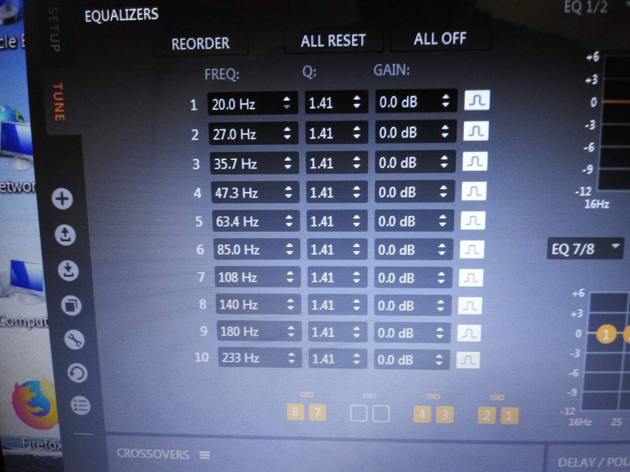

    C8D16DE3-413F-47AE-A1B9-7F7A55AFED38.jpg If you want more, just adjust the gain on the output to those channels.

    ok so just go 0 on all db?

    I would. Most I would do is a pull two eq points up a dB in the frequencies you want. One around 45 and another around 65HZ. That’s it.

    Thanks!!! i'm listening to a cd i like...i took out all the db and set them to 0 and left t Q at 1.41.

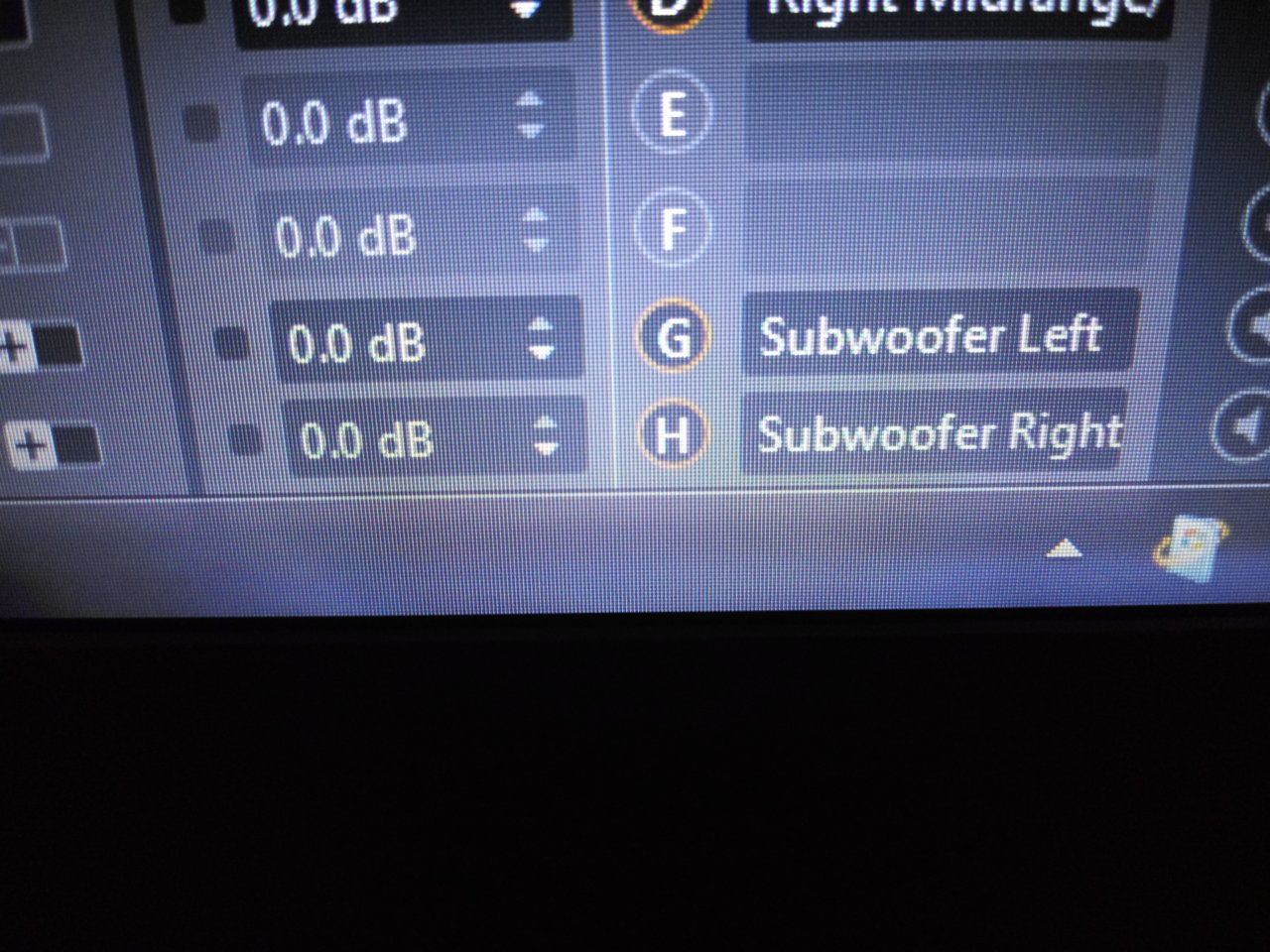

    You can turn the gain up that you show at zero in your last picture.
    Also, if you have a knob for the sub on the DRC make sure it’s turned up

    Ok! was that the one that just said subwoofer left and right? Inputs G and H?

    Yep that’s them. Link them together by clicking the two boxes next to them, then turn the gain up.

    Ok!! Thank you!!! Ill go up +2 or 3db

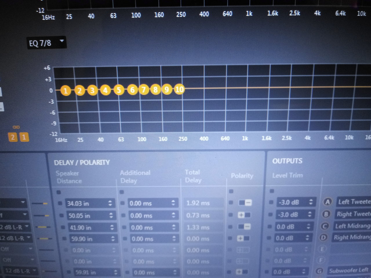

    I set my sub gain to 10db’s then I use the DRC to adjust according to what I’m listening to.

    Hmm let me look on my twk now..I seen the gains for db but it was letting me only go -

    It might be different. I have the digital processor as part of my amp and that may have different capabilities?

    true!!!!! looks like i can only do that on the tweeters.can i boost any on the equalizer gains?they are all set to 0.0db
