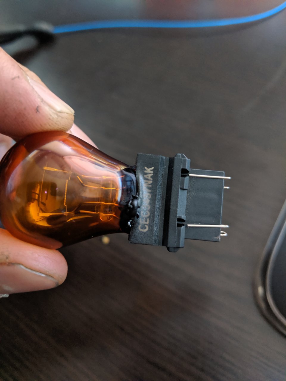

    I finally found the problem. This is the driver side blinker and DLR. The weird part is the bulb still worked as the blinker and the DLR. Even when the fuse would blow this bulb was still working. Doesn't make any sense to me but I got it fixed. Thanks for the help.

    Yea i was gonna say some bulb in front headlights. I had aftermarket ones and halo short circuited. Finally just unplugged both halo lights. Couldn't find where short was.

    you said you unplugged the headlights and didn’t find the problem then. How did you know to go back and check that bulb? I’m currently having the same issue as you did

    I unplugged just the headlight bulbs them selves and after that didn't work I unplugged every thing that went to the headlights and that's how I found it. I pretty much when for the shotgun approach and checked everything I could possibly think of. Somebody posted the Illumination circuits and I just started checking things off one at a time.
