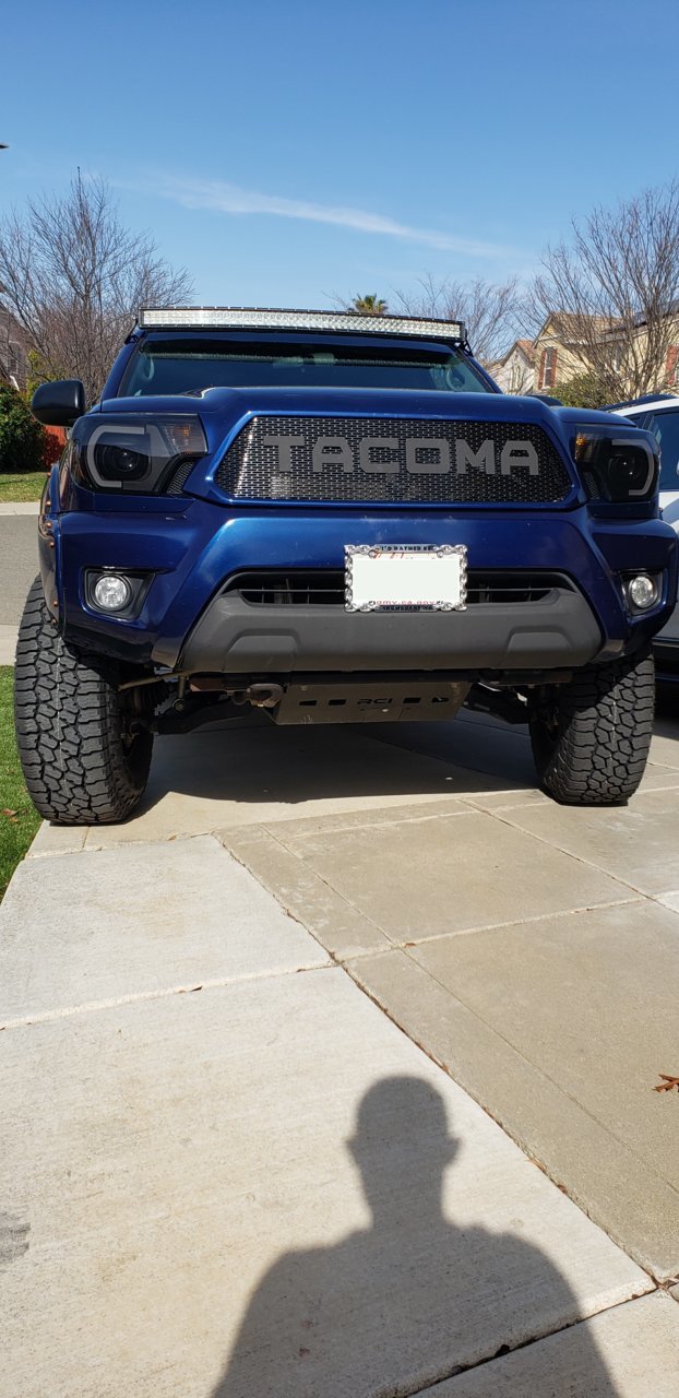

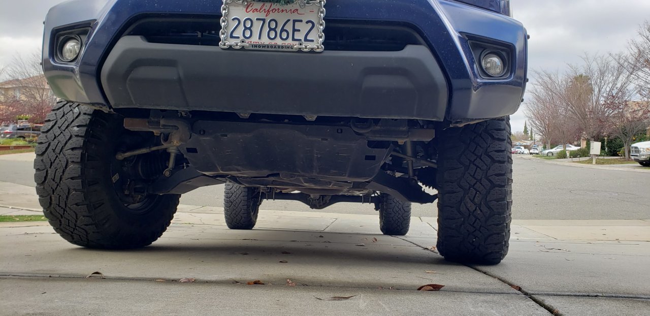

    Installed LCA skids from RCI. Had to cut the factory front a little to make them fit. Still trying to figure out who I want to buy the ifs and transfer case skids from.

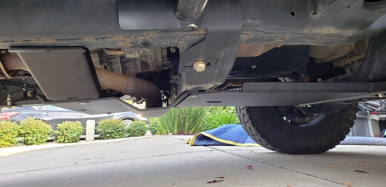

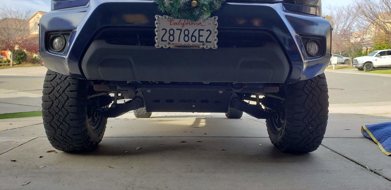

    Installed RCI skids today! Got the Front Skid, transmission, and t-case skids.

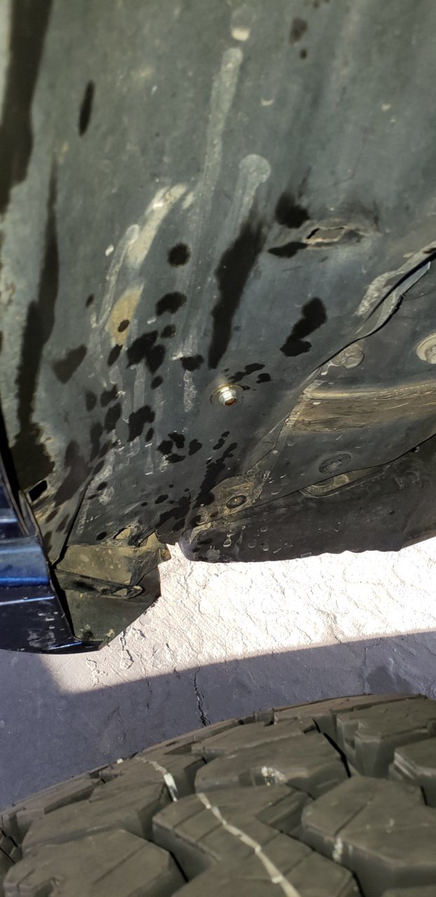

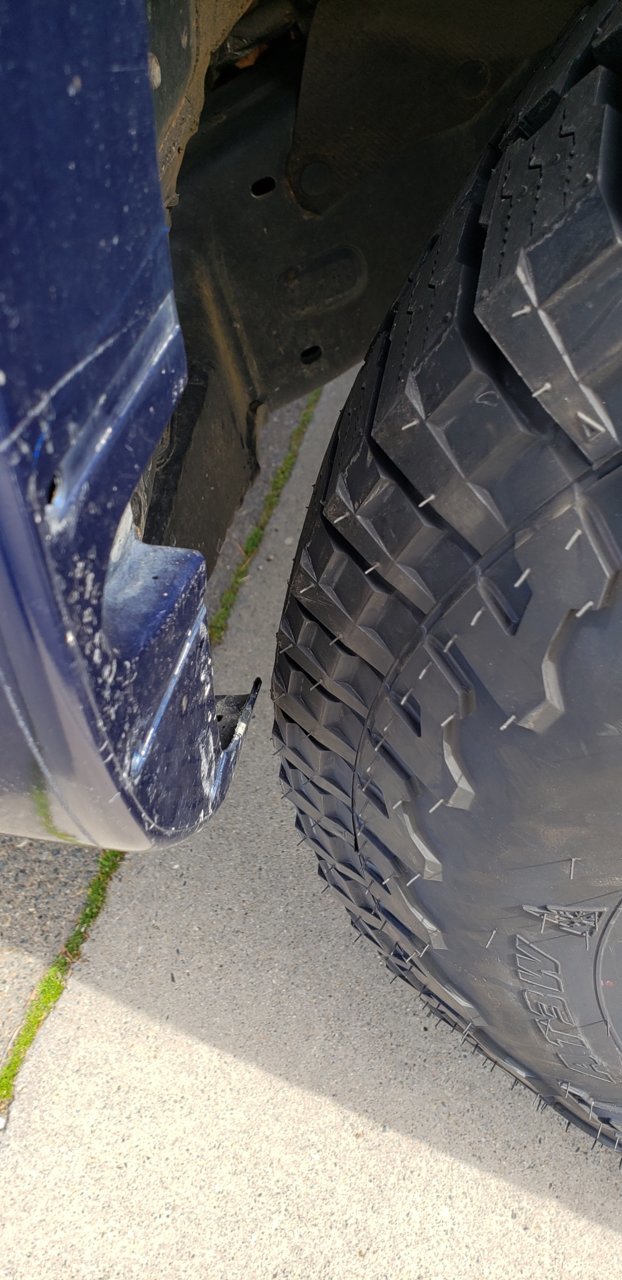

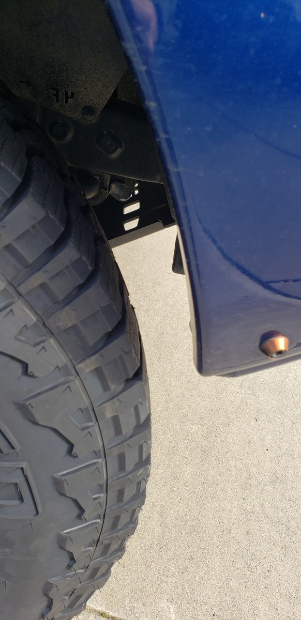

    I got everything ready before putting on the 33s so I dont know if they would have rubbed without me doing anything. I did a cab mount chop so that it would be flush with the firewall and folded the pinch weld flush with the firewall before I put the 33s on. Cut off the bottom corner of the wheel well liner and screwed it to the pinch weld. Also had to trim the bottom corner of the fender to give the tires more space.
    DRIVER SIDE in front of the tire:
    DRIVER SIDE behind the tire
    PASSENGER SIDE in front of the tire
    PASSENGER SIDE behind the tire
    CMC + trimmed the wheel well liner and the fender.
    Driver side
    Passenger side
    Picture of the folded pinch weld and how I cut the cab mount.

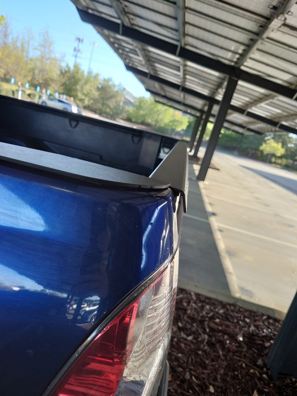

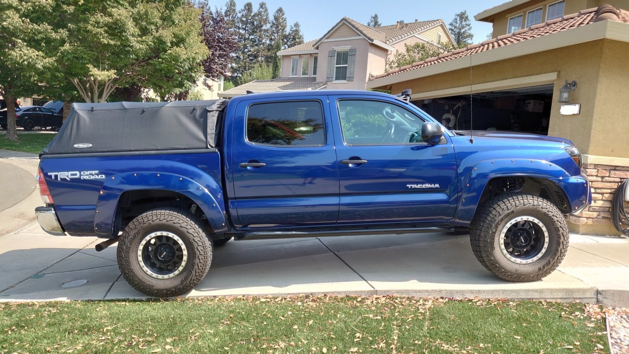

    Got tired of using a bed net so went ahead and got a softopper. Incredibly happy with it. Very easy to store and makes it easy to fit more stuff in the bed for camping trips.
  11. Jan 28, 2022 at 9:40 AM
    #31
    the_bluetaco
    the_bluetaco [OP] Well-Known Member
    Dec 2, 2016
    #203860
    321
    Artem
    California
    2014 TRD Off Road DCSB
    Method Racing Wheels-Double Standards 16x8 Falken Wildpeak AT3W -285/75R16 FRONT: Bilstein 6112, TOTAL CHAOS FABRICATION UCAs REAR: Bilstein 5160, OME DAKAR leaf spring set

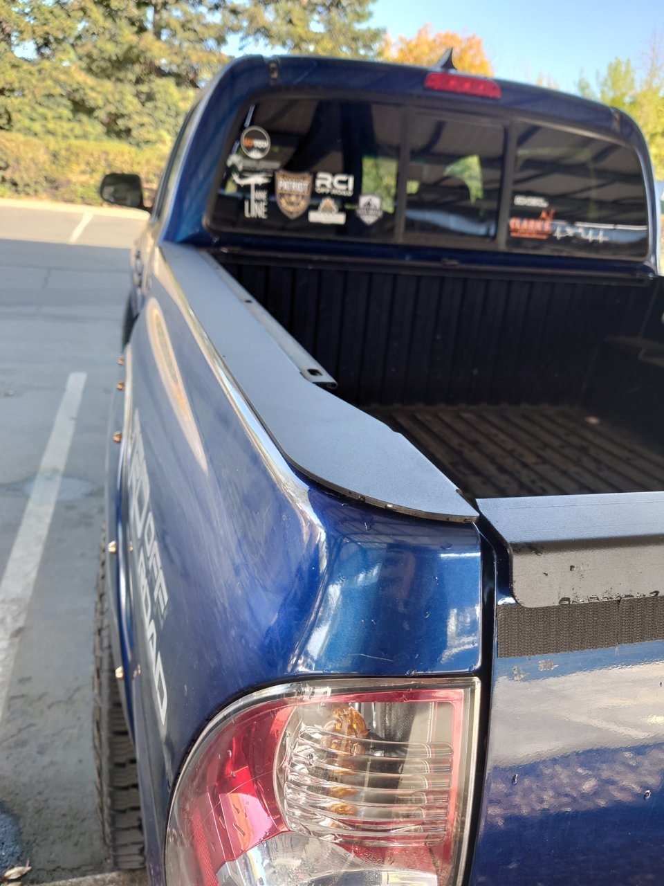

    Had some issues where the softopper brackets were sliding inward, maybe i had them too tight, maybe it was because the plastic bed caps were moving around. Anyways I ordered aluminum bed caps from KB Voodoo.

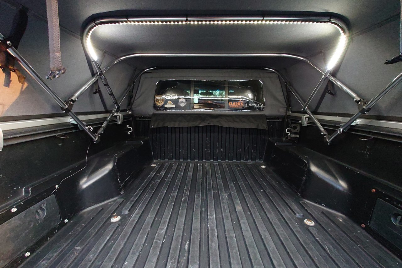

    Installed some lighting inside the softopper. Got a waterproof LED strip off Amazon, Mictuning is the brand. I extended the wire for the battery connection, ran the wire along the existing wire harness that's for the tail lights, and connected it to my external fuse block. The connection and button I can keep in the little cubby in the bed when I have the softopper removed.
