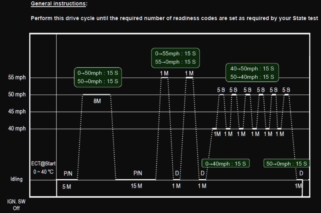

    Here's the EPA drive cycle that sets the Readiness Codes. It is the fastest way, other than just driving.

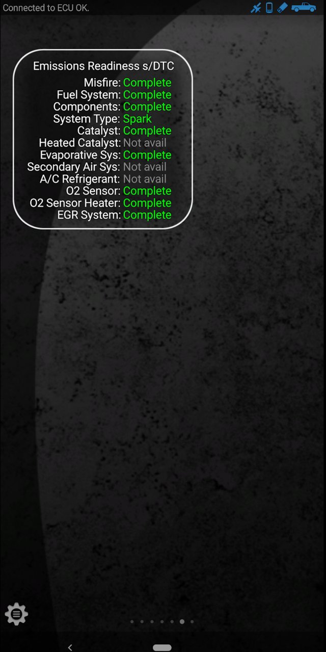

    If you want more info, get a cheap OBD adapter like this:
    https://www.amazon.com/Veepeak-Bluetooth-Diagnostic-Supports-DashCommand/dp/B011NSX27A
    From there you can monitor your Taco for testing. If you get everything shown as Complete and green, the you're ready to test. If you're in good shape, do not shut the Taco off while waiting in the line at the test station! :D

    Getting monitors is actually easy. Cold starts let idle for 20 minutes, go drive 40+ for a few minutes (stop lights/signs are ok) then hit highway for about 20 minutes at 60+. That will set all but evap monitor unless your fuel level hit evap cycle request during the drive.
