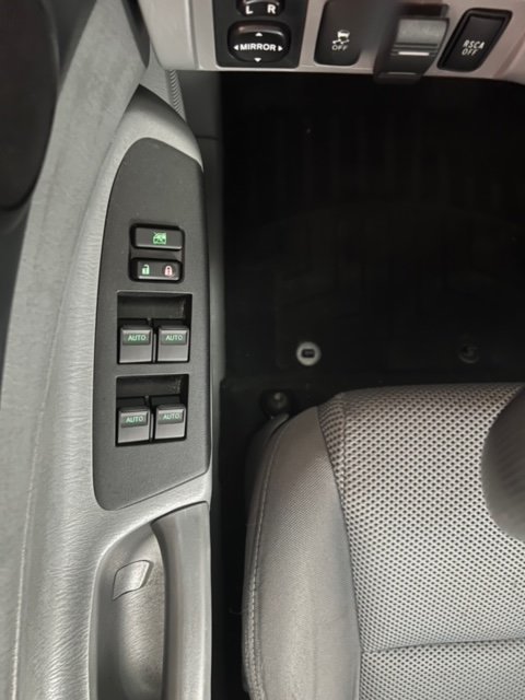

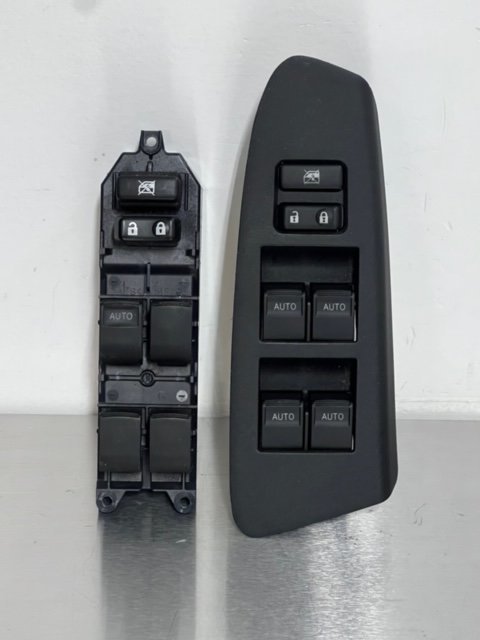

    These are available for the 2012-2015 double cab (four door), it comes with switches for both front doors. They are aftermarket and I can't speak for long term quality, but they are working well for me and others here have said the same. Note - I had an LED go out on the passenger door switch and they were responsive and replaced it quickly with no hassle.
    This gives me:
    Auto up/down for all four window from the driver's seat
    Auto up/down for the front passenger from their seat
    No change for rear passenger switches - no auto up/down from the rear passenger seats
    I have had mine for 18 months and like the subtle change. Plug n play, no cutting or wire modification necessary, perfect fit, easily reversable to go back to stock.
    LINK:
    https://cartrimhome.com/Door-Switch-For-Toyota-Tacoma-2012-2015
    (Stock on the left)
