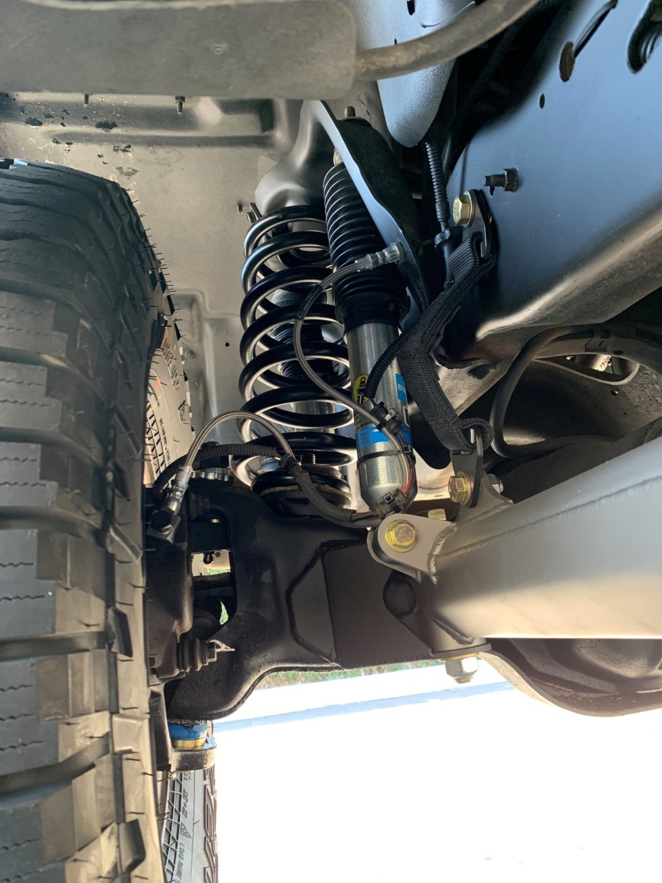

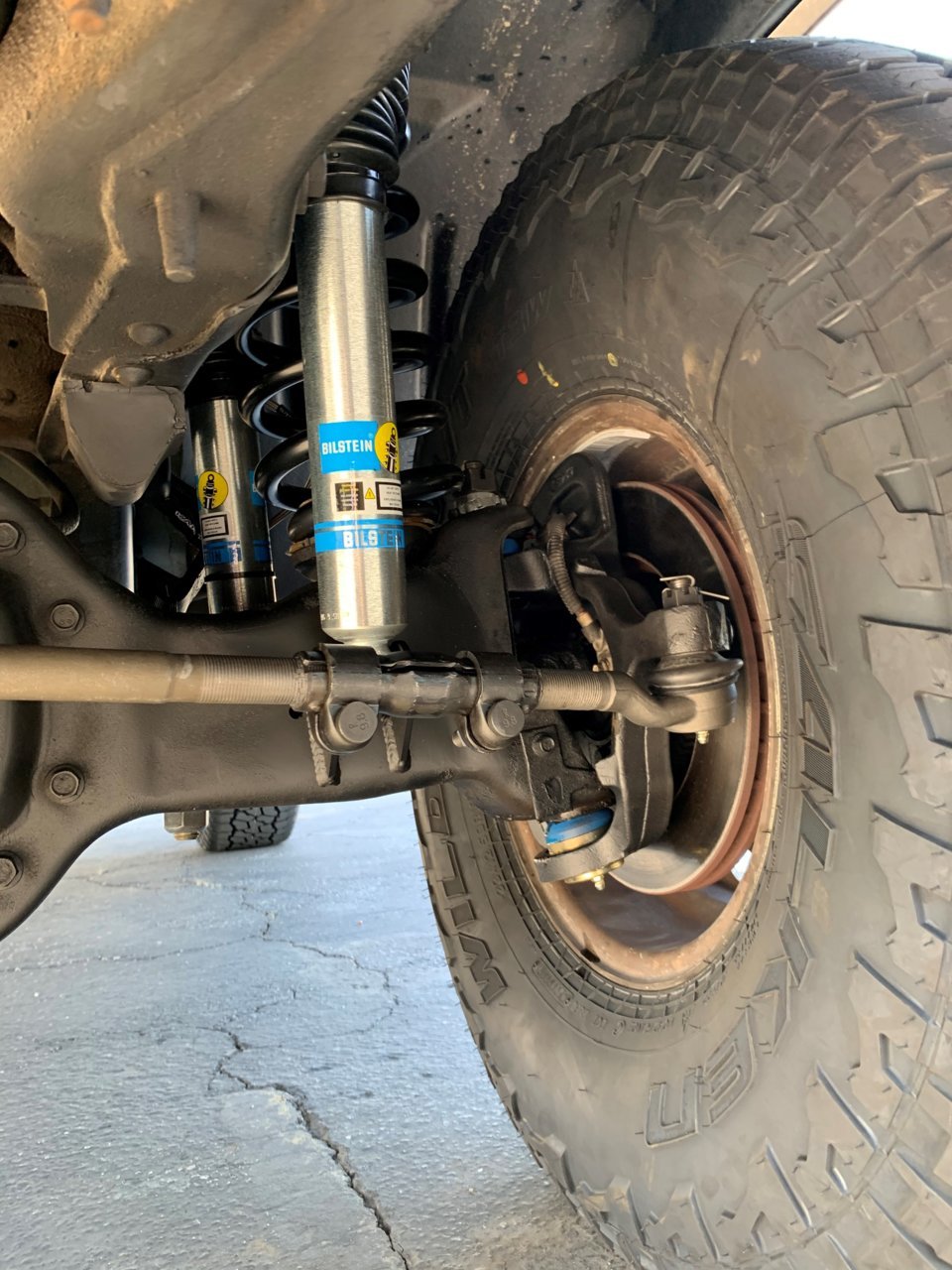

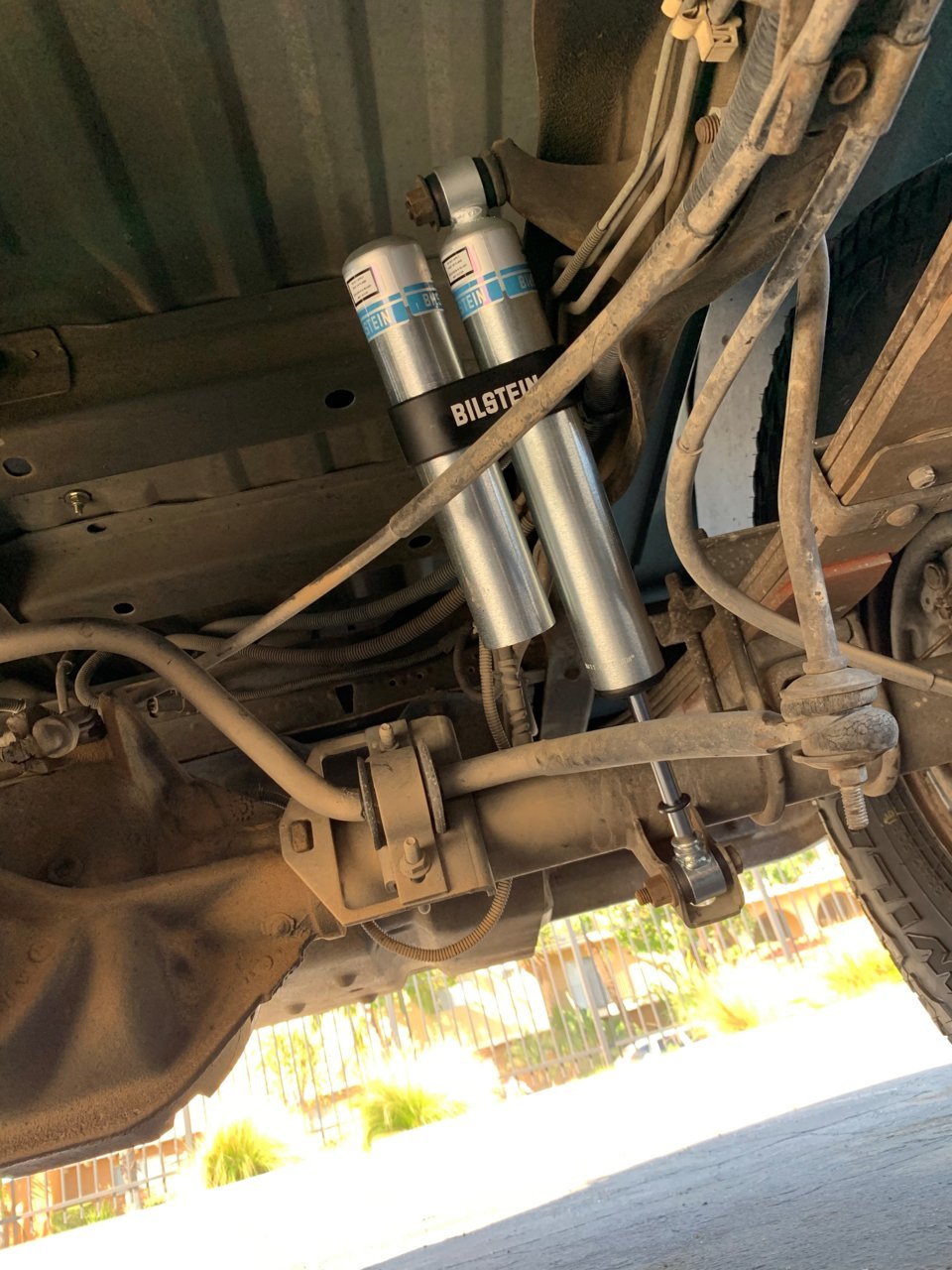

    Guys, i'm in love...

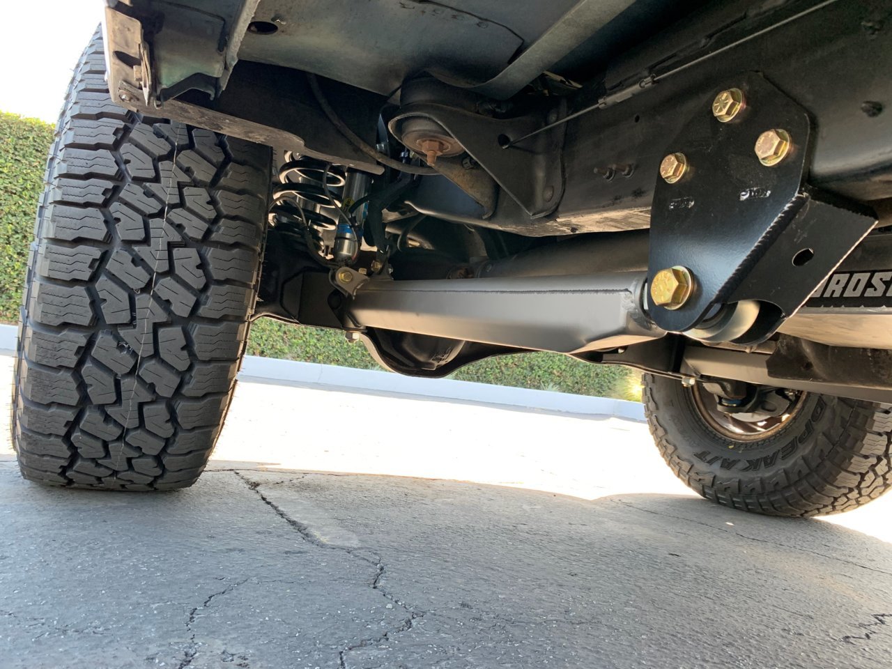

    The crew at Desolate did their thing, installed all new Napa Blue ball joints, heavy duty upgraded steering, and their Stage 1.5 kit with dual 5100's up front, and 5165's in the rear.
    While they had the front end apart cleaning, painting, and installing, Greg noticed my front brake pads were pretty worn, so he resurfaced my rotors and slapped on new pads at just the cost of pads. That's some serious above and beyond attention to detail and customer service i really appreciate. Can't wait to take it out and enjoy it.

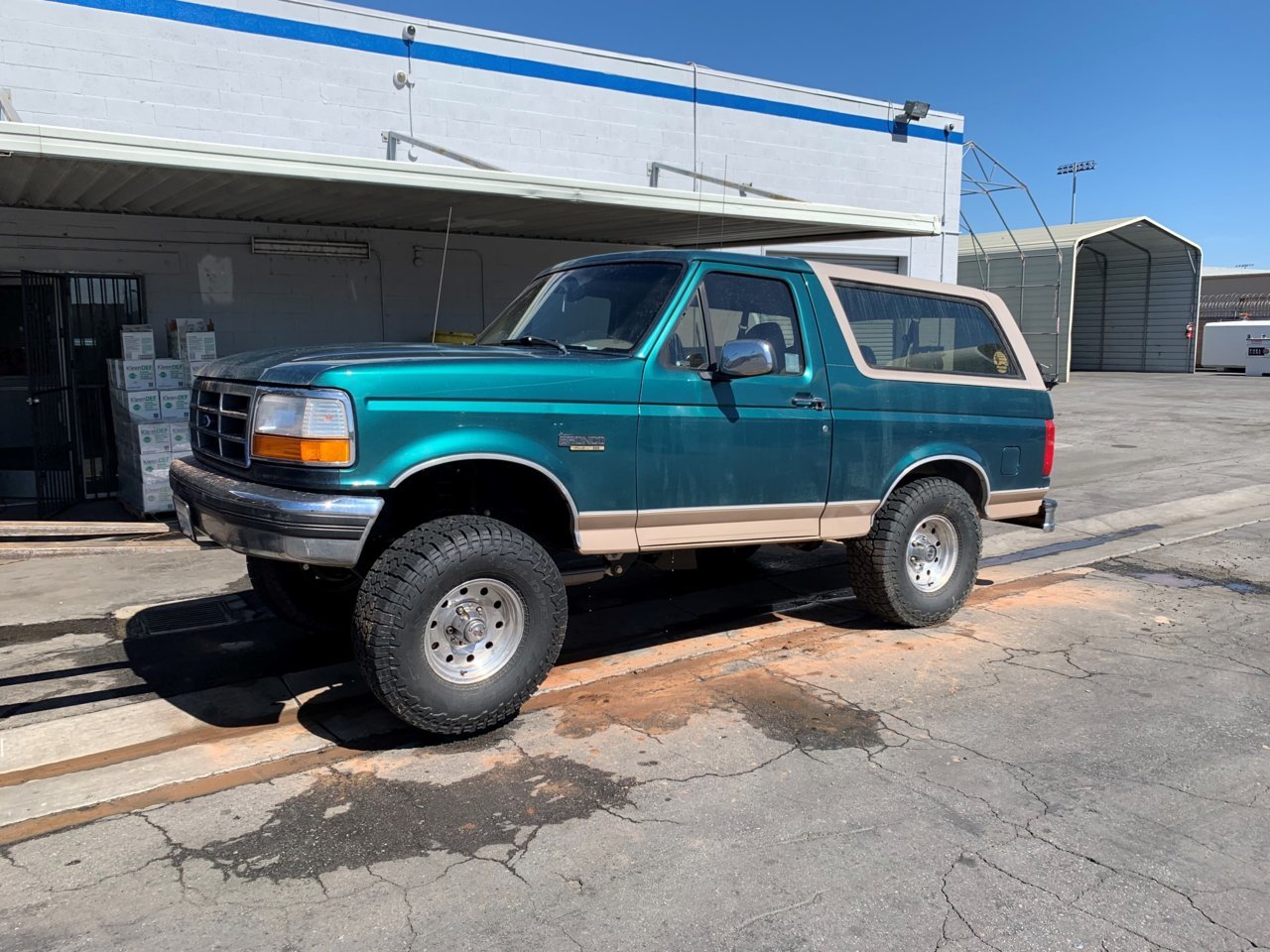

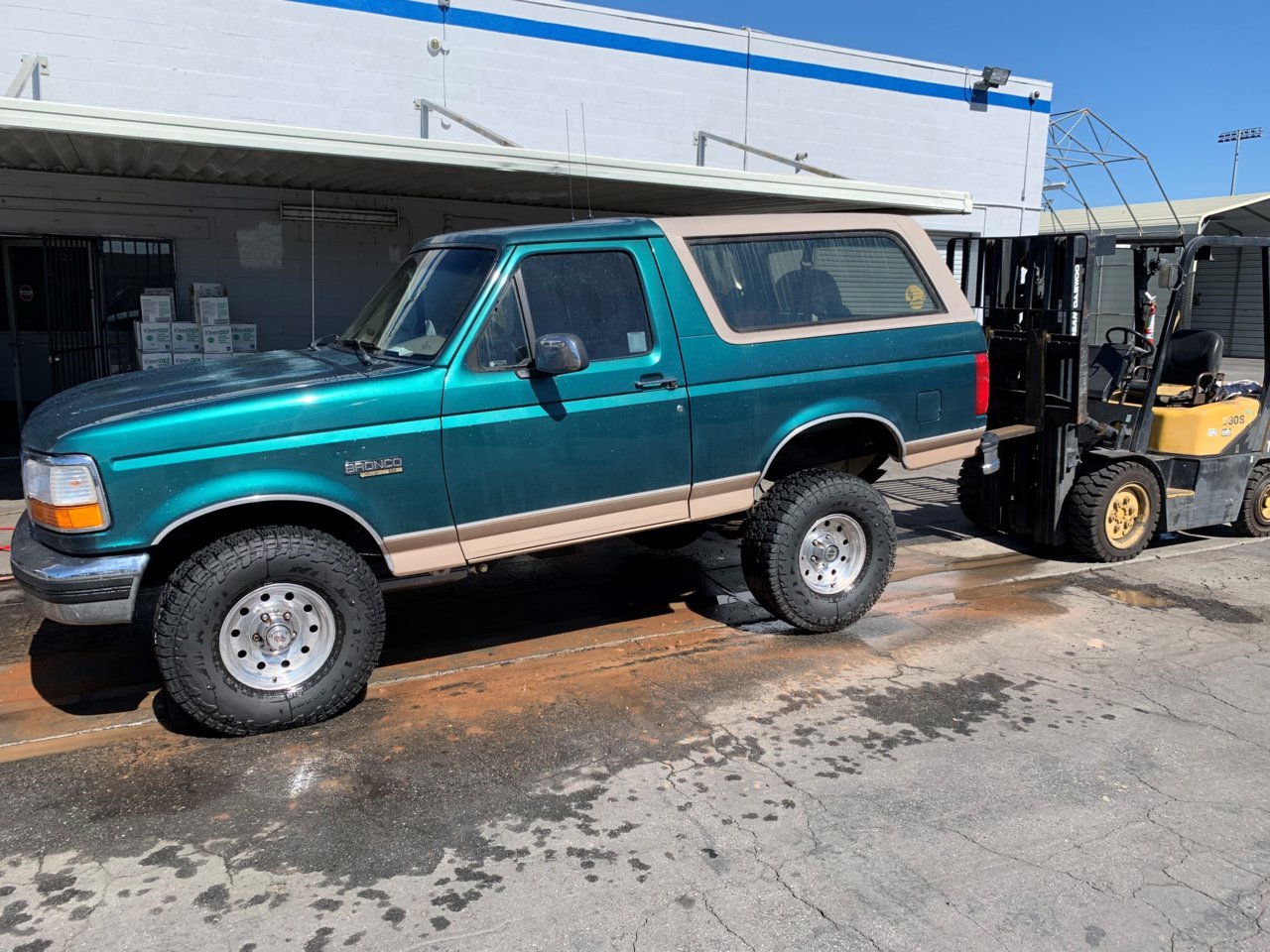

    Current as of today...

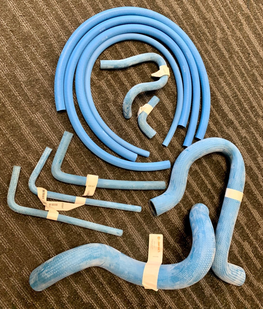

    Bronco is at Johnny Lightning's in Corona CA, should be done this afternoon. They'll replace the upper and lower rad hoses, since the upper has some nicks in it from the fan, and the lower as seen better days. Steve over there already knew to zip tie the upper to the radiator. Also replacing the heater hoses while the system is more of less drained just for piece of mind, and any others that they can easily knock out.
    They also said they'd just go through it and call me if anything else needed attention. I'm sure i'll hear about the oil pan lol. Hopefully the rest checks out more or less fine.

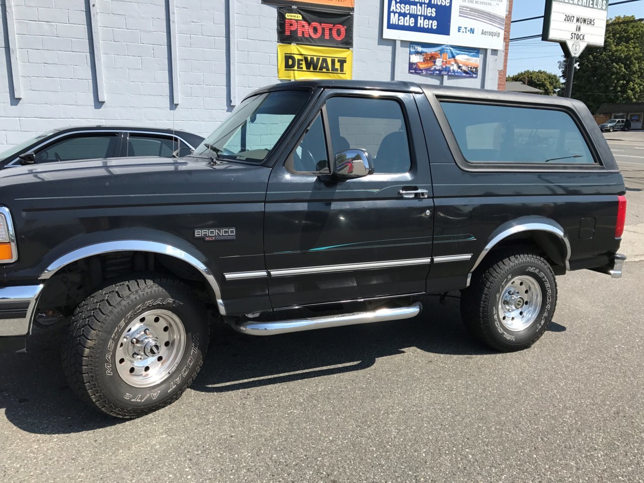

    Damn,
    Gorgeous Bronco! I regret selling my 1997 every damn day..
    GL with build, looking forward to more updates :jellydance:

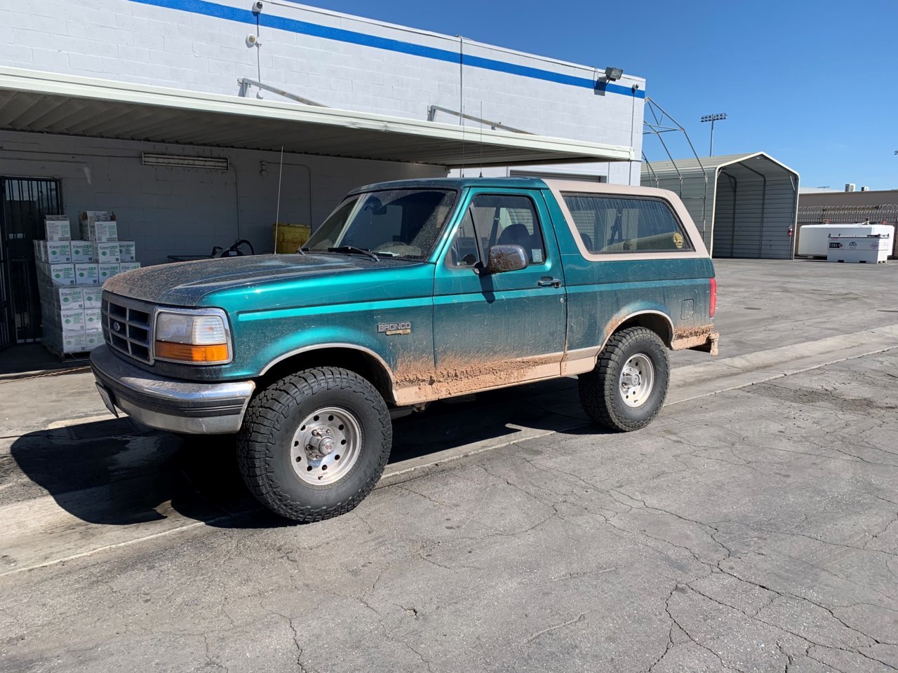

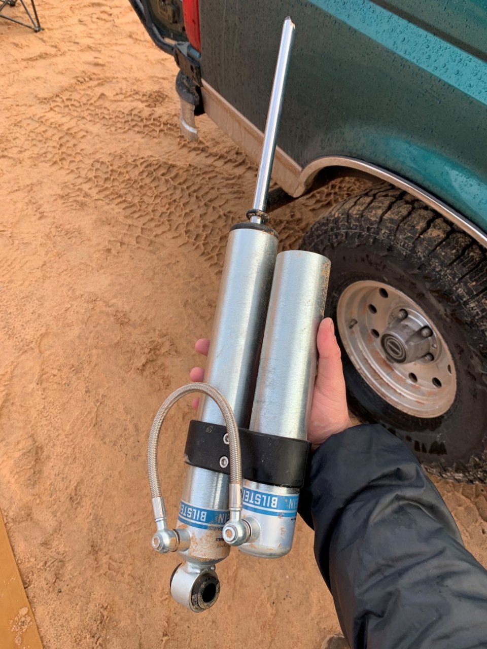

    5 day trip through 4 Corners, Monument Valley, Horseshoe Bend, Pink Coral Sand Dunes, and Zion. Broke a rear shock, no idea how really, and found out my auto hubs chose a bad time to fail.
    Spent over an hour with the pressure washer, ran it through a tank and a half of fuel, lol.

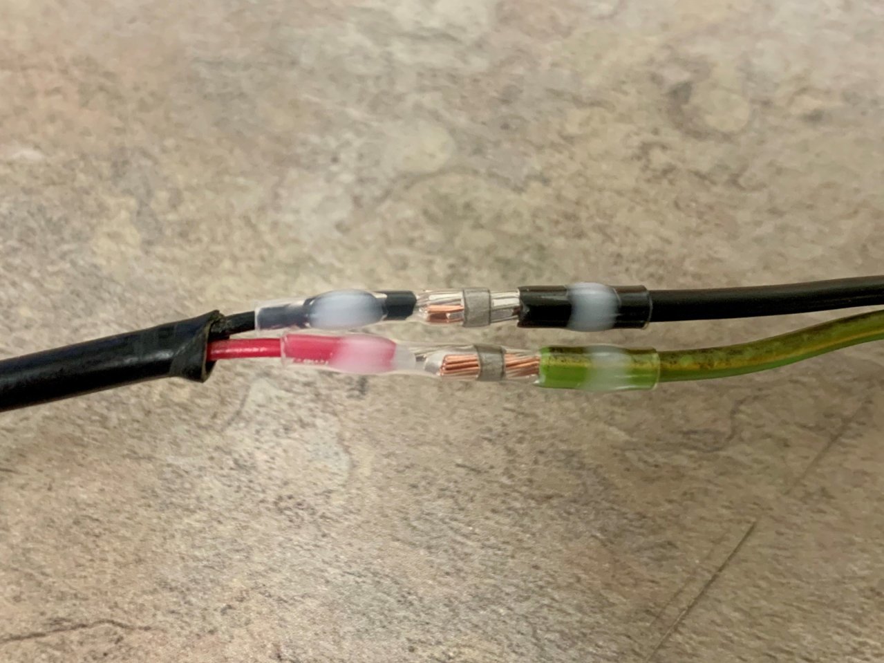

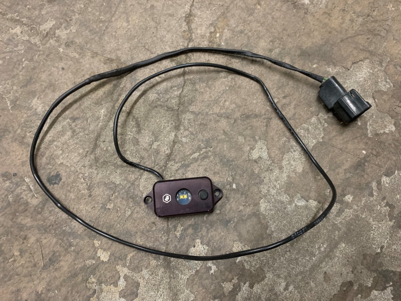

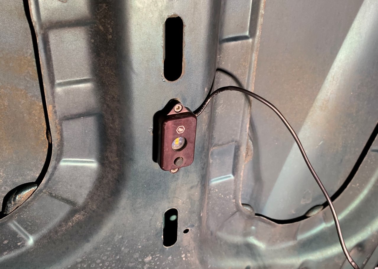

    Small project yesterday, while i work up the motivation to tear the interior back apart...
    The factory underhood light leaves a lot to be desired, and i had a Baja Designs dome light sitting around from my Tacoma that i sold. Thought it would be a perfect replacement. Since the factory wiring is constant hot, the dome light having a built in switch works out perfectly.
    Funny that nubreed posted his version with a KC light recently as well, but he ran his wiring much more nicely than i did lol.
    Factory pigtail removed.
    Cut off the factory plug and spliced it into my BD Dome light pigtail.
    New light and harness, w/factory connection
    Mounted using the included BD hardware, and a pair of nutserts. Used one of the factory holes, drilled the second one. Easy install.
