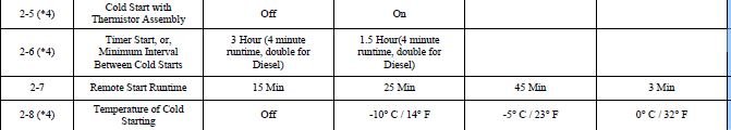

    There is a feature where if the air temperature drops below a preset temperature, it self starts and runs for a programmed number of minutes and then shuts down.
    Also, just for information in the future, if it's running by remote start or self start, stepping on the brakes will shut it off.

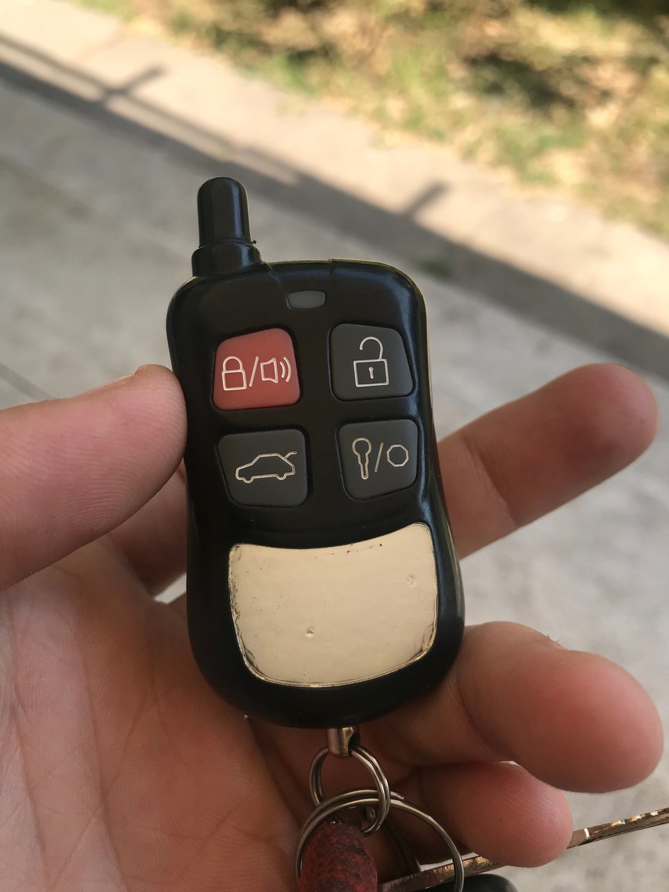

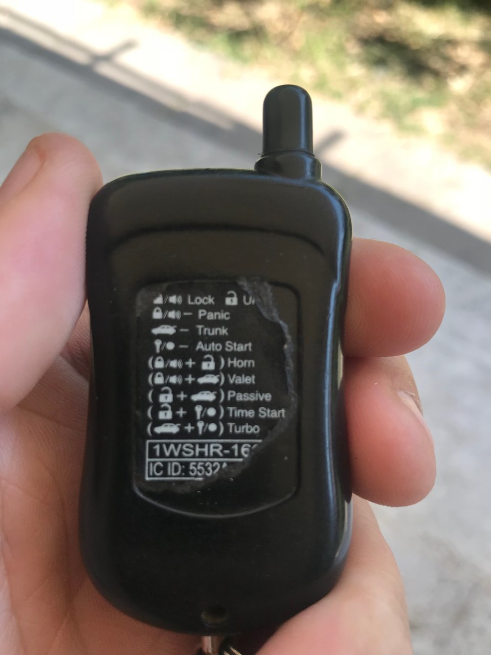

    This was exactly why I was shocked as well. As you have read right now, I purchased the car a few days before and didn't know it had a autostart. Also the keys where in my pocket (not near my girlfriend) and I was still in bed. So nobody triggered the autostart. I must be on the same frequency as someone else or something else must have triggered it. I don't know what it is. The good thing now is that I have a autostart and I already used it ;-).

    When you said you can't figure out the autostart
    I believe the answer lies in the picture you posted here:
    Where it says the key / octagon symbol = Auto start
    You may either have to hold that button for a number of seconds, or press it a certain amount of times 1-2-3-4etc...
    I would also assume in the bottom of that picture is the "model number" of remote 1WSHR-16??? you maybe be able to look up the user manual online.
